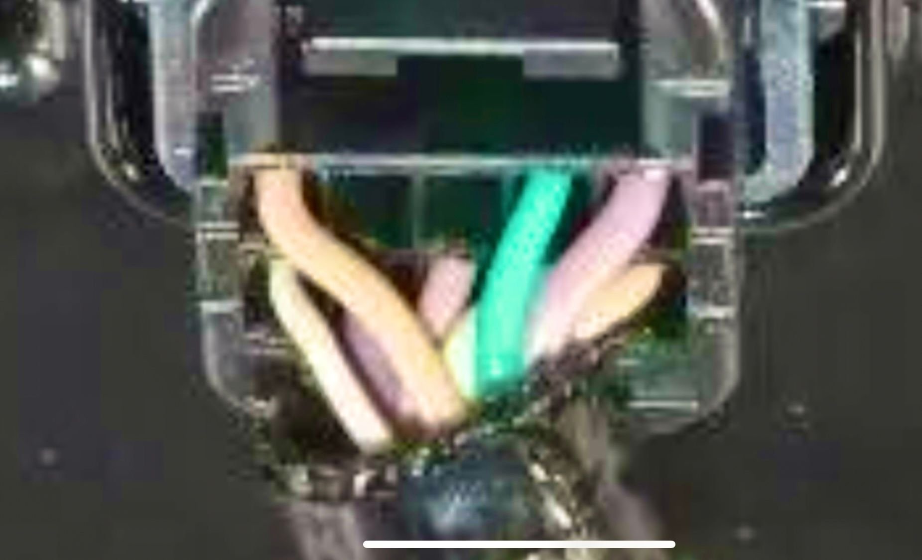

Hey, specONE- your video inspired me to perform an entire RC Center Console swap into my IS! Do you still have the pinout diagram for the RC Touchpad side? I ordered harnesses from Alipay to adapt the plugs, now just need your wiring help to make it complete! I cross-posted this on YouTube too. Thanks in advance!

So how do I match this up? Can’t seem to read the diagram in a way that matches my wiring…

Ooooh ok. I’ll take another look at it later tonight then- I’m on my way to work right now. It’s too bad there’s not someone with an early RC that can get us a pic of their plug so we can compare! It IS illuminated, yes.

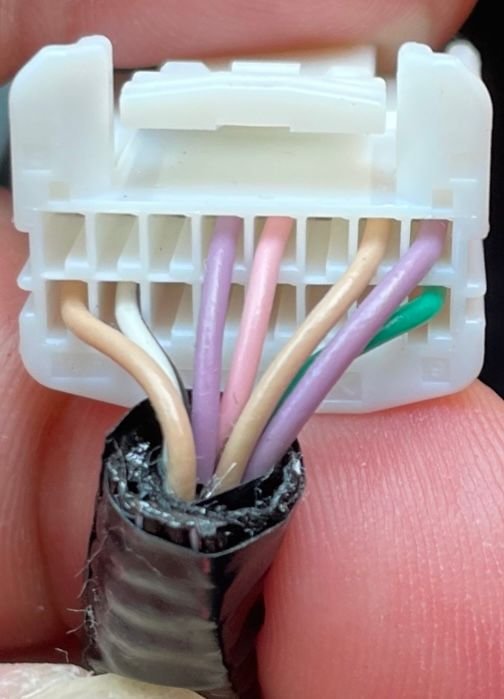

Found a pic of an RC-side plug, so this helps, just need the other half of my harness adapter to make it work.

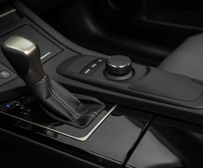

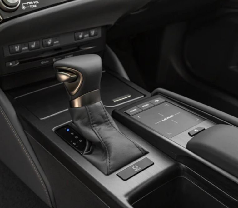

Default Can I swap out the Touchpad?
Hi specONE…you seem to be quite knowledgeable and experienced in this area, so I’m hoping you can help me 🙏🏻
I just got a 2019 ES350 which has the touchpad and I love EVERYTHING about the car EXCEPT the touchpad! 🤪👇🏻
In a car, I REALLY prefer a rotary ****/puck style control, which I noticed was present in the 2018 ES (missed it by ONE year 🤦&#127995.👇🏻
What are the odds I could swap them out if I found the ****/puck for sale somewhere? Or even just ADD the ****/puck in addition to the touchpad (don’t need both cup holders so I’d be willing to sacrifice that space in the center console for a rotary **** controller)?
Thanks in advance for any thoughts, advice, resources. Sorry if I’m “barking up the wrong tree” …I’m new to online forums, but I’ve dreamed of owning a Lexus since I was 9 years old and now that it’s finally happened, I want to learn everything I can 😆
Old Jan 20, 2023 | 07:42 AM
specONE's Avatar
specONE
Joined: Jan 2008
Posts: 2,002
Likes: 533
From: SF, California
You cant interchange the two. For Lexus vehicles, The **** means non-navigation equipped Stereo system. The touchpad is for Navigation equipped Lexus Vehicles.
