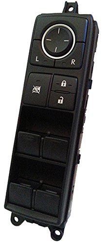

Sure! My car is 2015 is200t, made in Japan, right hand drive, not F-sport, just normal version. I just have manual mirror folding before
Manual mirror folding button

In America we do not have that button, so also mean we do not have motor inside the mirror to fold like you do

Oh! It is totally unexpected! Because in Asia, like Hong Kong(RHD), Japan(RHD), Tai Wan(LHD), Mainland China(LHD)......Has the manual folding function like me, even just the basic version. And in higher version, they have Door Lock Auto Folding Function, the [AUTO] button in photo
