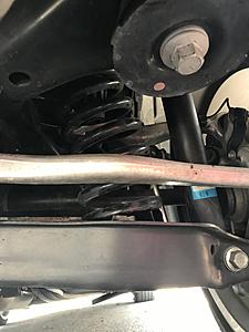

New guy here with a problem after accident. Got the car back and it's a drag car now for some odd reason. It seems like 3 inches higher. What can be the problem? The damage was to the rear and they replaced and fixed a lot. And the springs has a slight bend. Is that normal?

Something I would make sure the spring is seated properly like what Sasnuke mentioned.
Another thing, Maybe the rear swap bar is out of place or bent fromt accident? causing it to to do that?

Yep, they are both bent. I'm assuming they are not suppoed to like that. Can you guys verify this?

the springs are suppose to be slightly bent when it is seated in the spring pocket area due to the way the suspension swings at a angle. That is not the problem.
it is where the spring seats on both ends that will cause the height to change.

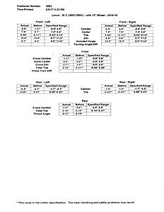

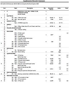

Attached is the work order(3 pgs) and alignment sheet.

Before looking at all the attachments, the first obvious thing is the alignment specs used were for an IS convertible from 2010 to 2015...so that's a completely different vehicle than yours. Oh, and not to mention the alignment specs are effed anyways just based on the Actual measurements.
Will continue reading...

Under Rear Suspension on the first page of repairs it says "crossmember to 05/2013" I take that to mean they installed a crossmember that fits an IS manufacturered up to 05/2013...unfortunately that would be a 2IS or IS Convertible...and not your vehicle at all. I suspect you have a 2IS rear crossmember currently installed in your vehicle.
This would explain why your vehicle looks the way it does.
On the second page of the estimate, I would question them as to what the "knee" is under Recycled Assemblies.
