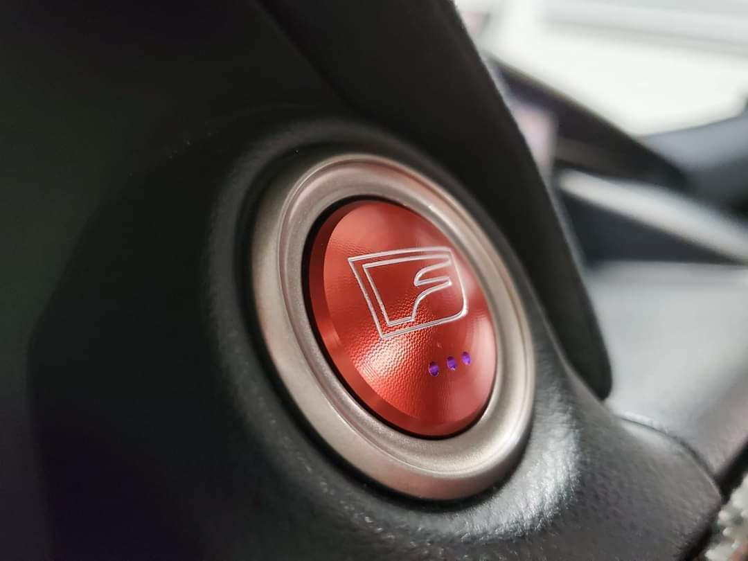

I ordered another push button. This one is billet aluminum. Looks really nice. See pictures below (not mine, don't have it yet). I should get the button hopefully next week. I'll update once it comes in. Machined out of aluminum, and then has the F logo. Three small holes at the bottom to let light through. I'm on the fence if I like that. Ideally I'd love for the button to light up but this might be fine in all reality. I will play around with which one I like. Either the Meso custom's that lights up pictured in previous posts or this billet one.
I think the touch and feel of the metal button will be super nice. Plus I was assured that this button is identical in spec to the Lexus button and it's not recessed in anyway. As you can see in the picture it looks to be true. One thing nice about the three small holes to let the light through is when I desolder the bluish ones from the factory and use white, it will probably look really good, just with three white dots of light. You could change out the LEDS to any color. I have blue, green, yellow, pink, orange, red, white, warm white, UV..etc. I'm going to play around with it and see what looks the coolest.
To my knowledge there isn't any other metal buttons available. I believe on FB they are trying to get other designs and colors possible but it depends entirely on the community and what they'd want. The push button is around $50.

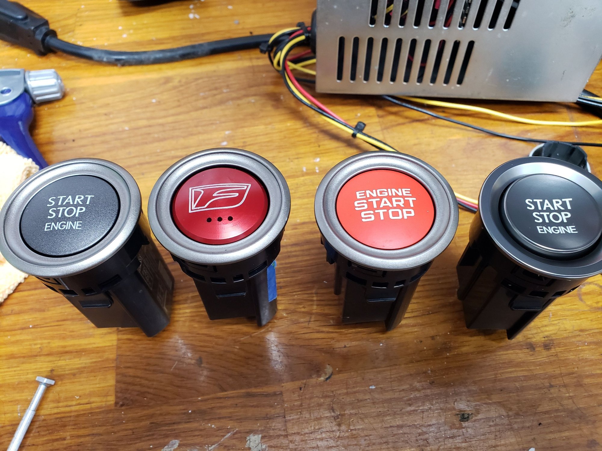

Update on what all buttons look like. My aluminum isn't right because apparently something changed with Lexus. in the later years, so my button is very recessed, more so than the cheap Chinese button i had that isn't pictured. Working with manufacture to see if they can revise it for later years.
From left to right:
OEM push button on left, Aluminum F Button, MESOcustoms button, OEM lc500
-Nigel

I still very much like the meso button. It added just a little bit of color in the dash. The only annoying part which is NOT the fault of the switch cover is that Lexus uses blueish leds. So since all aftermarket buttons or housings are either translucent or clear is that the blueish light shines through the button and if you are ocd like me then you have a blueish tinted button instead of the natural lexus white led light. Lexus push switches have a filter in the plastic that filters out the blue light and makes it white. If you hold a flashlight onto the OEM Lexus cap it's actually yellow light. But the blue LEDs get filtered from the yellow of the back of the switch thus making white light.
Everyone I brought into my RCF and showed them all the buttons, they all unanimously said they liked the LC500 button. Just looks nice. It's still 100% platic button. I don't know why I keep reading people stating it's metail, it most definitely is not metal at all nor is the trim ring. But it's a nice looking button. You can get them on ebay for around $140 which is fair. Paying dealer prices of over $250+ is ridic.

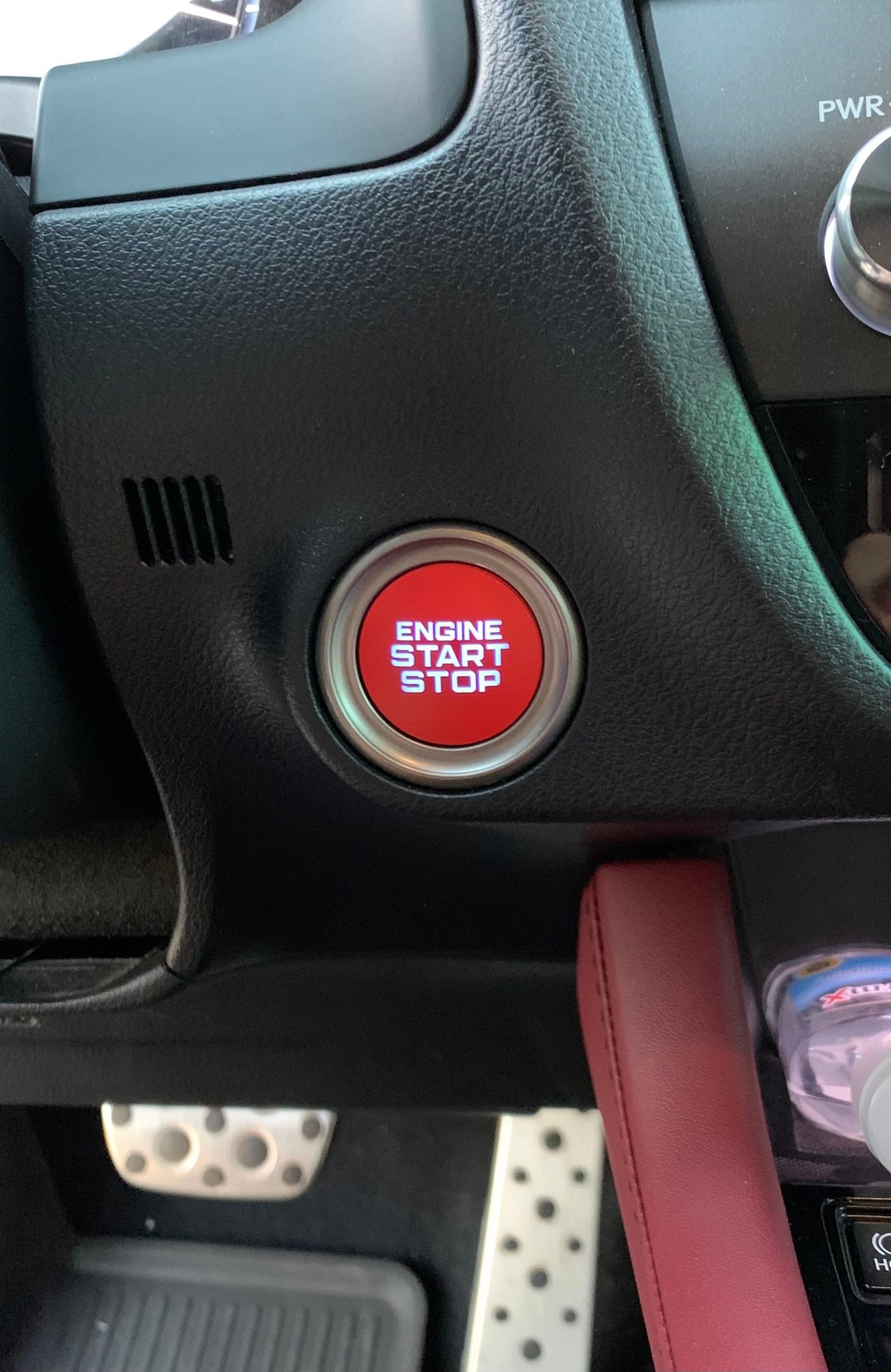

This is what I settled with after trying out a few options. I really wanted to get rid of the chrome bezel ring but I also wanted to go with a red start button. This will do for now. Thank you for your help, nigel821!

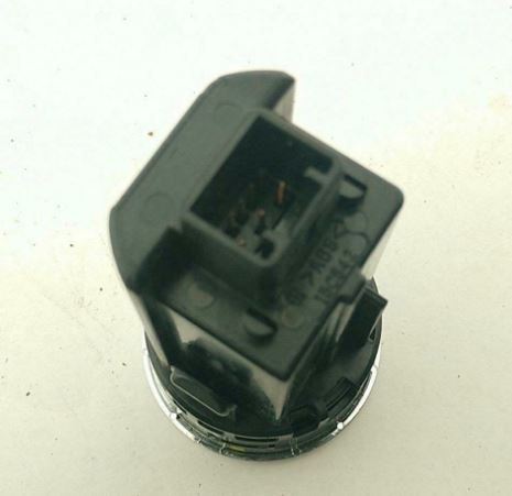

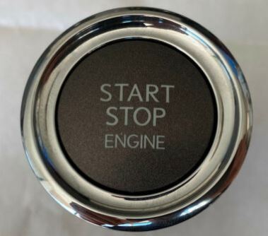

Pretty sure this should be plug and play for you.
Your 2013 doesn't have an LED to show power when it's on right? What's the front of your button look like?
From a quick search the back of your push button switch should look like this:
The LC500/UX..etc. Looks like this: Which is the same:
You shouldn't have to do anything other than unplug your ignition switch and pop the entire assembly out, and click the new one in and plug the harness into it.

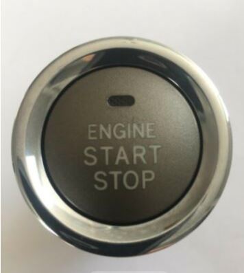

What I meant by LED is does your button look like this first one? If it does the LC500 button will not work since the model with the LED up top uses a different harness.
If your push start looks like this: Then it should be plug and play.
