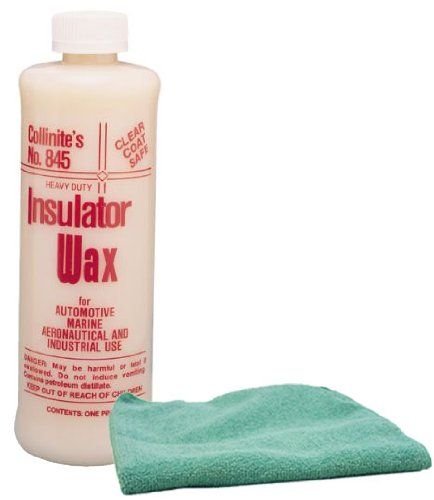

The interval at which the brake dust starts to become unacceptable to me tends to coincide with when I wash my car anyway--about once a week. So for me it's moot.
I keep a layer of extremely durable/famous/popular Collinite IW845 wax on the wheels and the dust for the most part washes right off. Slick stuff.
http://amzn.to/2nFmdVJ

yup...i use rejex. dust still collects but it's less than not using it and as you said it does wash off easier.
http://www.rejex.com/rejex.html
