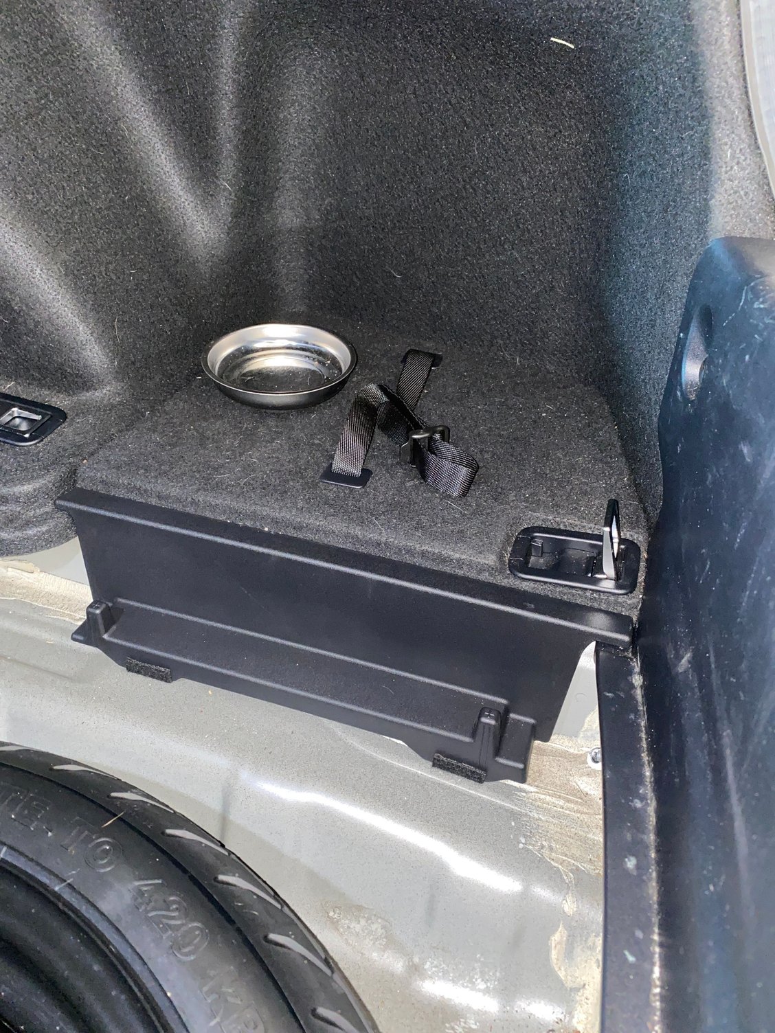

ok awesome, now could you possibly tell me how to remove the cargo net anchor point and that cover. Attached pic for clarification

There’s a plastic flap covering a screw in the center of the tie down.
Pry the flap up to get access to the screw.
