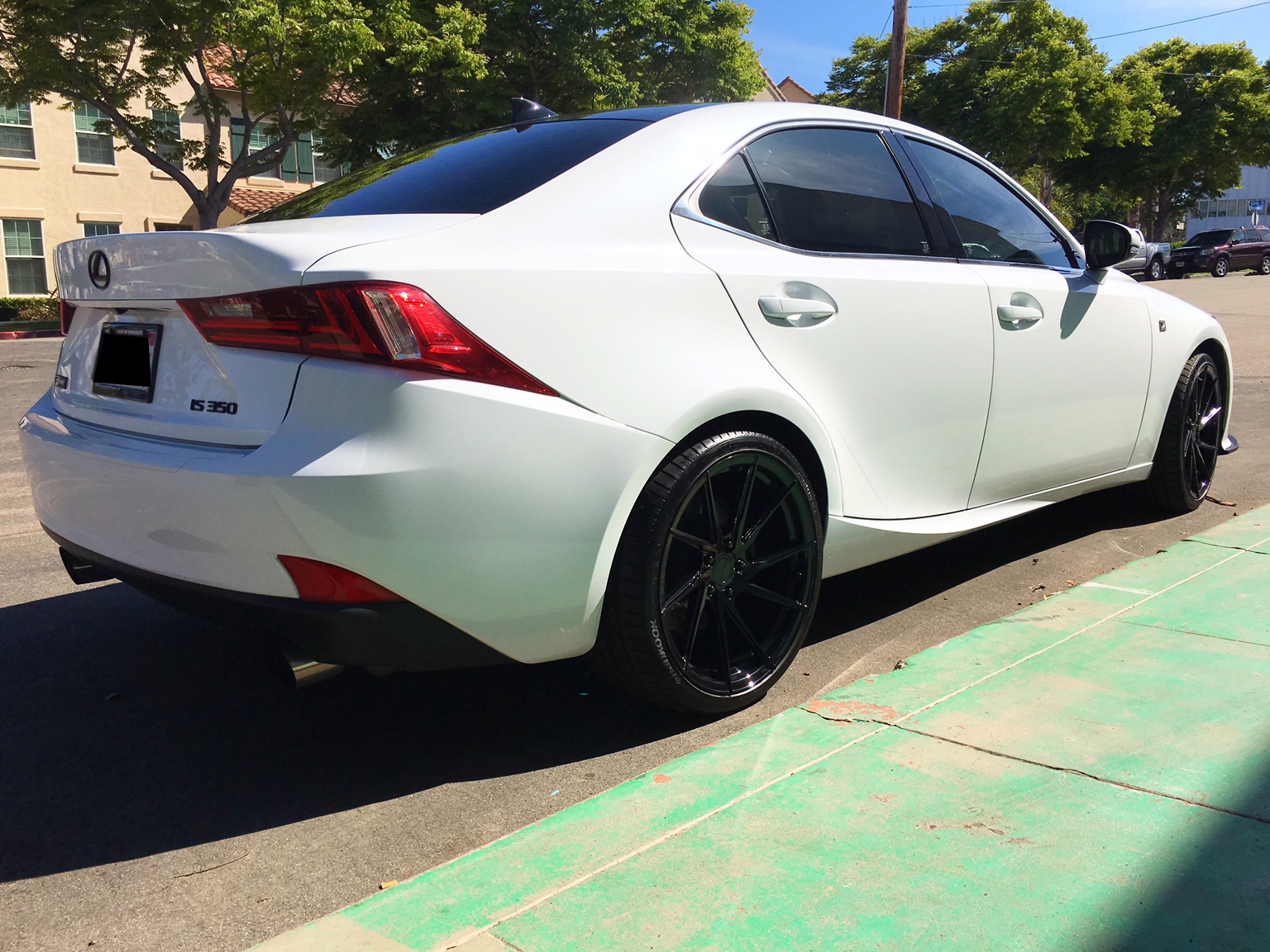

Originally Posted by blizz24
Have you had 2 people on the backseat? Any issues?
Yes, I have and no issues driving around town. However, I haven't tried to enter a steep driveway (like I did in the picture above) with a car full of people and don't think I ever will. LOL

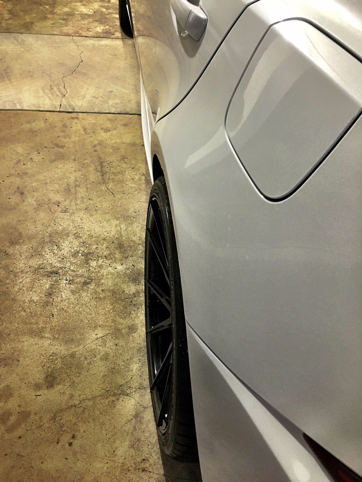

Can you upload picture from behind/straight and behind/angle to see how much they stick out?
I'll try to snap some pics tomorrow sometime and upload a few on Monday.
Originally Posted by dnasians
with 19x8.5+35 will be super close to the upper control arm, too close for comfort
I have absolutely zero issues with the control arm. In fact, I'm 100% comfortable with 19x8.5 +35 on my Stance SF01's - can't speak to any other type of wheel since I don't have firsthand experience with the specs on other wheels.
But, for the OP, if I could do it again, I would probably go with a +33 in the front to make the flushness match the rear a little bit better. This is strictly for cosmetic purposes and my personal preference.
ok, thanks for the info. will keep an eye out for the pics
Attached are a handful of pics I took per your request. Hope they help you decide what offsets will be best for your needs.
