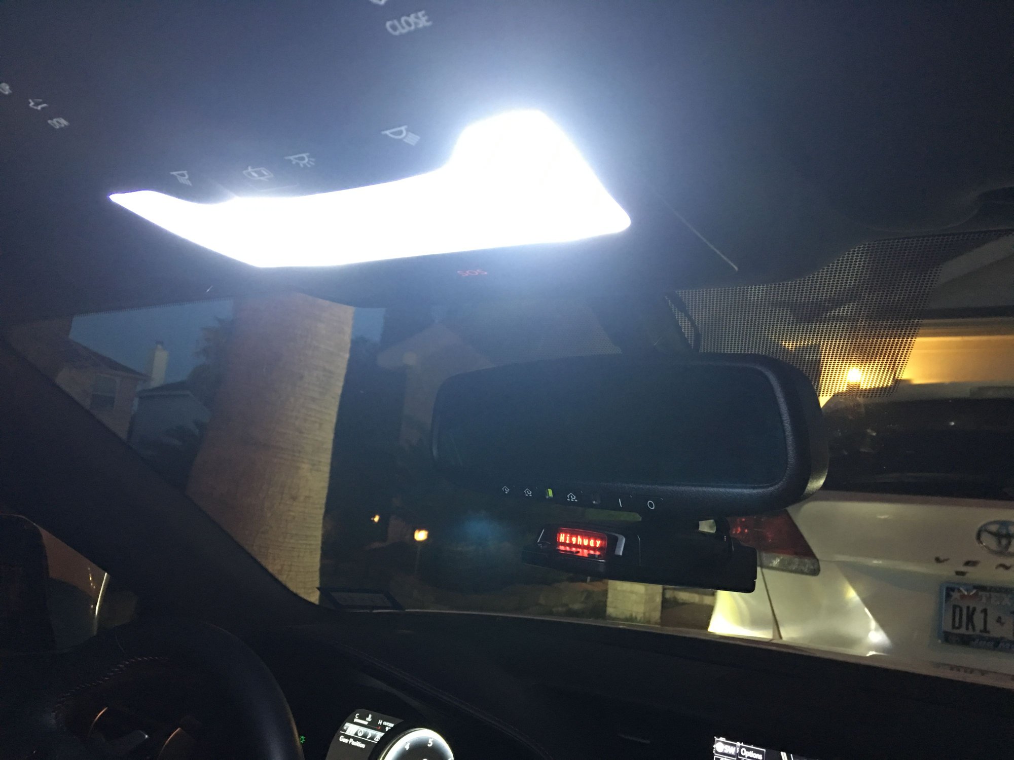

Here is my set up, mirrortap and Blendmount
