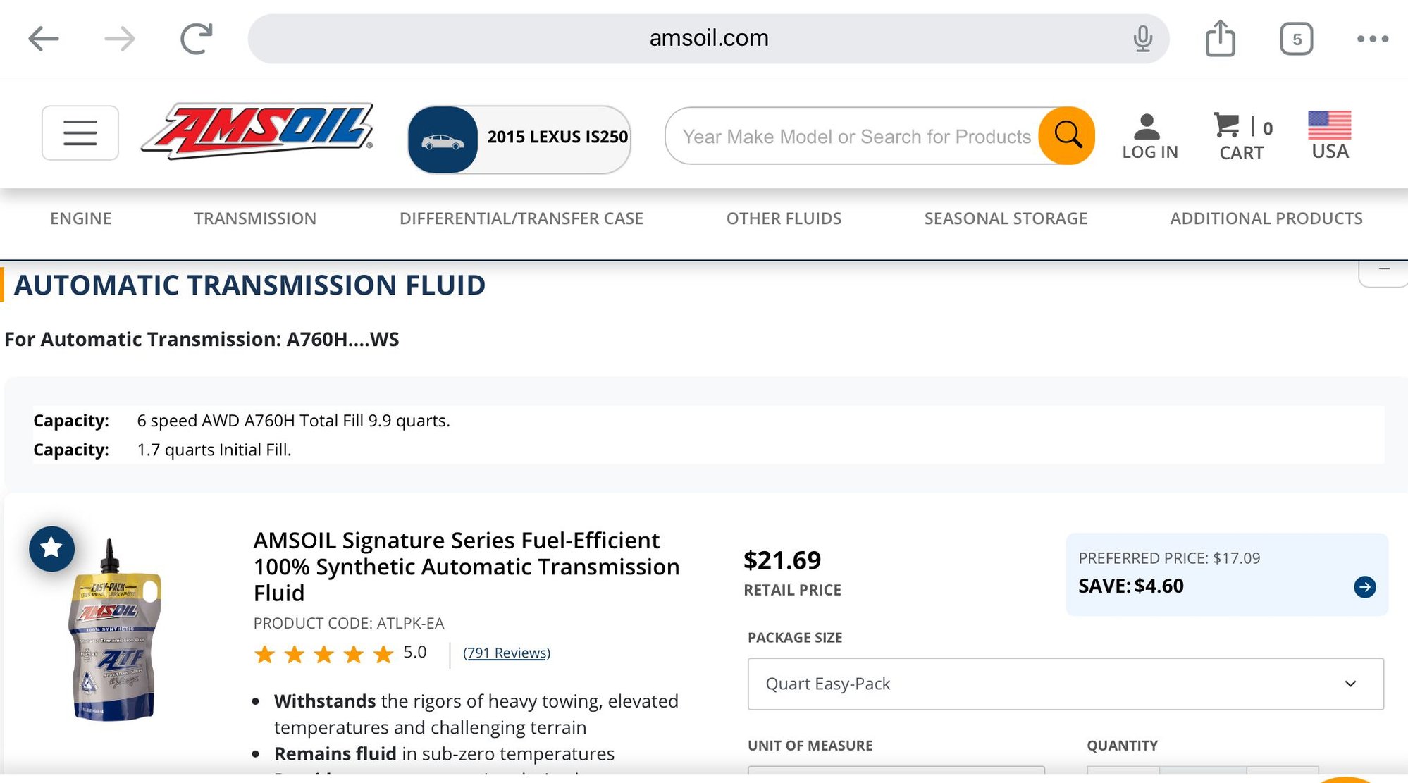

One thing I am confused about is that the awd models drain slightly under 2 quarts when the drain plug is pulled - they are less than most transmissions. This data from Amsoil for your car is consistent with what I’ve experienced, having done five or six drain/fills on this transmission.
The “initial fill” volume given here refers to the correct drain/fill volume:

...One thing I am confused about is that the awd models drain slightly under 2 quarts when the drain plug is pulled - they are less than most transmissions. This data from Amsoil for your car is consistent with what I’ve experienced, having done five or six drain/fills on this transmission.
Interesting. I definitely got around double that amount, 3.5 qts, with each of the 2 drains I did. I did not do any level adjustment after the first time draining, just put in exactly what I took out. That leads me to believe it was over filled by a lot before I got my hands on the car. I guess I'm in for one more drain and fill and see if I get something closer to the 1.7 qts you and Amsoil mention now that the level is possibly maybe set better.
