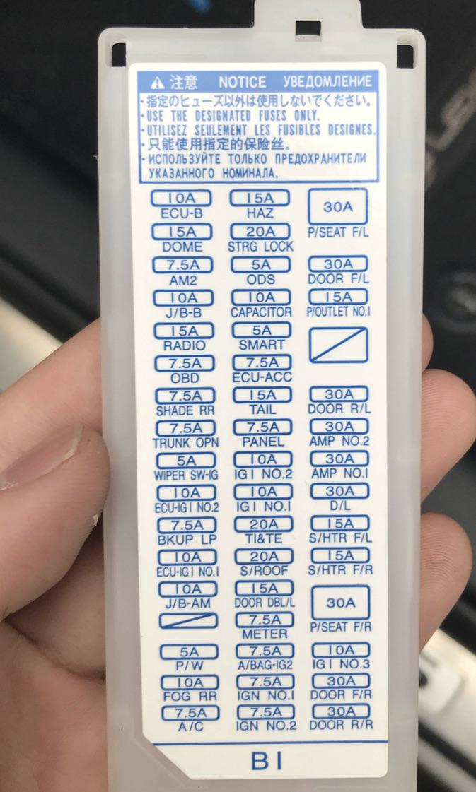

Purchased a 2014 is 350 AWD recently and saw my fog lights weren't working. I decided to get a new set of bulbs but they still didn't work. I have looked through the fuse boxes and it doesn't mention anything about a fog light fuse. Not sure where to go from here, any help would be appreciated

Looks like it says FOG to me. Driver side footwell fuse box.

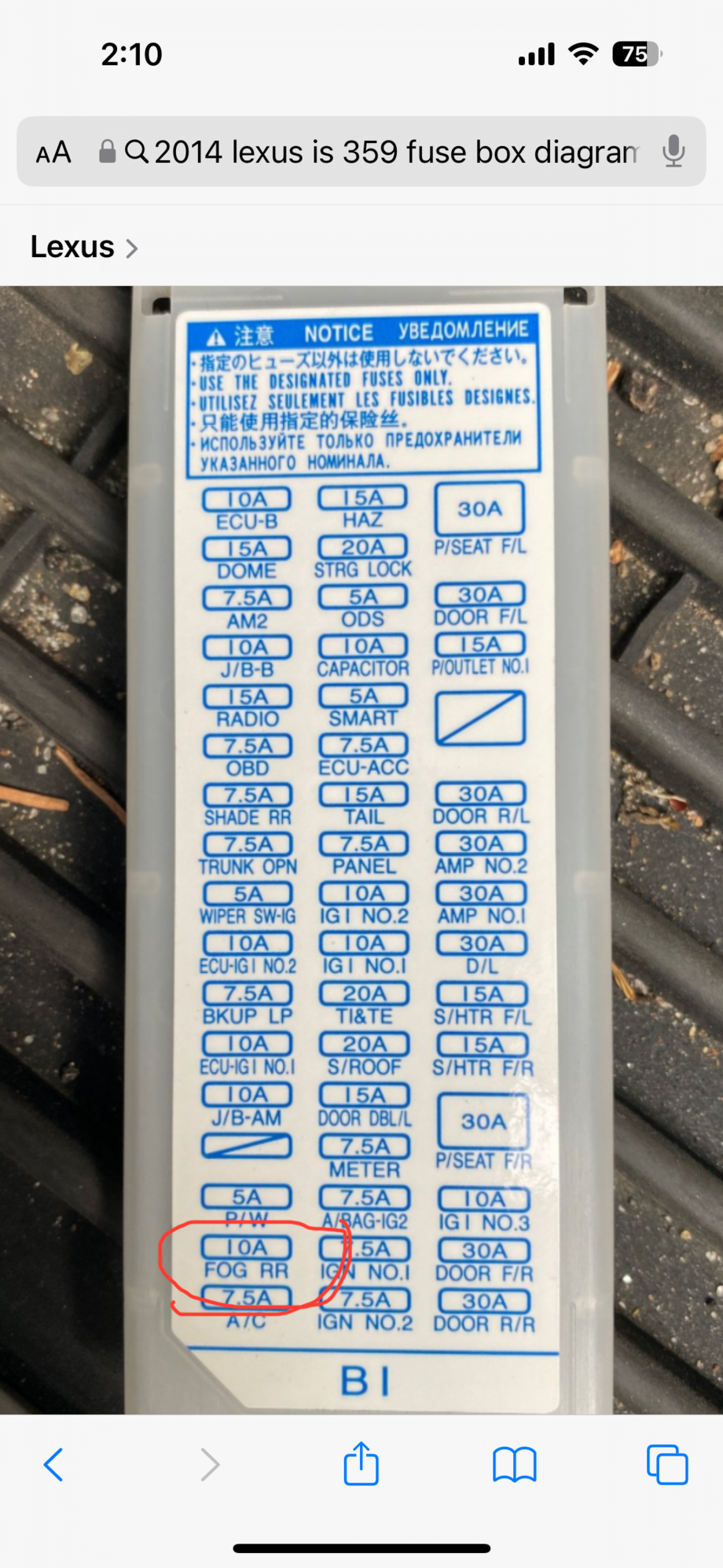

Here is. Second row from the bottom. Good luck.

I checked the fuse and it looked good to me but decided to change regardless. The fog lights still wouldn't turn on. One thing I read online was to see if there was a relay noise when switching the fog light switch on. I noticed there wasn't any on mine. What should i do here? Thanks for the help.
