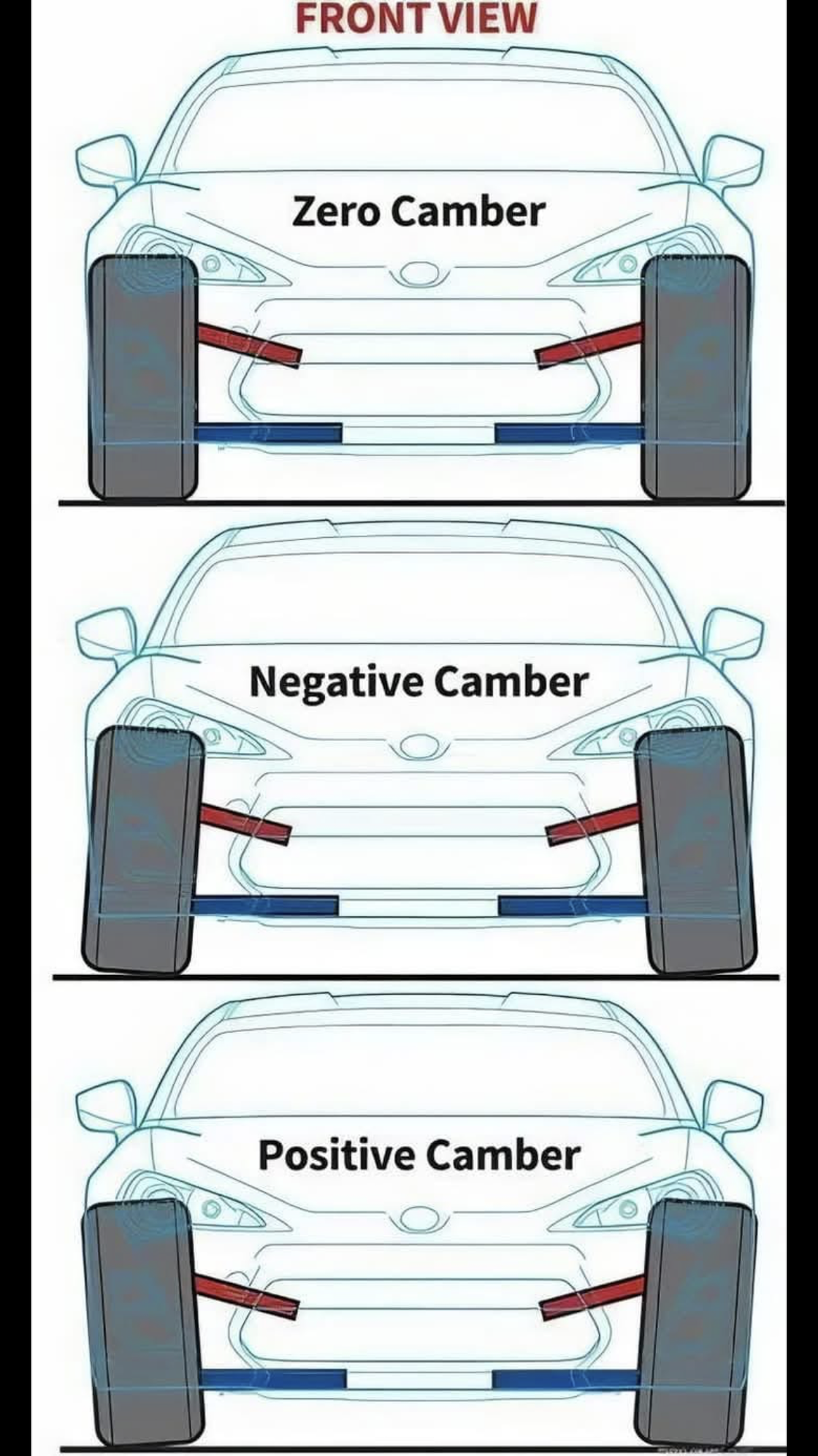

I’m going to assume the rear suspension on your vehicle is factory stock and you are not on Coilovers or drop height springs. Tell the alignment shop you want the rear camber to go positive 1* from stock.

I don’t but the alignment shop has access to the factory alignment specifications and know that by adjusting the rear camber 1 degree positive from original spec your tire will not lean on the inside edge of the tire and instead the entire face of the tire will make contact with the road. You can ask for 1/2 a degree positive camber if you want to experiment. You can always go back and ask for another 1/4 degree positive camber or another 1/2 degree positive until you find perfect wear on the tire.
Alignment shops will know what to do if you explain that you are looking to add positive camber to the rear alignment to minimize or eliminate excessive inner edge rear tire wear.
