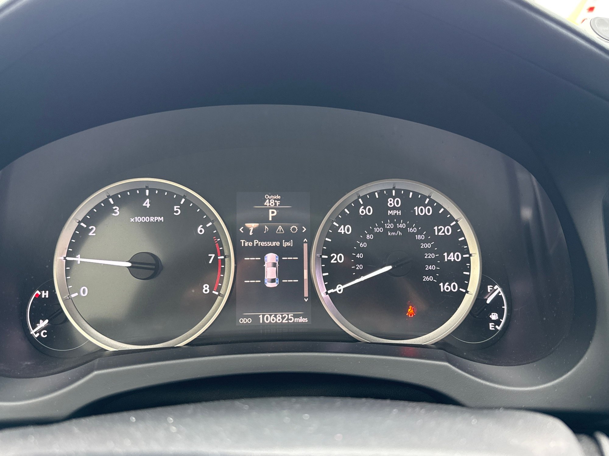

Hey everybody, I’ve been scrolling through different posts and haven’t had much luck with my issue. I hit the reset button under the dash while the car was running on the battery. I’ve read after seeing the light blink 3 times I should turn my car over and let it sit 20 minutes to let it recalibrate. I’m not sure of how true this is. Can anyone back this? Am I doing it wrong?
Another method I’ve read is to drive to let the sensors calibrate and that didn’t work.
I’m also going to try to fill my tires with air while waiting and see if that works.
I usually take my car to the shop and let them take care of it (probably should just do that), but I want to learn how to do it myself. Any help would be appreciated.
I drive an AWD 2014 IS 250
Thanks
No tire pressure reading
No tire pressure reading and no tpms light

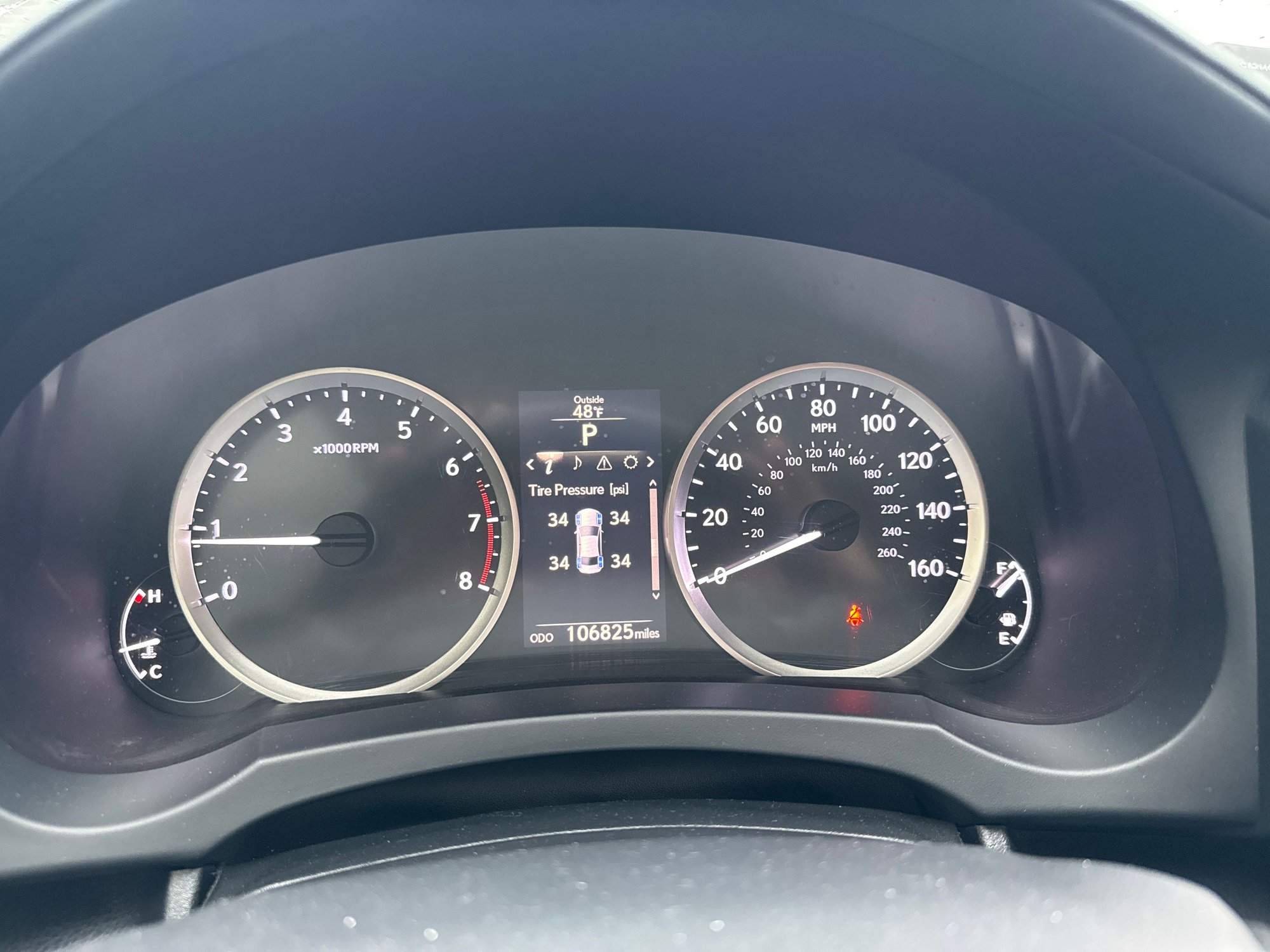

Sat for 30 minutes. No change in my dash. Filled the tires with a little bit of air to the factory recommended 36 psi (they were at 35). Still nothing. I sat for about 10 more minutes defeated. Turned my car off and then turned it back on. I now have tire pressure readings. What did I do right? No clue. Let me know and the community know if you know please.
Weird it’s at 34 after I filled to 36 but it works so I’m not mad.
I will update if it changes.

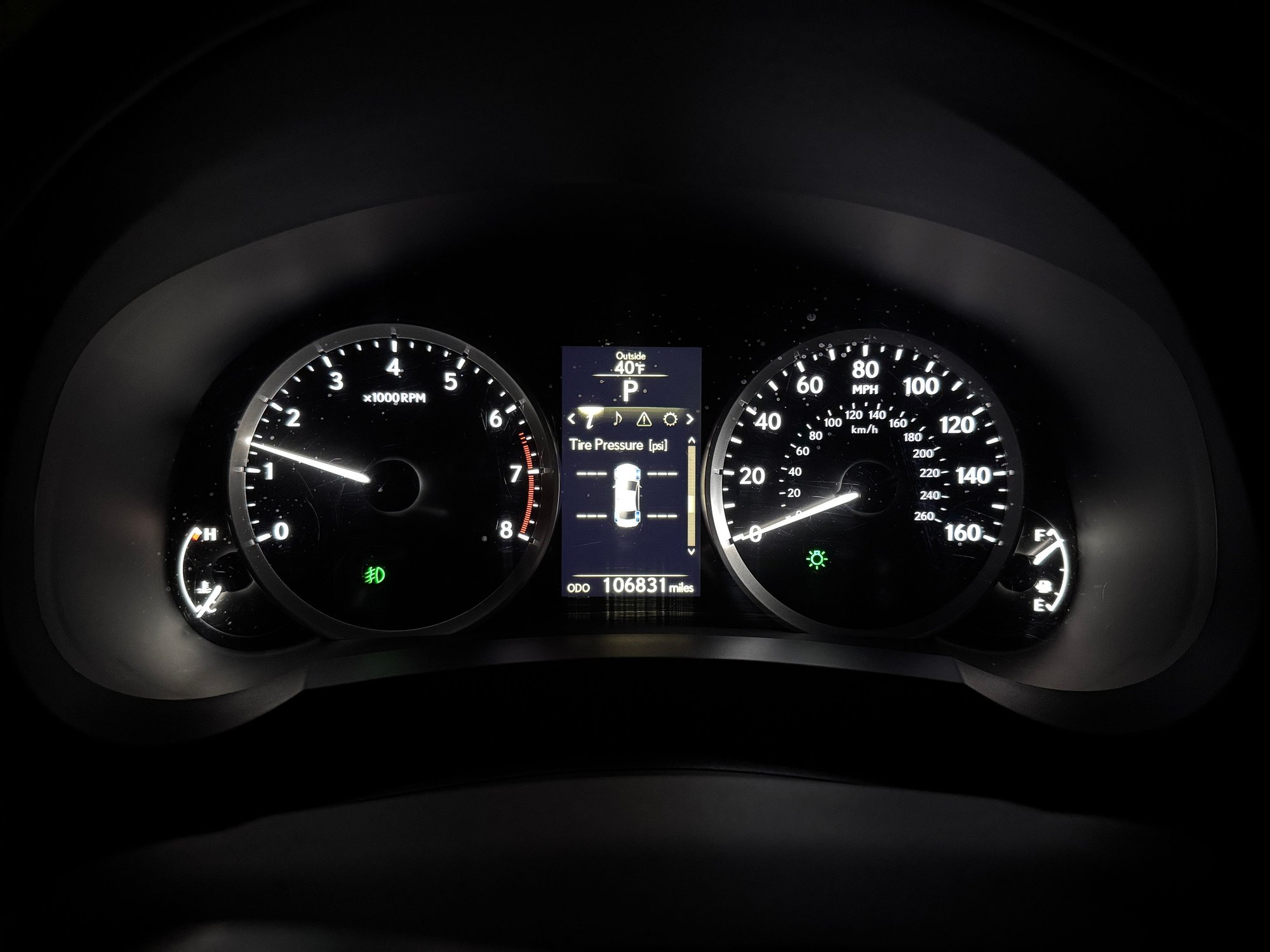

Default Update #2
Woke up this morning and back to the dashes. My best guess now is that the tpms is slowly failing. I’m at work right now, but later today I will try to hook my obd2 to it and see if anything pops up.
Back to Mrs. Dash
Back to Mrs. Dash
