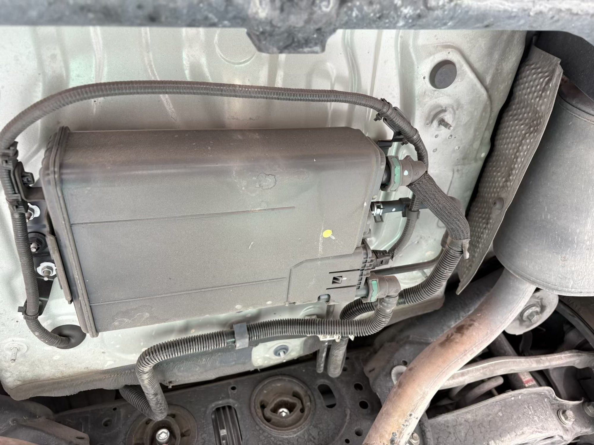

Note: the Charcoal canister is between located between the exhaust mufflers, behind the rear diff, underneath the car, inside of a skid plate. really easy to get to, really easy job.

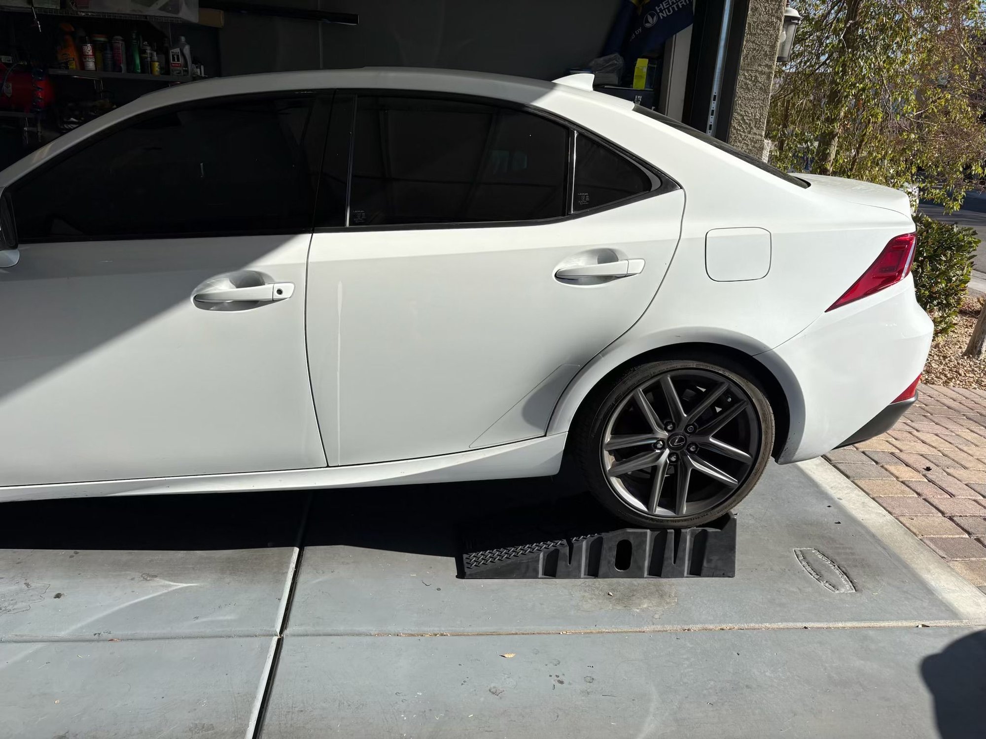

step 1: safety glasses, safety first. lift up the rear, put it on a lift or get some ramps, I used ramps

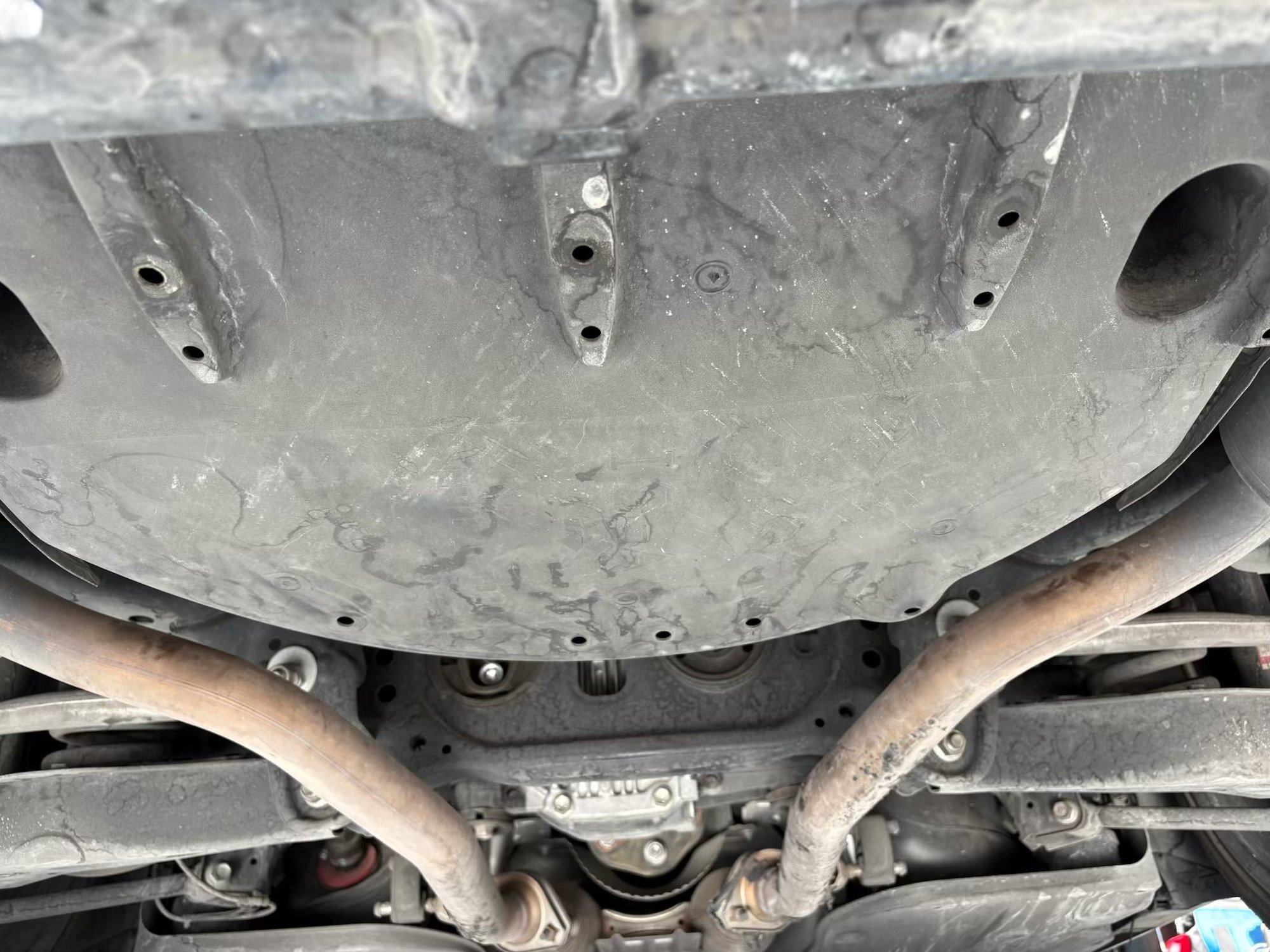

step 2: remove skid plates, 5 plastic bolts, 4 push screws on the rear, you will need a 10mm and a 12mm socket. Normally this wont be a problem, but i personally have a tow hitch on my car, so i have to be flexible.
Step 3: the whole canister is exposed and all of the connections are easy to get to. Start by prying gently all of the electrical harnesses from around the canister. When you get to the two Fuel lines, squeeze the green tabs, pull them down so they are not engaged and GENTLY start pulling wiggling the hoses (no need for any tool, they're easy to get to). There is 1 vent line, two gas hoses and 1 electrical connector (nothing comes out but wear eye protection and move head away from path of dripping and close mouth just in case).
step 4: remove canister. 3 metal mount bolts and 1 plastic . size 12mm
more than enough clearance to do what you gotta do
remove this skid plate, underneath the trunk, between mufflers and behind the rear Diff
remove this skid plate, underneath the trunk, between mufflers and behind the rear Diff. There will be many rocks
Behold in all its glory.
