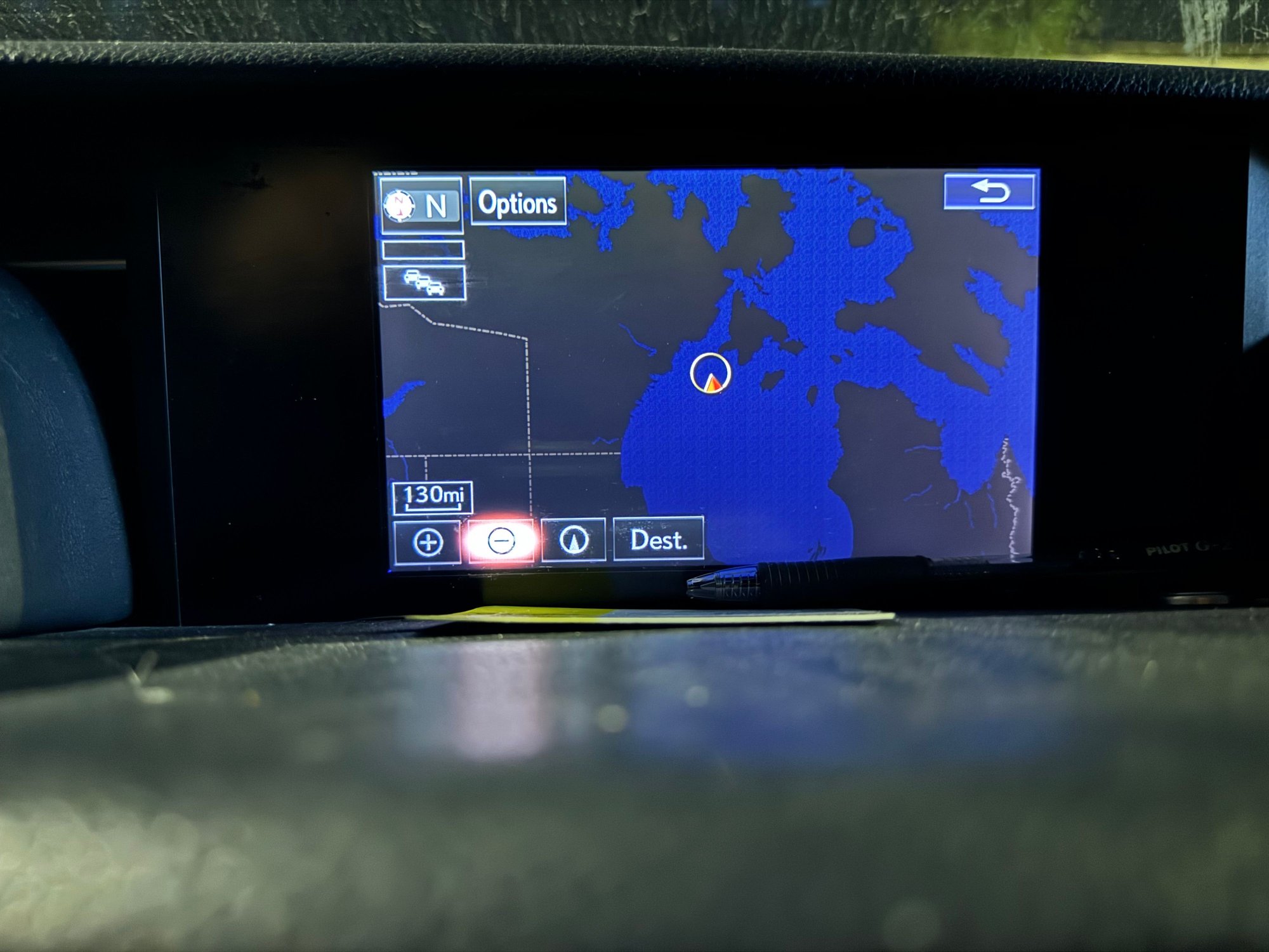

I have a 2014 IS350. The navigation system shows I’m in the middle of the ocean in Antarctica.. Nobody seems to have any idea why. All the other parts of the infotainment system are working. Any help would be appreciated. Thanks for your time.

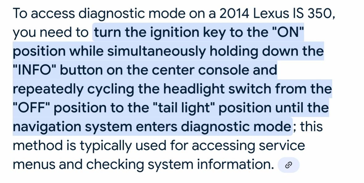

Enter the diagnostics menu:
1. Ignition on or car running
​​​​​ 2. While holding down the Menu button on your center console, twist the light stalk to flip the parking lights on and off 4 times (going more won’t hurt):
3. From the menu select the ‘System Sensors Check’ menu item.

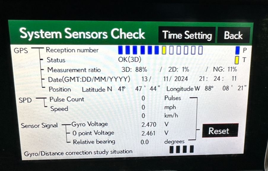

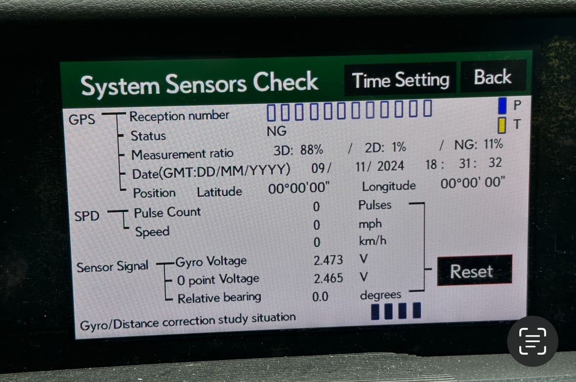

4. On the System Sensors Check page, watch the top line ‘GPS Reception Number’:
5. Give it 4-5 minutes if nothing is showing up on that line. If you only occasionally see 1-3 yellow boxes and no blue boxes:
You might have the same issue I have.
6. Instead, if you have multiple blue boxes, your GPS receiver is working:
7. Ok, if you are not getting positioning data (no blue boxes), do the following:
A. Turn off the car
B. Pull the ‘Radio’ fuse in the fuse block located under the dash, just to the left of the driver’s position:
Wait a few minutes and put the fuse back in.
C. Turn on the ignition or start the car.
D. The display should show the radio rereading the data card
E. After the map comes up, wait about 5 minutes for satellite data to be acquired, and see if the GPS indicator goes active, and then if the location shows correctly a few seconds later.
If this is the situation you’re in, you’ll find that when you turn off the car and restart, the GPS will be lost again.
My workaround was to use a relay, powered by the Ignition 3 fused circuit, to activate the Radio fused circuit.
So every time I start the car, my radio goes through that initialization sequence of rereading the data card, acquire satellite data and activate the GPS indicator and then correctly display my location.

Yep, looking at your first post, I see your GPS indicator is not on (second box down from the top left of the display).
Follow my post above, and see if you’ve got the same issue that I have.

I didn’t install any aftermarket electronics but my battery was low and my car would not read the key fob are turn over are anything. It was saying key not recognozed are something. I got a locksmith to come and program a new key. That didn’t work. I had to get it towed to shop and they put new battery it. Key worked but maybe fried the gps when battery went dead. In diagnostic mode I’m getting one blinking yellow light about every other minute. I’m getting ready to try fuse thanks for your time.
