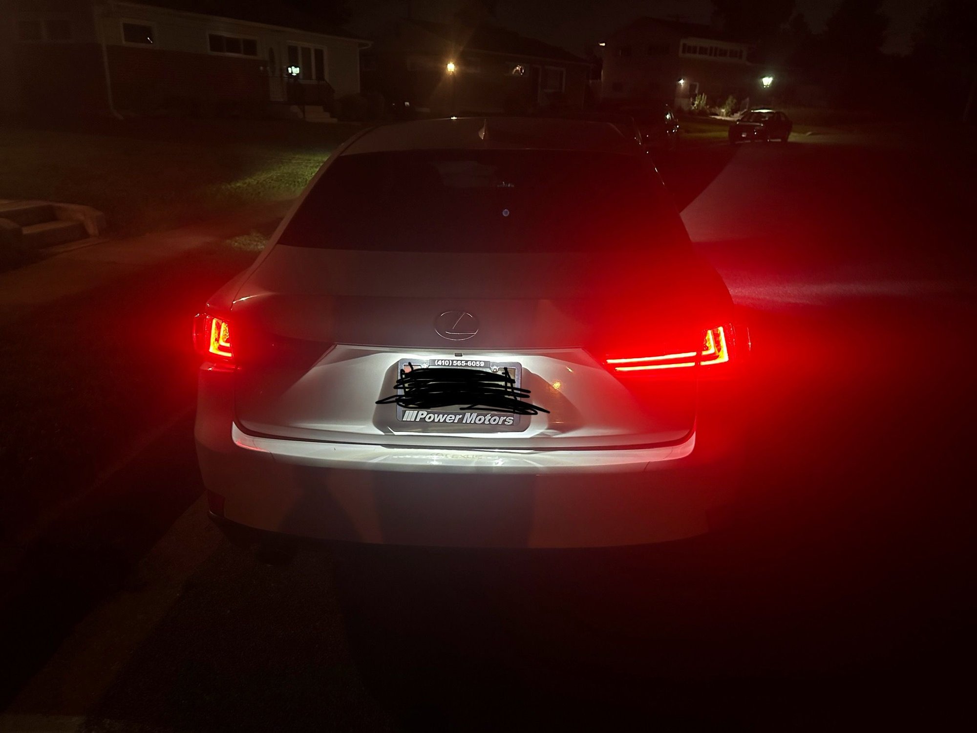

Hey there guys, I wanted having an issue finding out the problem on my is250. The rear running lights on only one side isn’t working I tried checking all the fuses and all of them seem fine to me.

Plug your right light to the left side, if it lights up, then you'll need a new left light.

[QUOTE=Lex_Giorgio;11740960] I’ve tried it and still no power to the led

Any mods done to the car?
Could be a grounding issue or try replacing the tail light fuse (even if it looks fine, just to rule it out completely).
