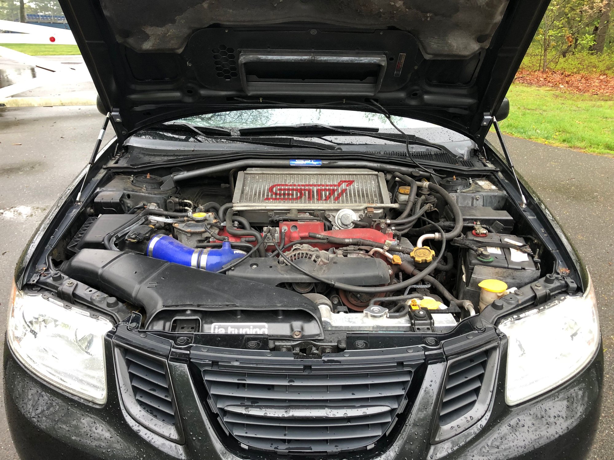

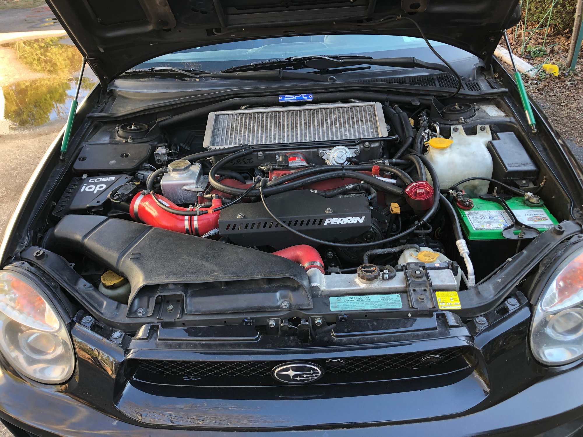

I used oil filters on my dirt bikes when I was a kid. I moved here the last two weeks from the turbo Subaru world. I ran stock air box on all my Subies as they don’t really benefit from aftermarket intake until you are running 350 wheel horse power and above. I’m a paper filter in stock air box boy. Any time I put an aftermarket air intake system on my car it was either made by Subaru Performance Tuning or Cobb, no crappy stuff. I’d go back to stock air box in a week after getting stuck behind a truck sandblasting everyone behind. I’d get paranoid my engine was sucking a bunch of sand. I’m going to be 60 years old later this year and have finally decided to stop modifying my cars. Otherwise I’d be installing an RR supercharger to start with. I’m determined to keep my car as close to oem stock as possible, we shall see, old habits die hard.
