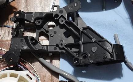

The black part that the mirror housing attaches to I thought would NOT line up at all. IE: IF you try any bolt your mirror housings onto the black mirror motor arm it doesn't line up? I bought JDM mirror housings and they did not bolt up to my LHD black mirror arm base. The mirror housings were at a different angle. So I assumed that the black mirror housing arm of a JDM mirror would not be able to accept a non JDM mirror housing.... I am not clear, did you use the JDM black mirror housing arm or did you use yours from the car and bolt it onto the actual JDM motor? ( I hope I am making sense). I can attach pictures.
IE: The above picture. Did you use your black mirror arm that came with your Canada spec car onto the JDM mirror motor OR, did you use the JDM black mirror arm?

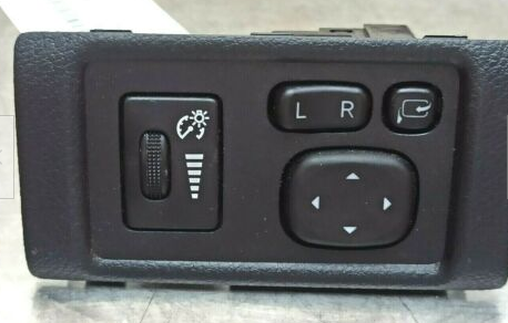

I am sure I will have more questions but I'm totally stoked! I already have JDM mirrors coming from Japan. Ideally if I could use the OEM switch that already has a push button to fold the mirrors in and out would be awesome! This is what the switch looks like:
Front:
Back:

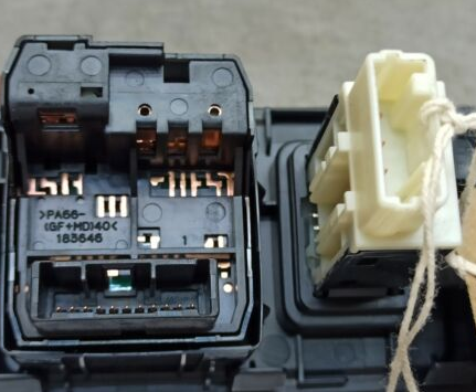

On our CTs in the USA we only have 9 wires going into the stock switch. The above has 11 pins. And below you can see the 11 pin wiring harness (snipped of course). I don't mind using relays but there has to be a way to link the push button on this switch to the relays that you are using right?
JDM/Rest of world back of switch/wiring:
USA spec switch with 9 wires.
So I would imagine that since I am missing two wires in my harness, I could use the power folding mirror switch then just use the two blank spots that in my harness and have those wires going to relays that then would power the mirrors to fold and open.
