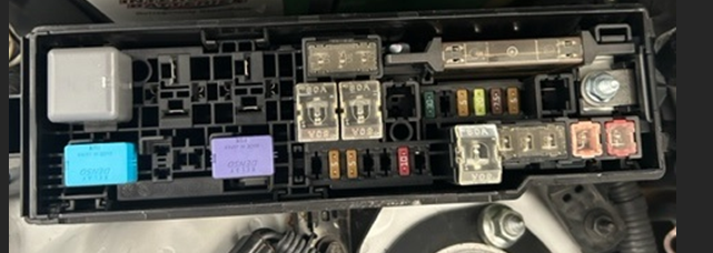

Does anyone know which fuses from these pics are for the front turn signals? I've scoured the entire web and I can only find IS250 diagrams to 2013. I've found some information from the 2014 (which should be the same layout as 2015) but no luck.

I looked at a couple wiring diagrams and it does not seem that there is a dedicated fuse for turn signals. They all seem to get their power from the Combination Meter Assembly. In fact, all the right turn signals (front/rear/side mirror) share the same power source (similarly for the left).

The following fuses are under the driver-side dashboard (inside the car):
- 7.5 A METER
- 10 A MPX-B NO.1
- 15 A HAZ
The interior lights shouldn't have anything to do with it. I'm just confused on why it's only the fronts that are not working, and only after you re-installed them. Do the bulbs look like they're blown? Do you have access to a multimeter to check if power is making it to the bulb connector?
