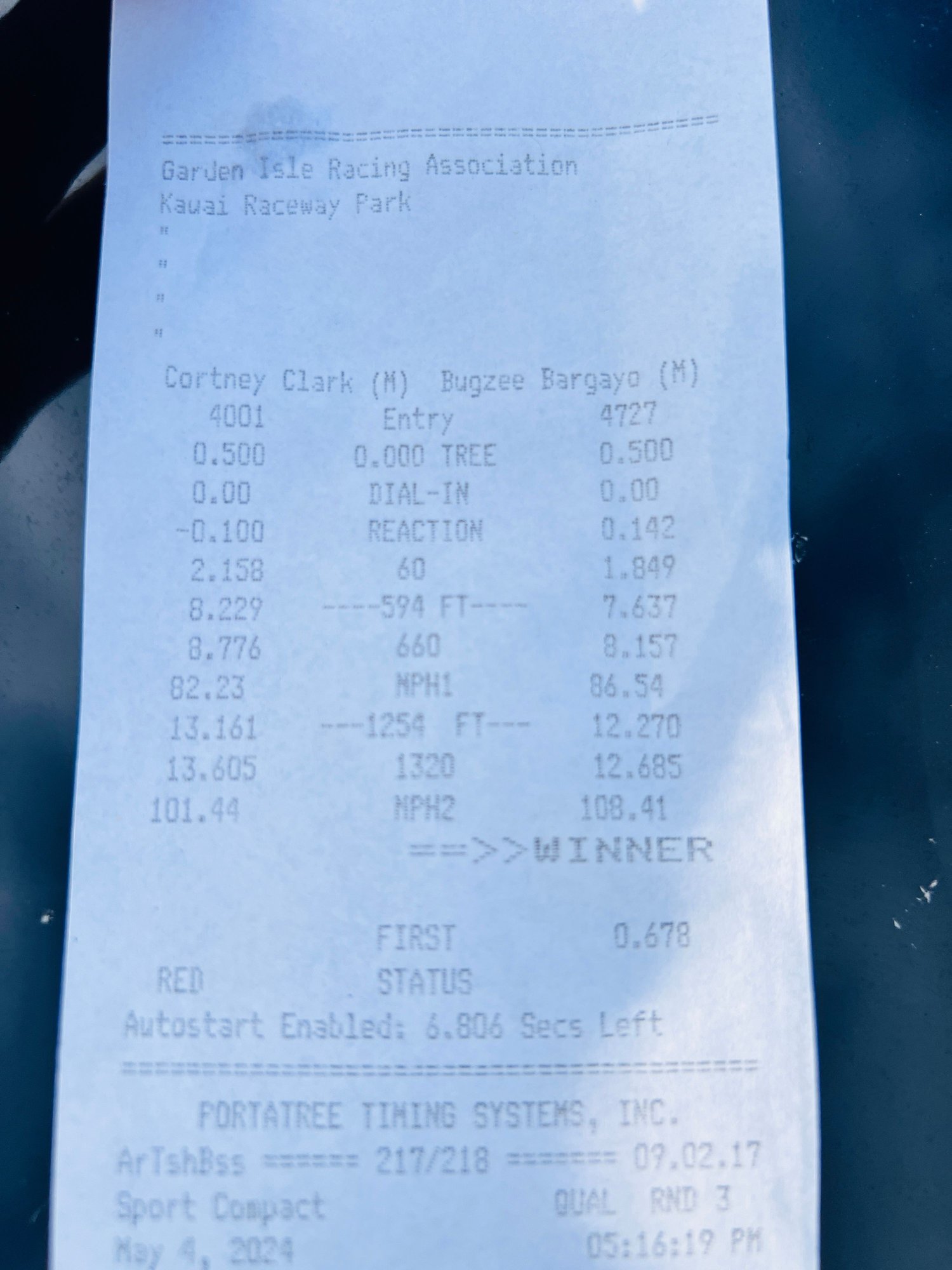

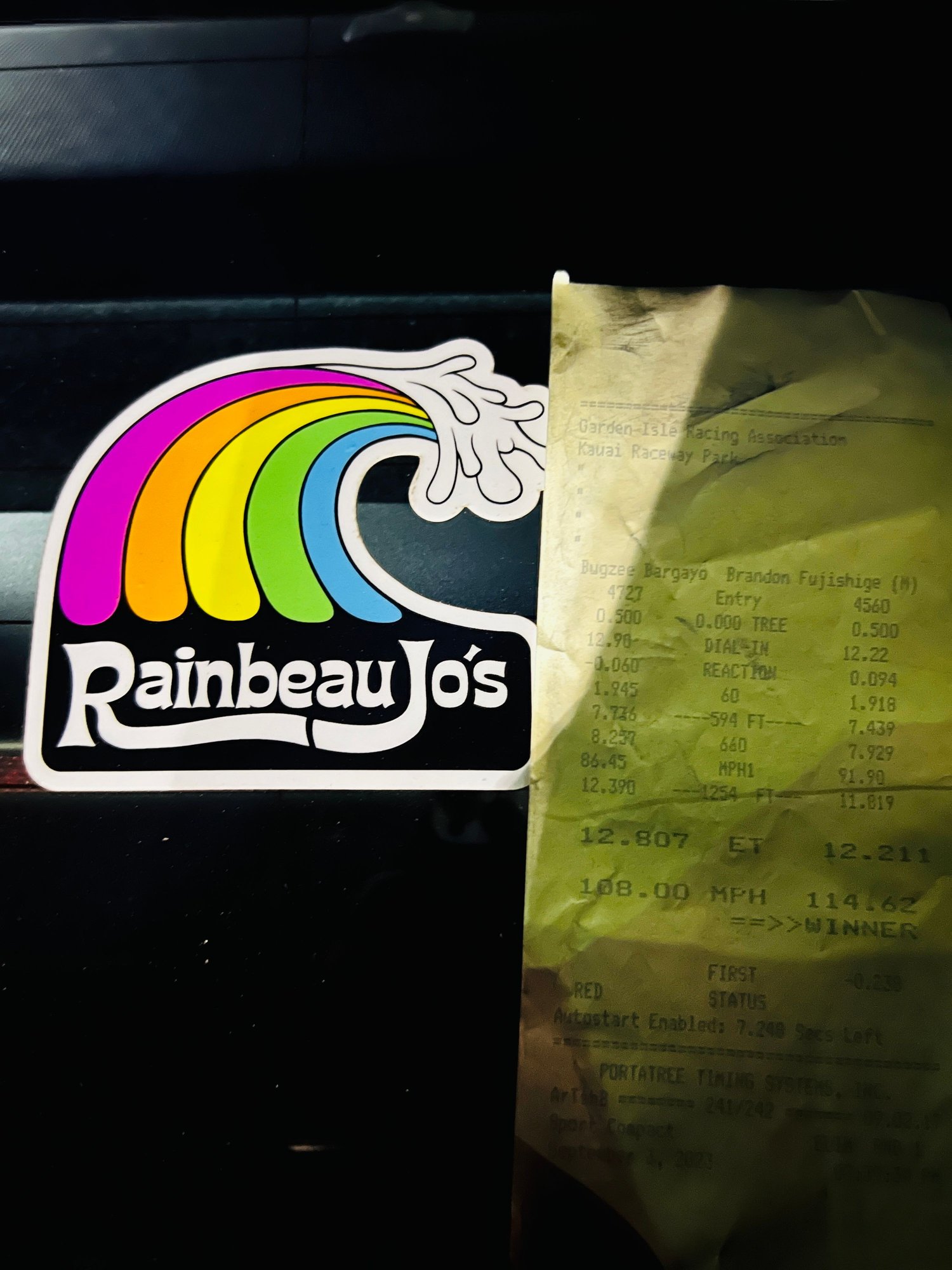

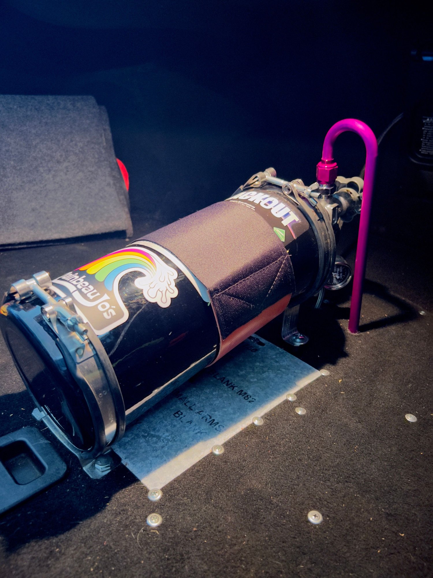

Well i just had my first race of the year last night. So i decided it was time to hit it up with a 75 shot. It is still a dry set up which now has a purge valve and a WOT switch mounted to the gas pedal. This main run right here broke all of
my previous PB’s 0-60 4.4 sec with a 1ft rollout is 4.24 sec, 60ft was 1.8 and my ET was 12.68 @ 108 mph. I was also on VP racing ms103 which will be my last time using it since its cheaper for me to just to use vp octanium. Now that i have a 10lb bottle i should be able to get 10 full passes on 75shot with a bottle heater as well. Overall a dry shot set up is no harder than setting up a sound system lol. For me i took my sweet *** time beacuse i wanted it to look like i dont have nitrous until you remove the plastic engine cover
