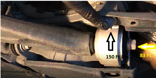

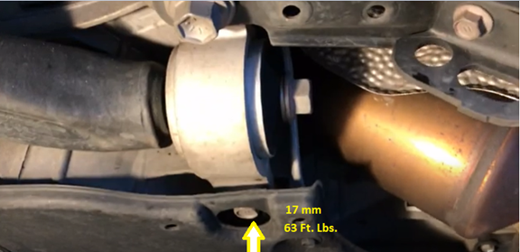

lexus-is2,
The following discussion is one that has information provided by many members which assisted me with successfully performing the LCA busing install using ramps,
Lower Control Arm Bushings...
https://www.clublexus.com/forums/is-...ushings-6.html
OEM Part # 48076-24010 - LCA bushings:: 2015 - 2022 Lexus base RC F (Left / Right 0 offset / 2015 - 2019 RC F Premium , 2020 F Track Edition, 2021 - 2022 RC F Fuji Speedway Edition (INSTALLED THESE)
OEM Part # 48075-30030 - LCA bushings: 2006 - 2013 IS 350 (Left / Right 0 offset)
Key Items Taken From the thread;
22mm socket (center bolt and top bolt where gloved finger is pointing at)
17mm socket (1 bolt with nut on top)
14mm socket (2 bolts to remove bracket)
10mm socket (2 bolts to remove panel)
When installing the LCA bushings;
