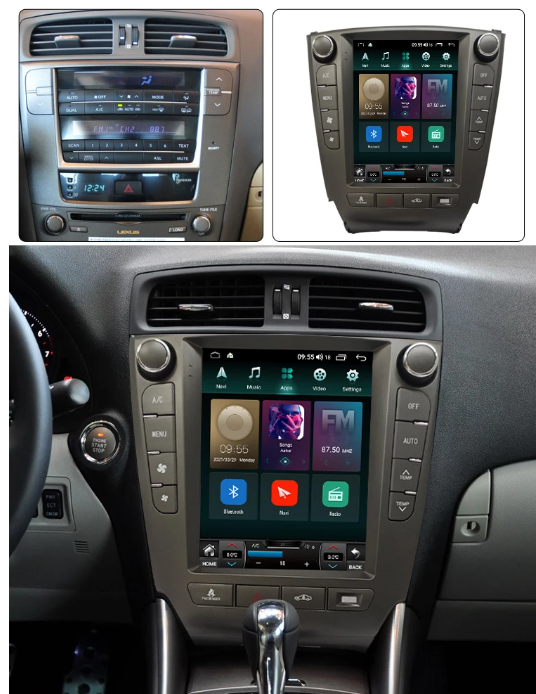

Hello!
I got this android from Aliexpress and can't get steering wheel buttons and climate control to work properly.
I think its a can bus box issue. I don't know which brand to select in settings.
This is a canbus box supplied with the unit. I have 2 plugs inserted at both sides to it.

You have to try and find Lexus IS250 in the Canbus settings. It might be laborious to go through all the settings, but if you aren't using the proper one, the climate control and steering buttons will not work.

Seller got back to me, I had to select Lexus ES, after that steering and climate control started to work
