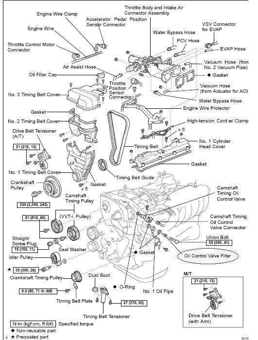

From: Muscat
Hi guys,
let me tell you secret about this car,
actually there is a small filter in the top of the engine and around 95% of the mechanic does not know about.
even if you change the oil with filter regularly, the engine may be damaged. the reason is this filter.
it called OCV filter.
the below picture will describe the situation and the filter is 100% blocked

Thanks for the tip. This has been around since VVTI was introduced. My secret for this not to happen. Is to use quality oil, and follow the recommended change interval.

Thanks. I got a new one put in last year due to suspicion it might be a problem, but it didn't change anything.

Just to clarify, there is one for each bank. We're both replaced ?

My mistake, got that mixed up with the PCV valve, which I got replaced last year. No, I don't know anything about the OCV filter.

The oil feeds being restricted could explain the early loss of a chain set, as I know they feed the VVT-i (a controlled oil leak lubricating the chains). The feeds also coil the valve springs. What I don't know is if they pump up the lifters.
If they do, it could explain a few things in your case.
At this point, I'd say its a given that that engine has more particulates in the oil from wear, combustion products in the oil, and being ran low/out of oil. @ameer90 has a good point, but it may be too late.
