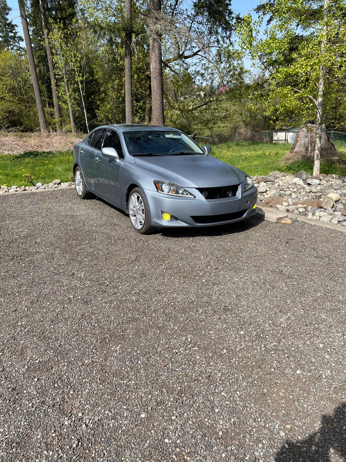

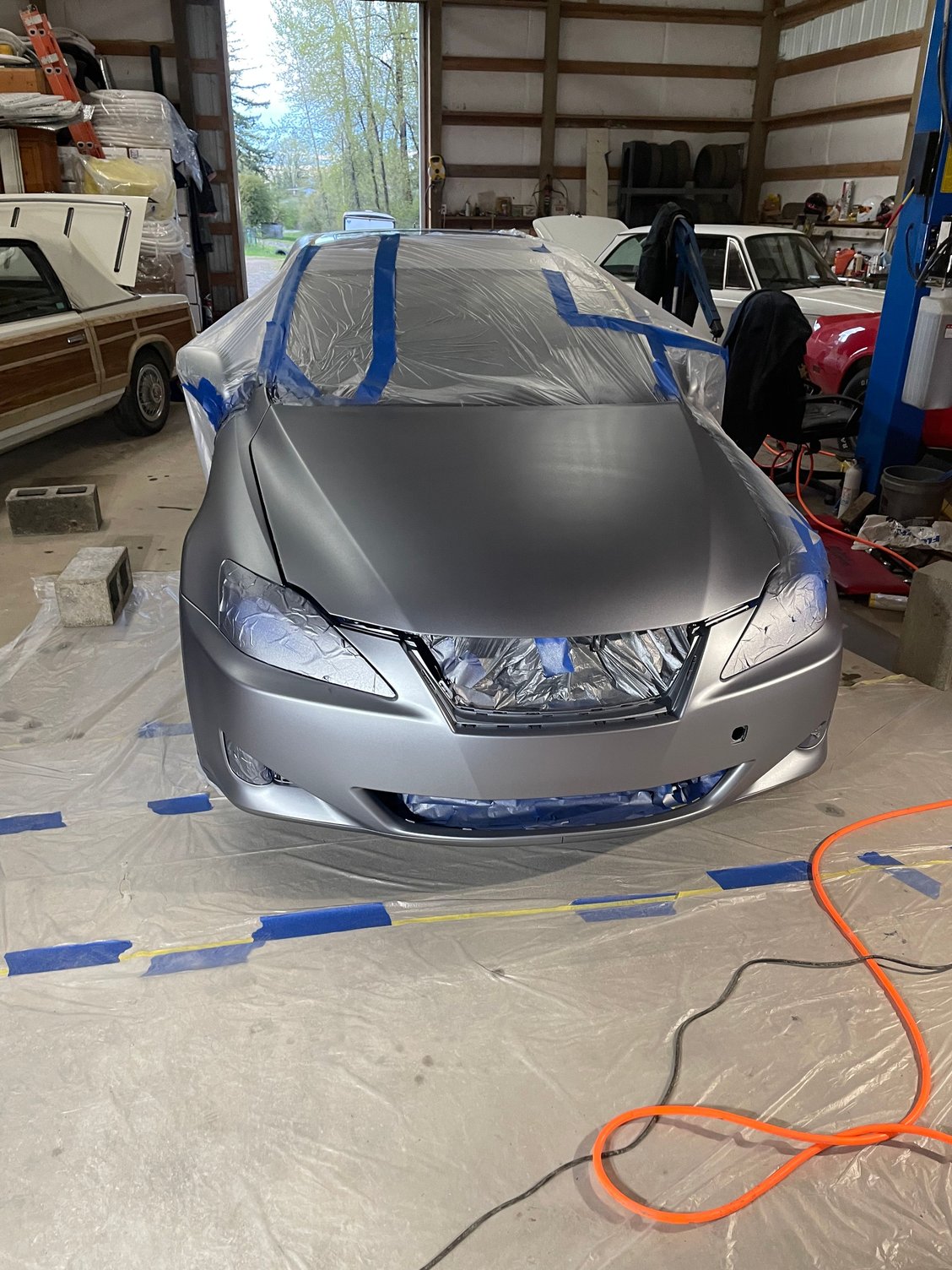

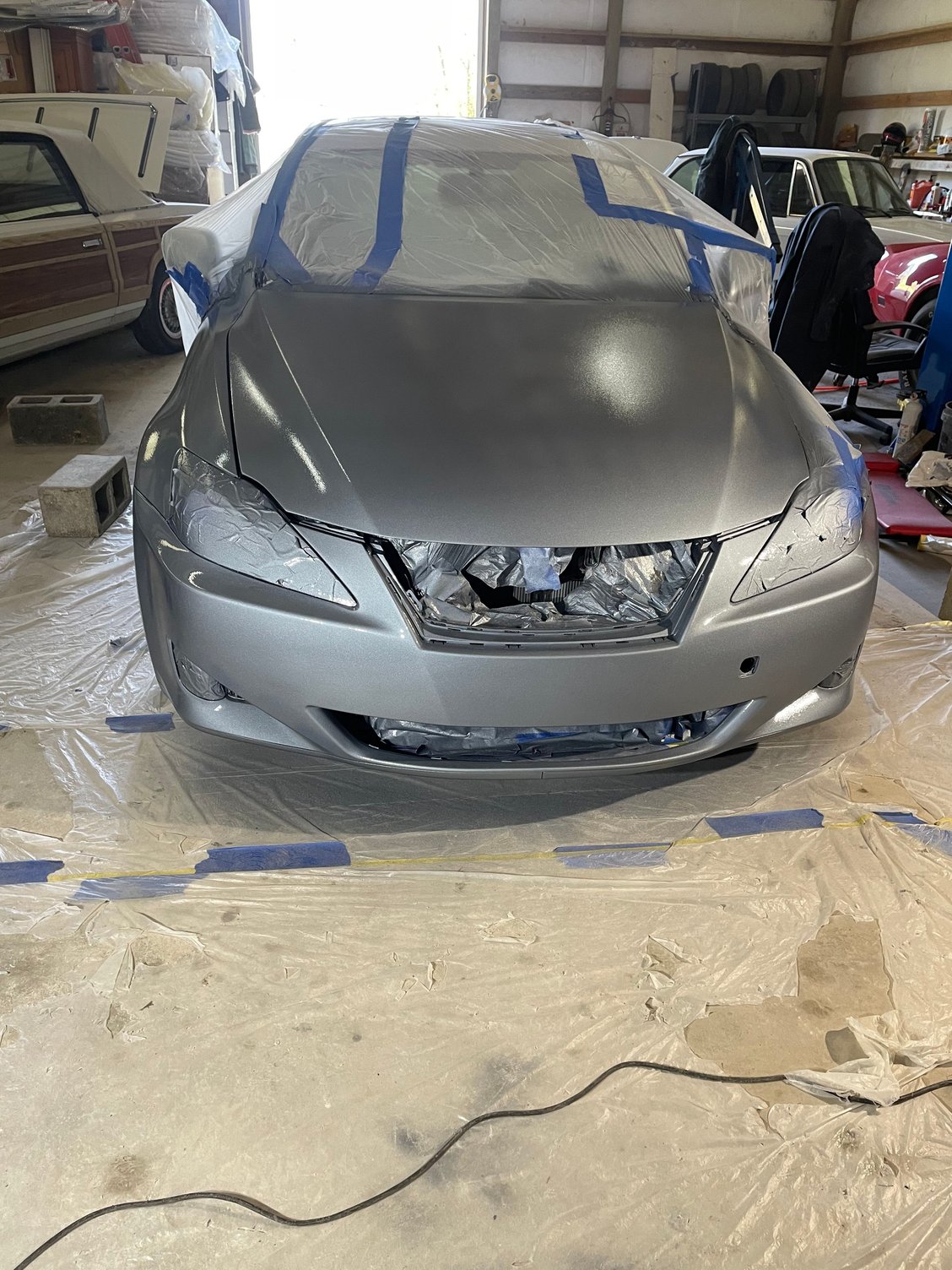

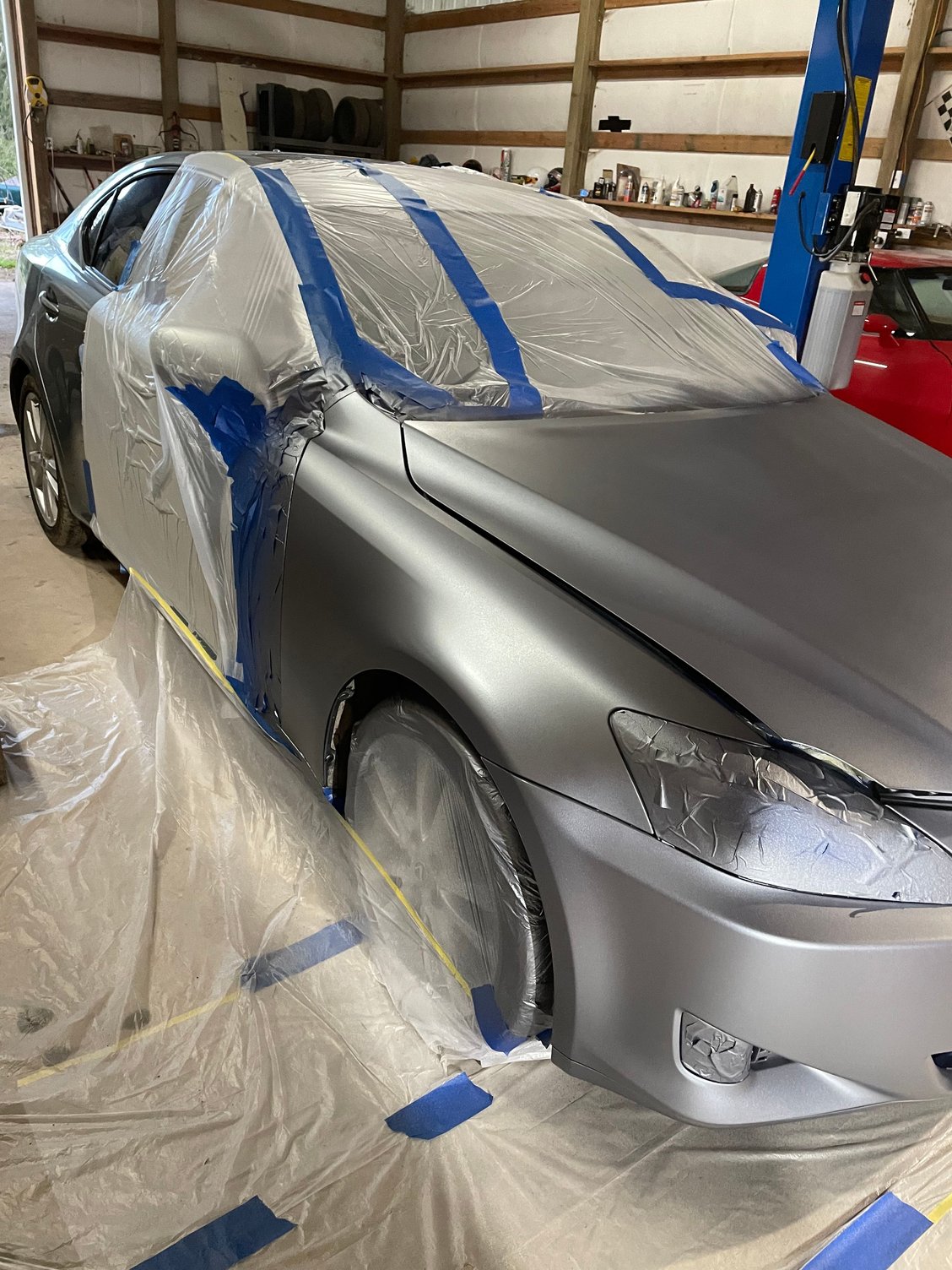

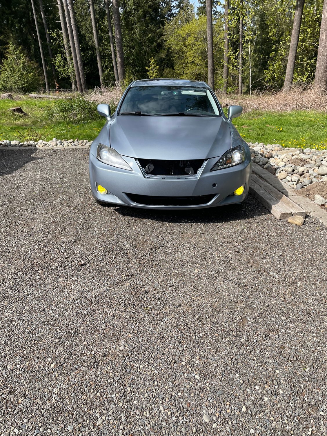

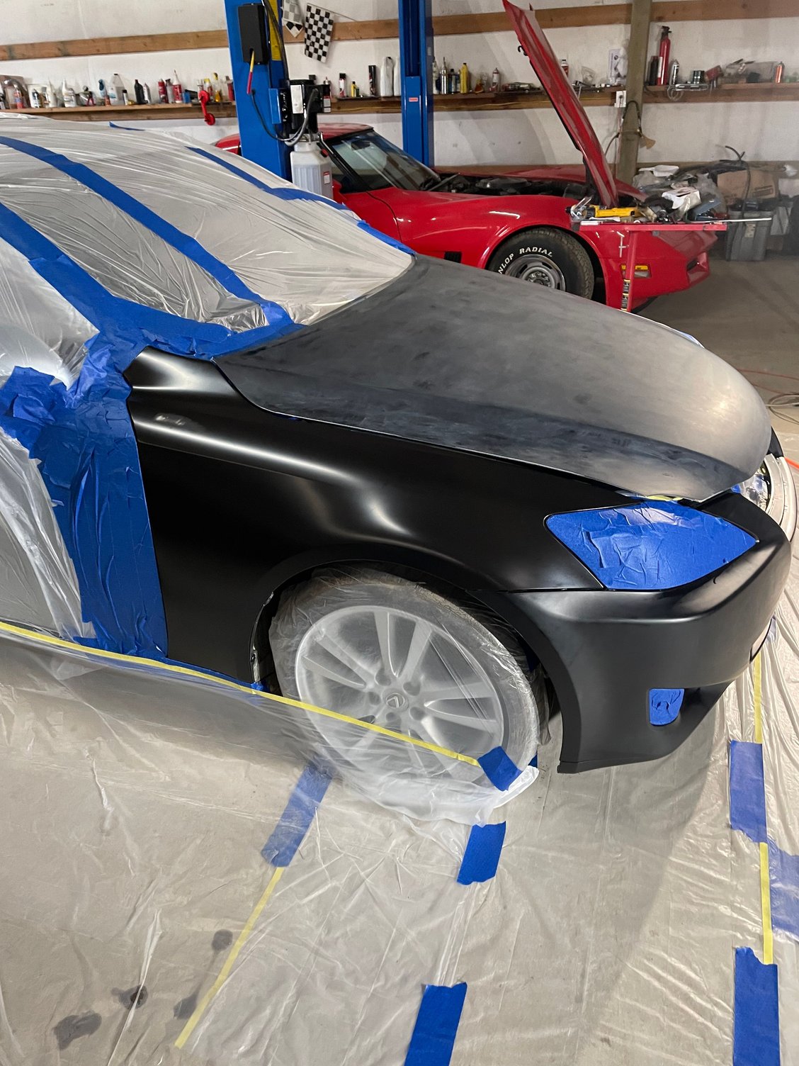

So received a quote to ping this from Macao for 1000-1500$ for the basic job. I decided to buy the paint($200) and supplies($150-200) to paint it myself. I took auto body in highschool so I’m familiar with the process but this is my first time actually paint a car. I will not be attempting to blend anything, the transition from 15yr old pint to new hopefully won’t be too drastic.
i will say it wasn’t until my last clear coat that I realized the trigger on my spray gun wasn’t tuned properly. This led to light coats with an orange peel surface, currently I’m waiting for the clear coat to cure before I begging sanding the finish down.
Here are some pictures of my progress.

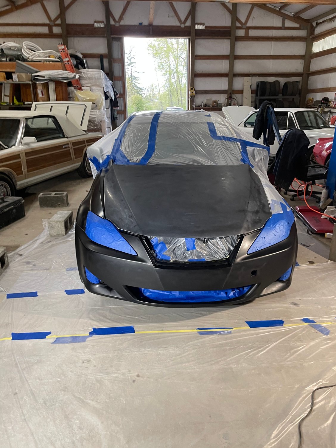

Taped, peeped with 600 grit for hood and a plastic adhesion coat on bumper with flex agent to avoid cracking.

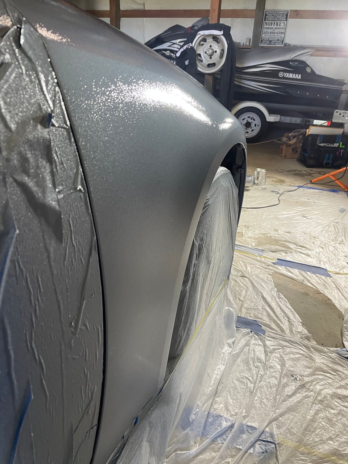

Base coat
Clear coat
You can see here some of the orange peel
24 hrs later I pulled it out of the shop to cure faster in the sun, it’s 50-60 degrees f here which is a little colder than optimal for this curing process.
