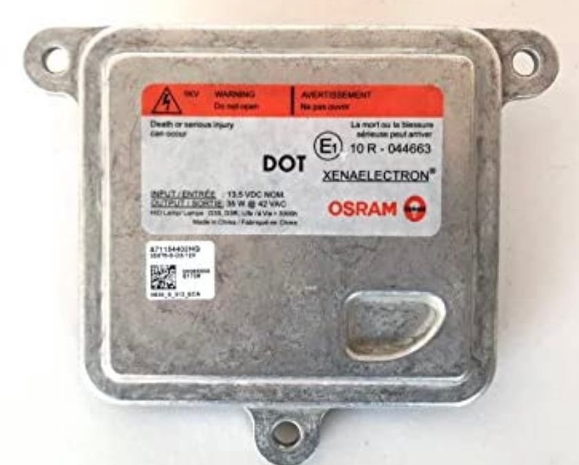

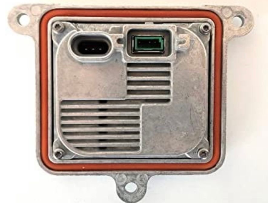

The previous owner took apart the headlight housings and installed aftermarket lighting, heated the housings to separate, installed a ballast system that was made for a 2012-2015 Tesla Model S, and reheated to reseal the housings. I’m just trying to undo another’s screwup. See the ballasts photos attached.
Not made for IS250

Thats just it. Water was getting into them. The ballasts used were for 2012-2015 Tesla S and I found once I took apart. Unfortunately, the bumper I replaced without repairing so that my daughter could get back and forth to school. The bulbs used were D3S. I uploaded the ballast photos but will upload again. From an auto repair shop I was told they heated the housings in order to take apart and installed the D3S bulb brackets and harness that comes out of the housing and connects to the ballasts. They heated the housings again to create a seal for the rubber. The pins at the attachment area were completely corroded. This is when I found that the ballasts used were incorrect. Even the company from Amazon informed me that this ballast would not work, but I was only purchasing what I took off the car.
For 2012-2015 Tesla Model S
