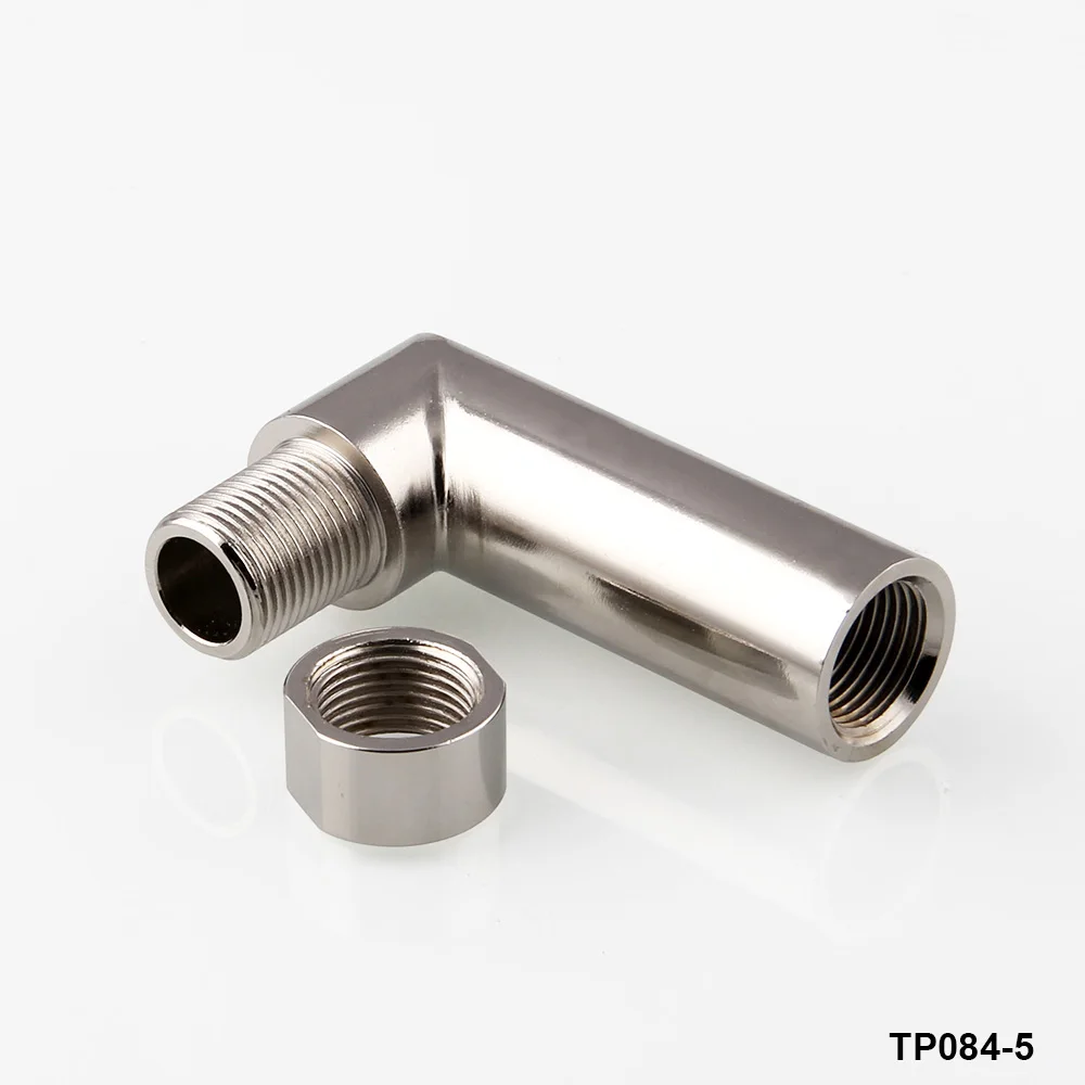

you'll need a 90 degree o2 sensors spacer anyways cuz if you put the o2 sensors in, the check engine light will pop up lol...
you'll need something like this:

Those are primary O2's, I would not want to use a 90deg adapter there. It's important that they get a good reading of the exhaust stream or the fueling will be off.
the 90deg defoulers are useful for the secondary O2 sensors to eliminate the CEL

Correct that's not going to give the ECU a good finite read to optimize air/fuel and other. The very purpose of 90 degree ones is to mis-read and fool the ECU with a false kinda data.
All these option Suck but, you can try to file away some at the Trans cooler if it does not make anything ware and contact. You can have the bung fixed, cut re-welded up and moved, or send them back to RR. You are having some real problems with them for some reason. Are those PPE Headers RR is distributing and selling? Have you tried contacting PPE directly to see what going on about this?
