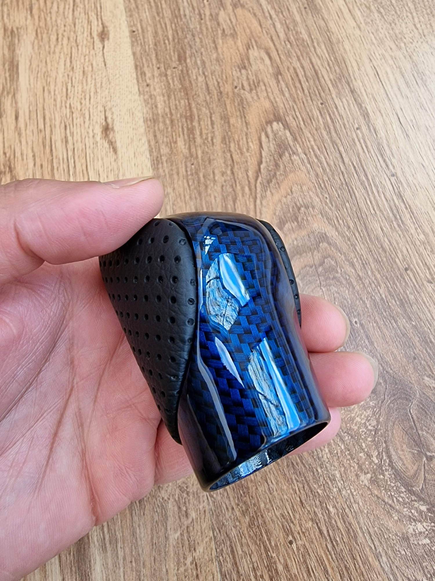

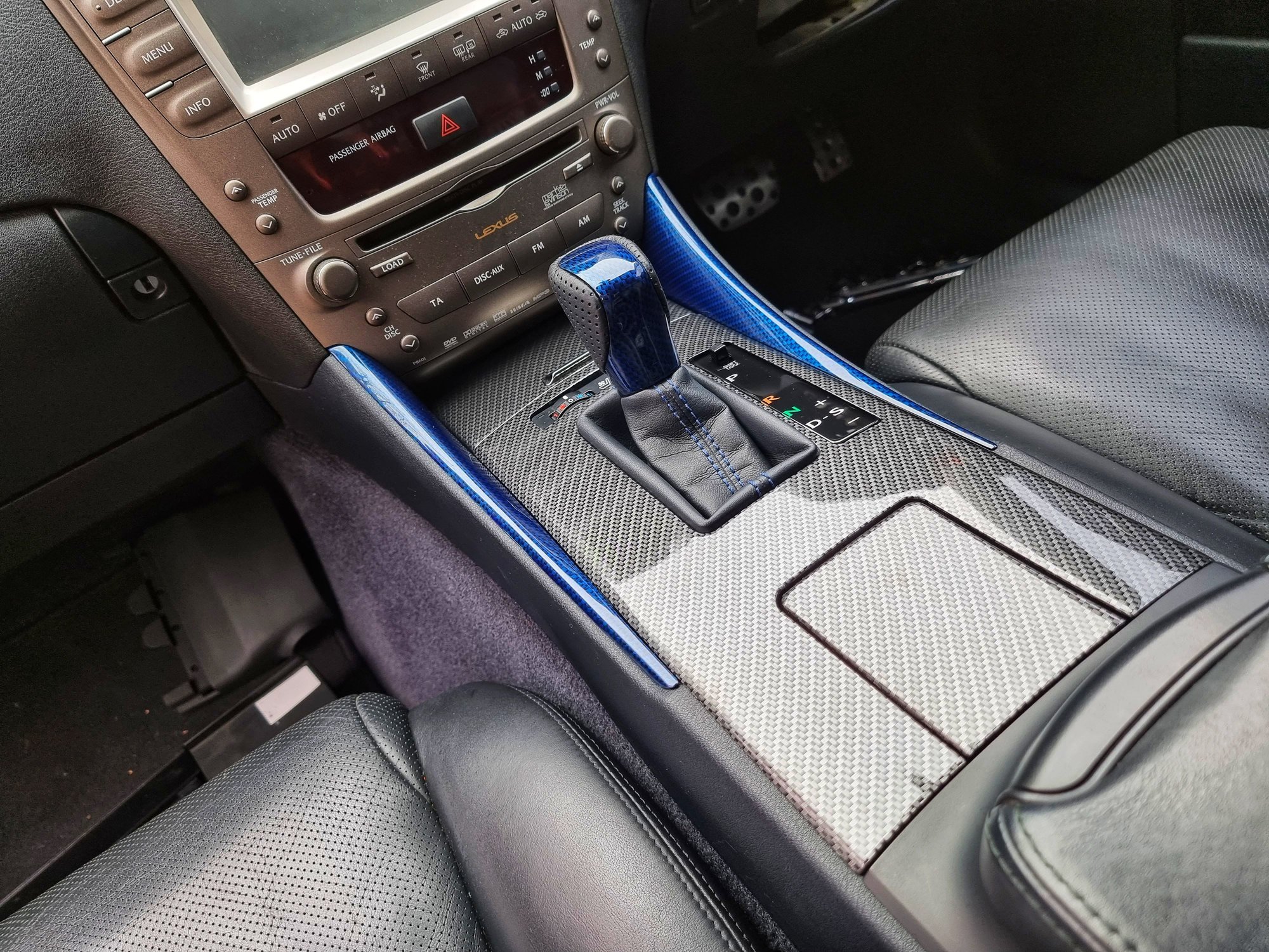

I recently fitted the 3IS gear-**** and boot on my 2006 IS250 and also did someone else's or them. A few pics below. More info on the mod on my instagram page:

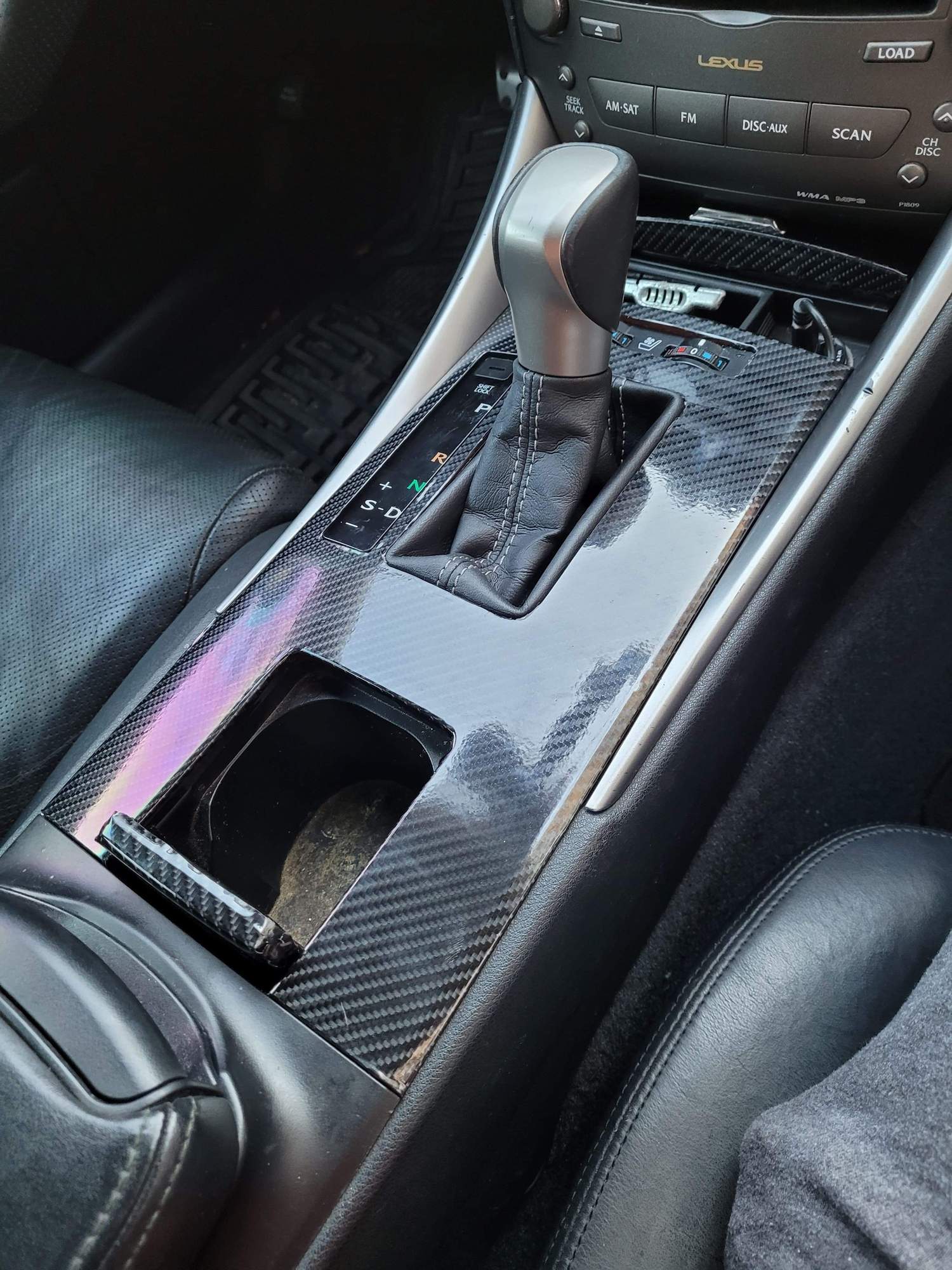

Also did the same thing with the 3IS shift boot after I saw someone else do it. You just cut a hole the size of the 3IS shift boot/frame with a dremel into the console. I used silicone to have it stay in place.

A few more pics of my gear boot below. I will create a thread with detailed pics and videos soon. I mounted the boot to the OEM frame and then it's a direct bolt on just like OEM. The frame just bolts in with the 4 screws from underneath.
