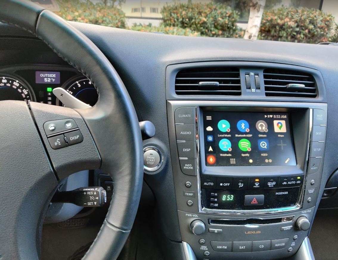

You are the man! You should consider installing (if you haven't already) a GROM VLINE VL2 to bring some modern features to the infotainment system. Google Maps, Android Auto/Apple CarPlay etc
