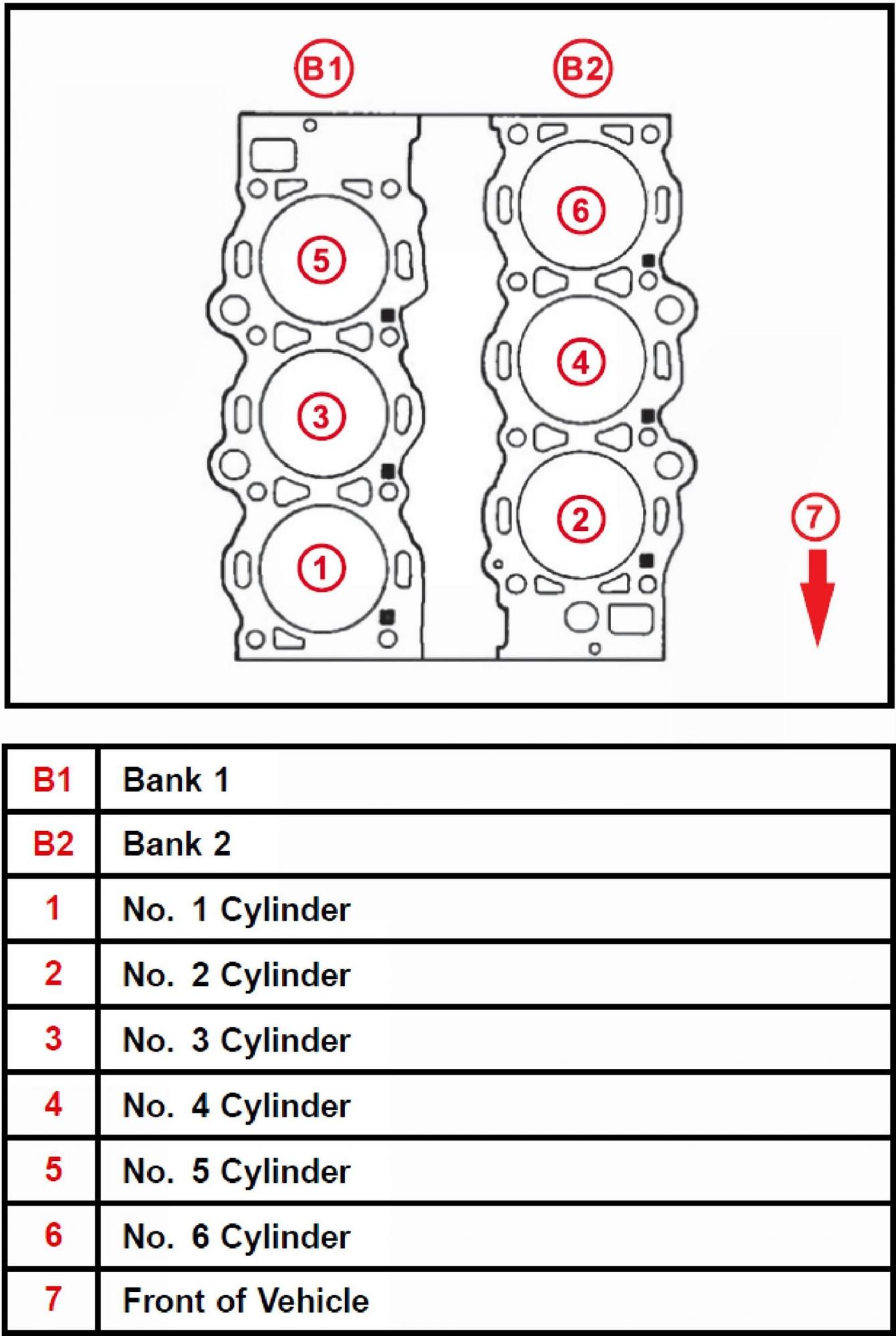

I thought p0037 bank 1 sensor 2 was the driver side sensor and p0038 was the passenger side?

Bank 1 sensor 2 is downstream post-cat, passenger right.
Driver and passenger side (post cat) uses the same part number.
