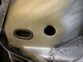

Been searching online for a while but cannot find the right terminology or part for this. On my IS is looks like there is a rubber plug missing on the underside (this is by the passenger side/front jack point).
Any help on finding a replacement? Trying to keep crud from getting back there.

BertoISF, believe the following items may be what your inquiring about;
90950-01959 Round body plug
90950-01956 - small frame rail plug
Additional body plug part numbers (unsure of location / size);Parts 90950-01527 & 90950-01518

From: IN
unfortunately it's not round. Its oval-ish. I'll look at those other 2 PNs though.

My apologies, believe part 90950-01527 to be Hood bumper. Part 90950-01518 may be correct oval plug;

I rolled back under the car.
my mistake. It was a round plug. I pulled the plug off the hole next to it to try and it worked. Its PN is 90950-01710. I'll have to try and dig that up.
