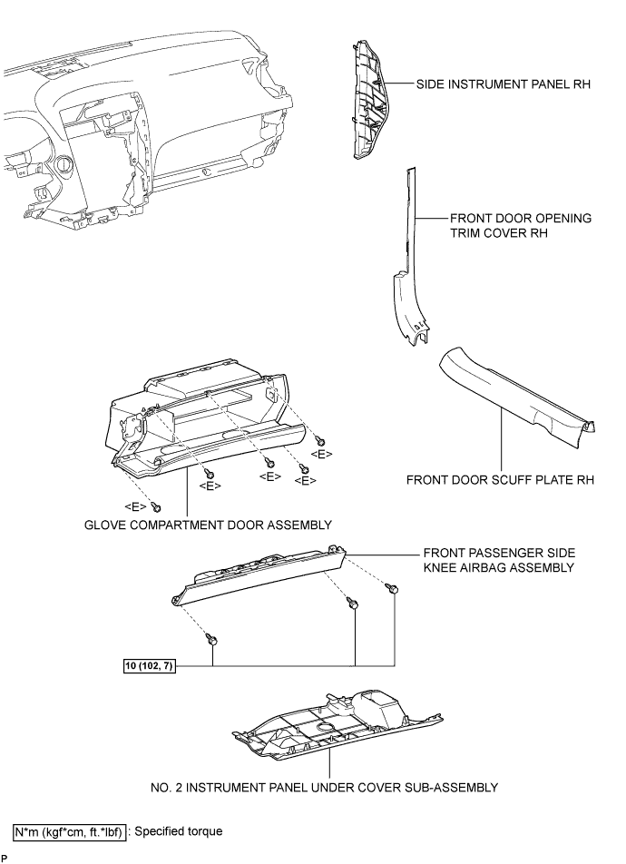

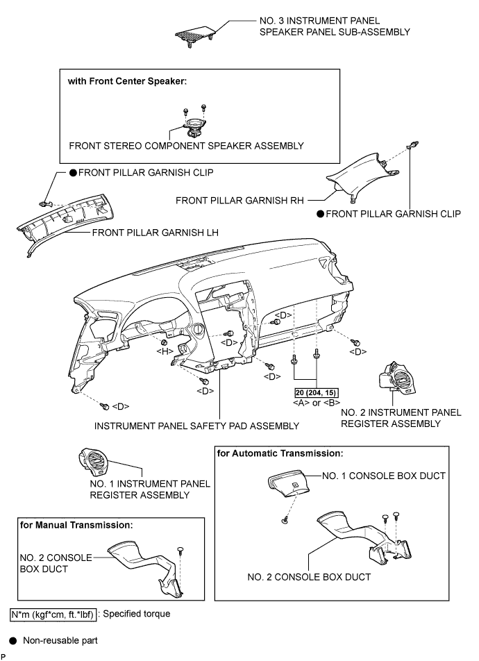

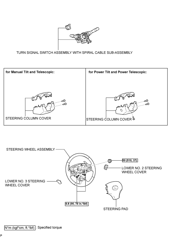

Anyone in the Dallas Texas area help with replacing my dash on a 2006 IS350? I've got a replacement one but think it will be a bit over my head to do by myself.. I will pay $$$ for assistance.. Thanks let me know.

Appreciate all the info I’ve seen the charts and video as reference but still not confident enough to do this on my own though..lol
