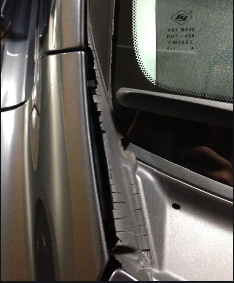

I need help with the name of the molding between the windshield and the hood. I dont know what its called I ordered something of ROCKAUTO. seems like its the side molding strip and not the bottom one.

It’s called a cowl.

75551-53020
75552-53020
These are the part numbers from when I bought new ones for mine. I dont know which part number is for what side. There some clips youll need to buy. I bought the clips from amazon I think it was like $20 for 10 clips (there are 5 clips each side). Im pretty sure I remember looking up the price for the clips at lexus and it was like $5 each clip

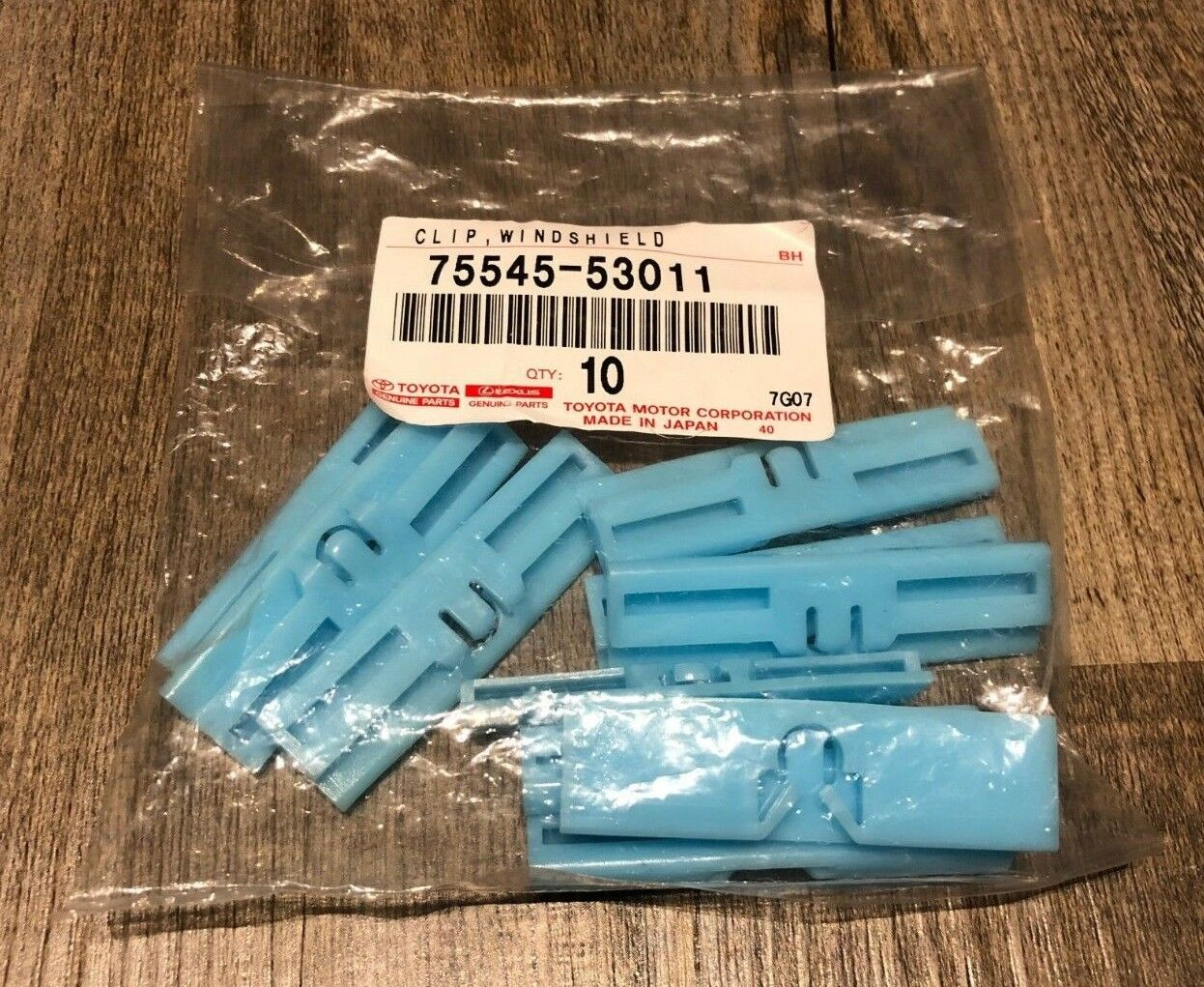

He was most likely quoted for the wrong item. At best those windshield moldings should be $50-60 per side. The clips can add up in price if you grab original Lexus clips, believe they retailed for $4 a piece (you need 10 total). You can buy generic ones, but I know a few here, including myself, have had issues with them staying locked in to the molding. They should absolutely be replaced when you replace the moldings.
Clips: 75545-53010
LH molding: 75552-53020
RH molding: 75551-53020

Reinhardt Lexus;
https://parts.reinhardtlexus.com/p/6...555153020.html
7555153020 - MOULDING, ROOF DRIP SIDE FINISH, RIGHT
7555253020 - MOULDING, ROOF DRIP SIDE FINISH, RIGHT
7554553011 - CLIP, WINDSHIELD OUTSIDE MOULDING (need total of 10, 5 per side)
Believe part 7554553011 now supersedes 75545-53010

try ordering from Bell Lexus in AZ, they (along with a few other dealers online) are offering free shipping for order of $75+ right now.
The moldings are $45/each and the clips look to be $5 for that P/N above (not sure if its for 10 or 1 clip).
May want to call them about that.
