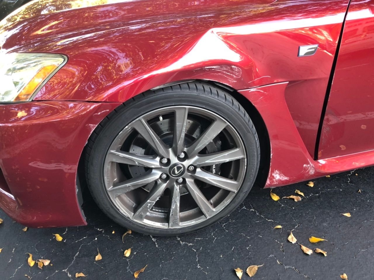

Not lowered, completely stock
Only thing replaced was wheel (bent beyond repair)
Even after adjusting subframe, no change in pull.
