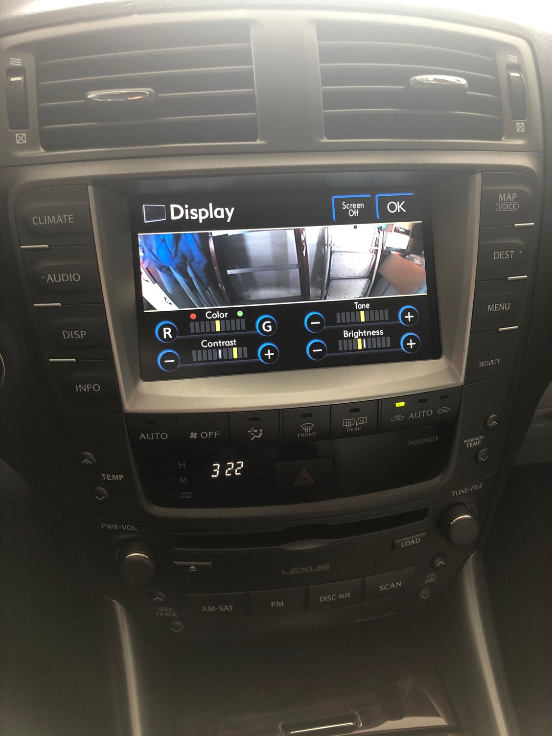

You can change some settings to the screen. By pushing the display button on the left side. Doesn’t make much of a difference IMO but maybe this might help making it clearer

^^^ Interesting, I don't think my '08 has color or tone adjustments as yours shows.
It has to, you should get the options by pressing display button. One option is screen off and there is another to adjust screen settings like above. But makes no difference to camera quality
Yeah, you're right. I looked earlier today when I was in reverse; I guess I never thought to adjust the display settings when in reverse...
