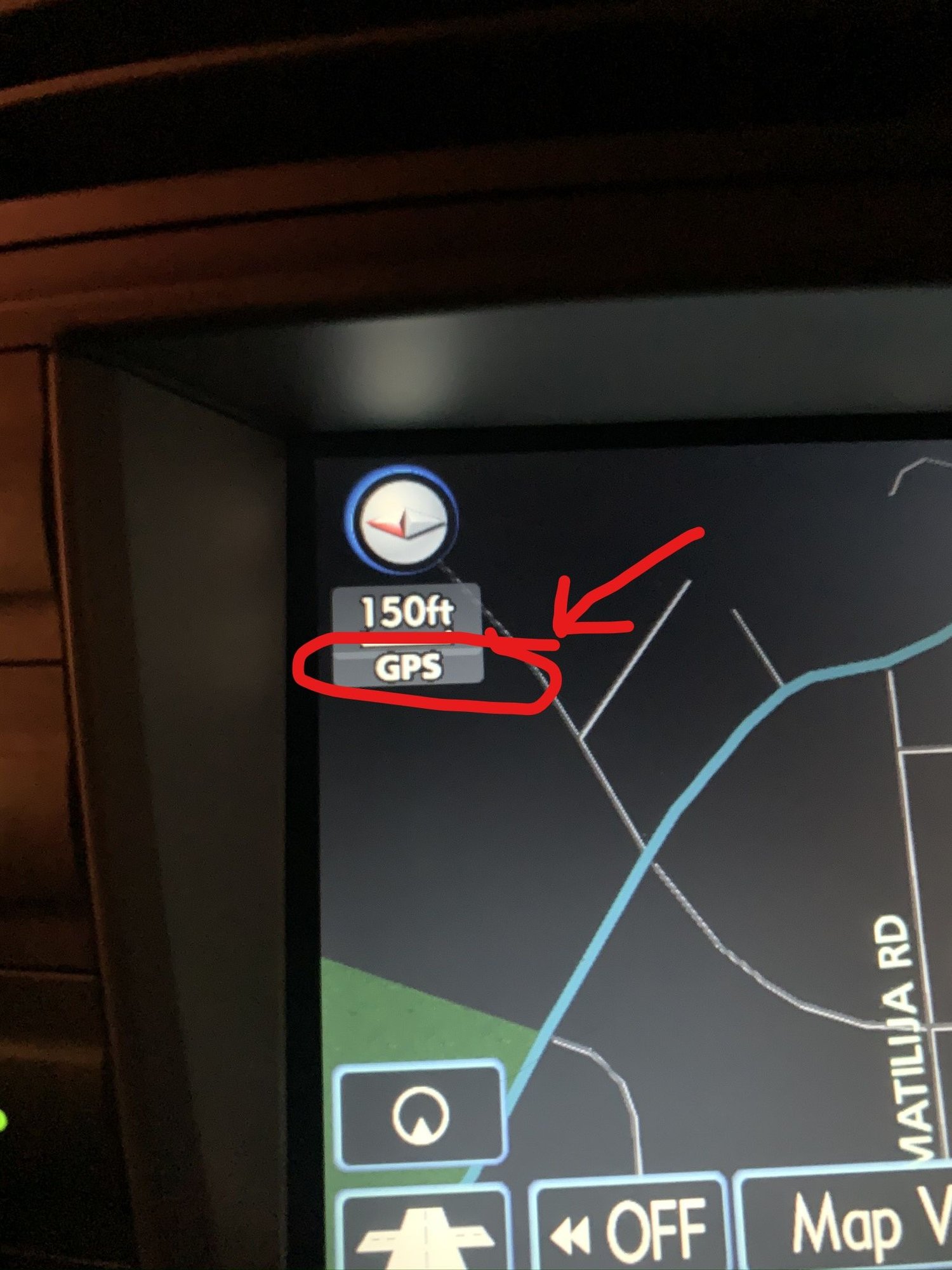

Solved. Thanks for the responses. Yes, it was the black wire, gray connector. Once I did that the "GPS" under the compass came back and it is perfect. If the cable isn't connected the "GPS" is not there.
