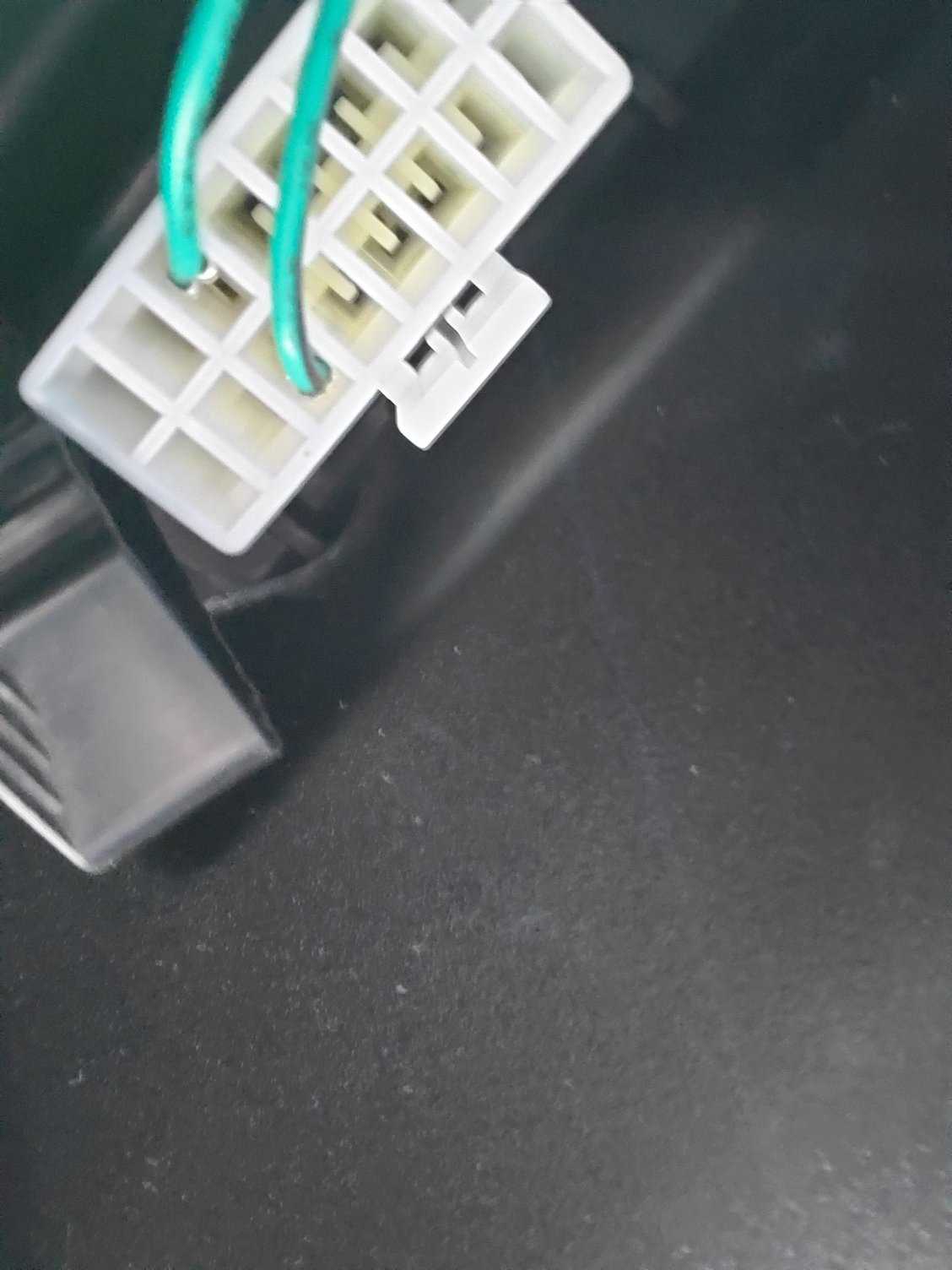

Originally Posted by BabyGate
It has been a year since I installed it. Other than the radio frequency offsite issue, the unit has been working great.
How is your backup camera connected? I assume the video input of the camera is connected to the Rearview input (#9). If you still don't see video, I would make sure the camera actually works and can produce video first. You can connect the camera to the Video input (#6) and open up the Aux app to check if there is any video output for the camera.
The shop tested my cMera with they headunit. It works and they tested they camera on this android head unit. The same no signal.

If the camera works, then I am not sure what the issue is. Maybe try flash a newer firmware. Talk to your seller and ask them about it.

Thanks guy. Finally got it work it was plugged in number 7 i changed it to number 9
