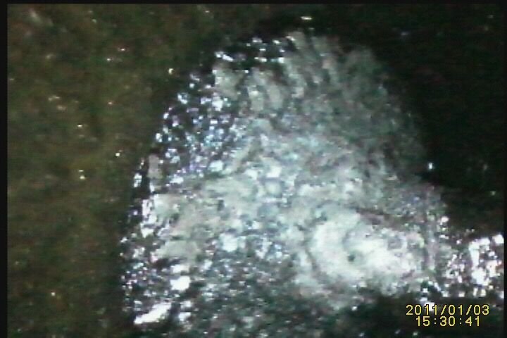

I brought our borescope home from work and wormed it through the brake booster vacuum line nipple to check a valve or two. YIKES!... (never have set the clock on the scope)
Well looks like some work to do.

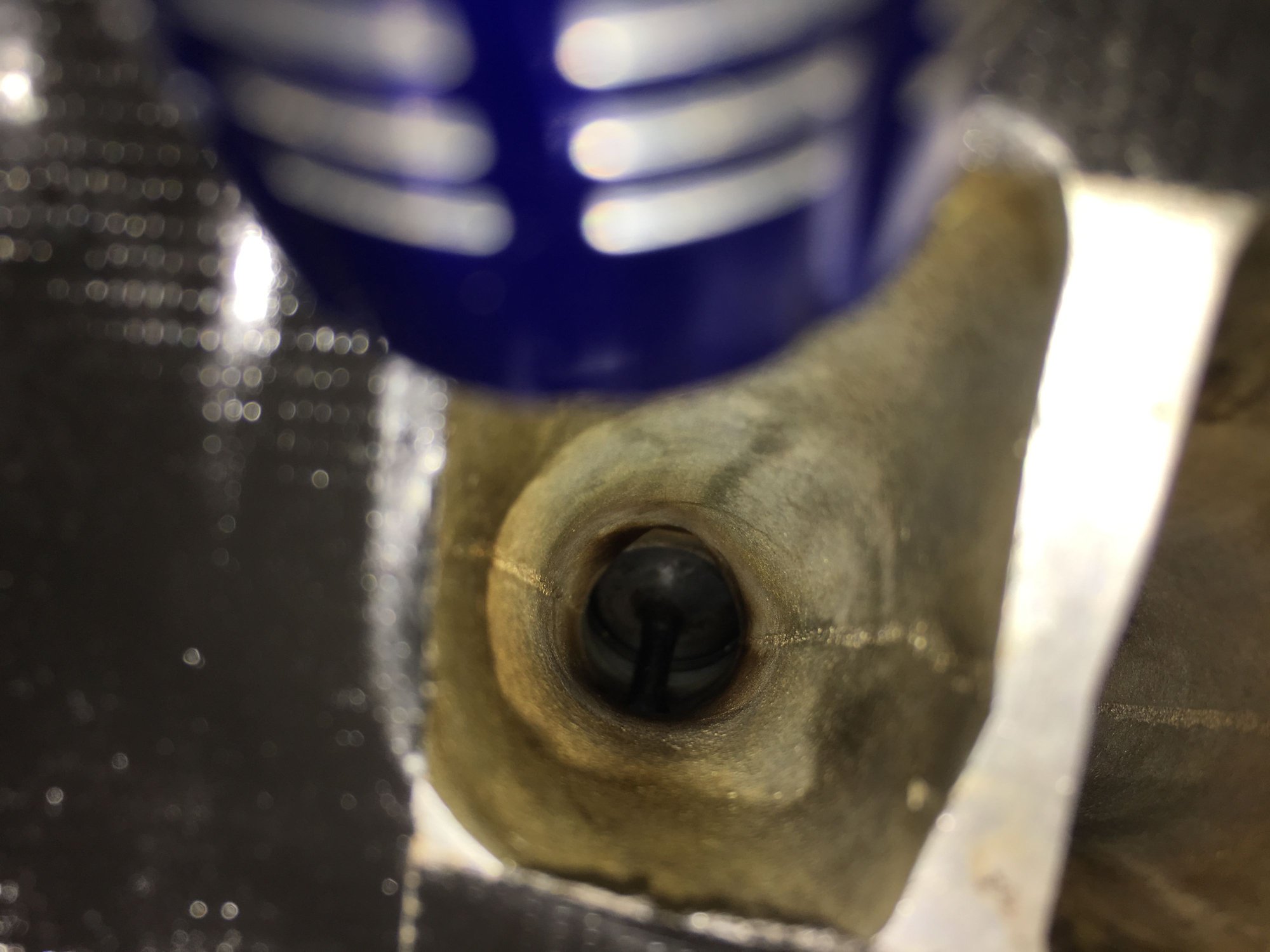

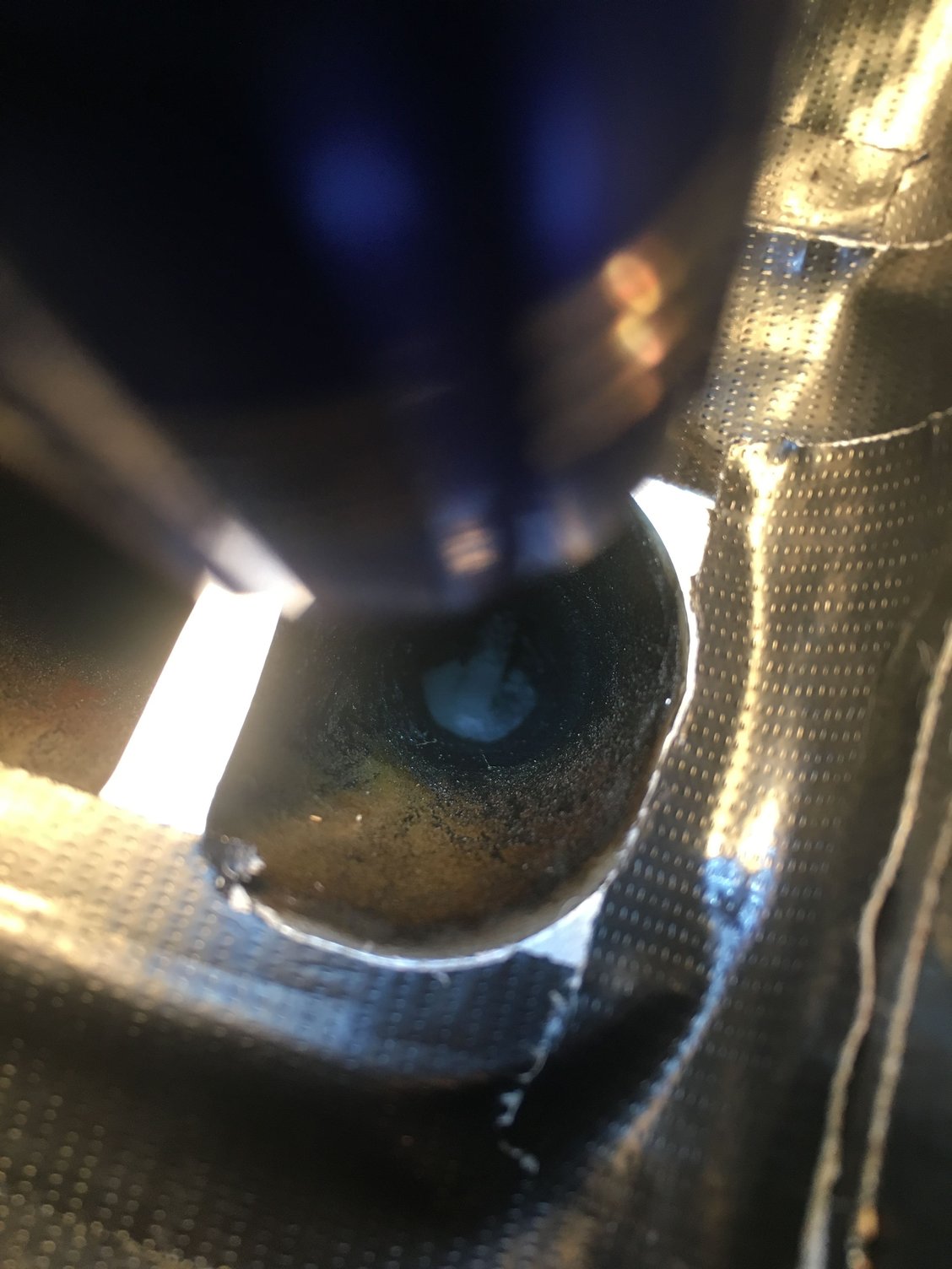

Added an aluminum tube extension to the pistol to reach into the ports:
I used a piece of plastic sheet with a 2X3 inch hole to duct tape to each port so the shells and dust wouldn’t get everywhere. Even though I had an industrial shop vac sucking next to the blaster wand in each hole, it was messy. Wear safety glasses.

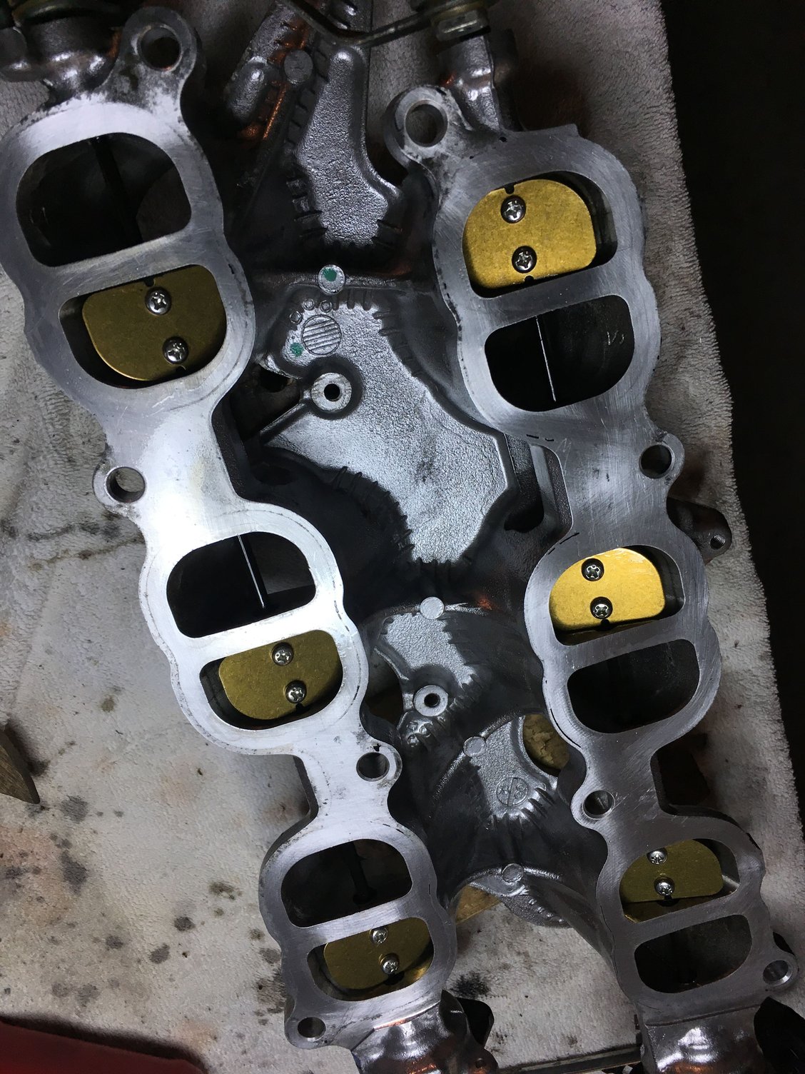

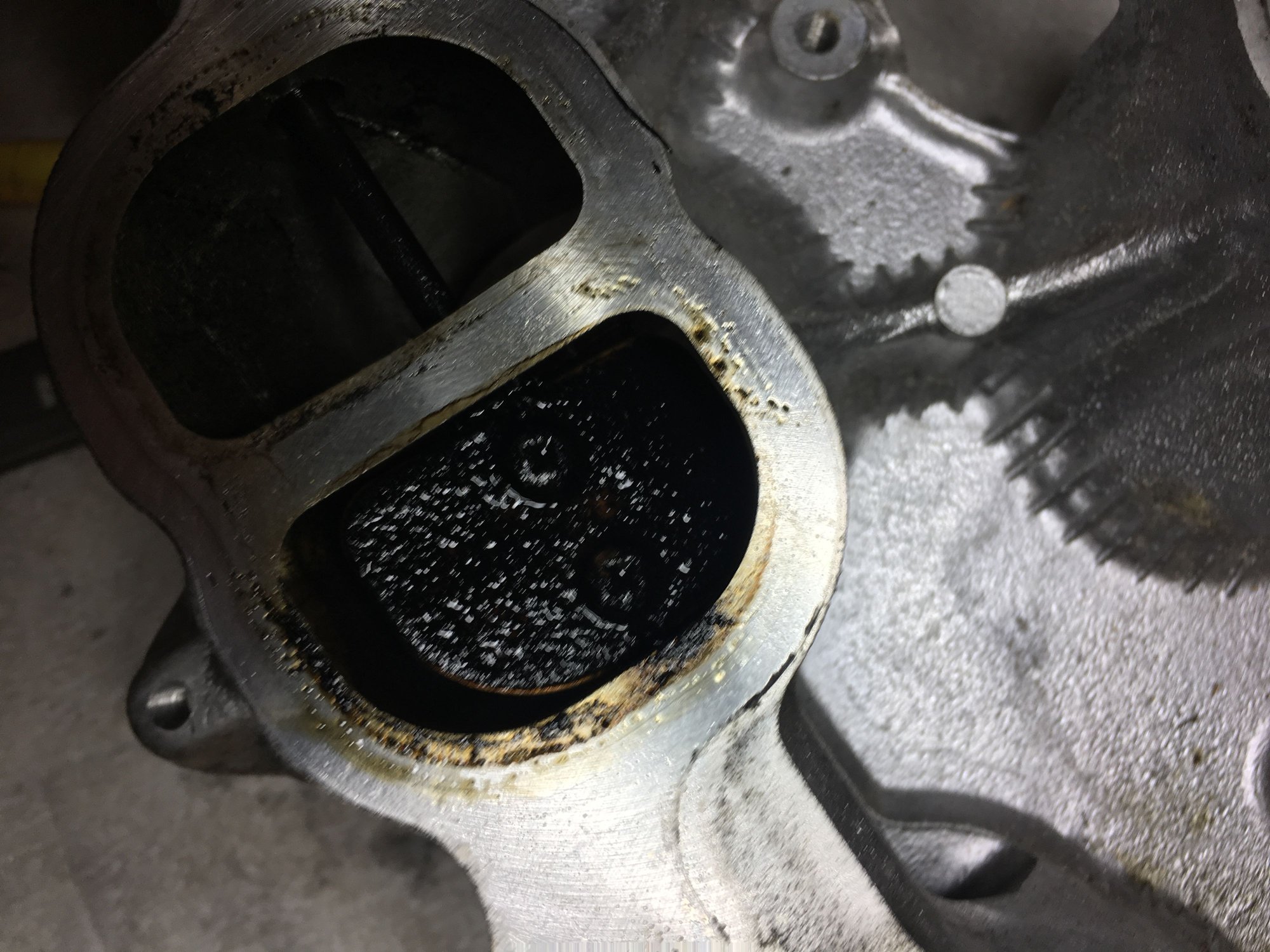

There is a piece between the intake manifold and the ports in the head. It has a butterfly over one of the valves for each cylinder. My guess is it opens to the second valve when you go wide open or really need it.
here’s a shot of before and after of that piece:

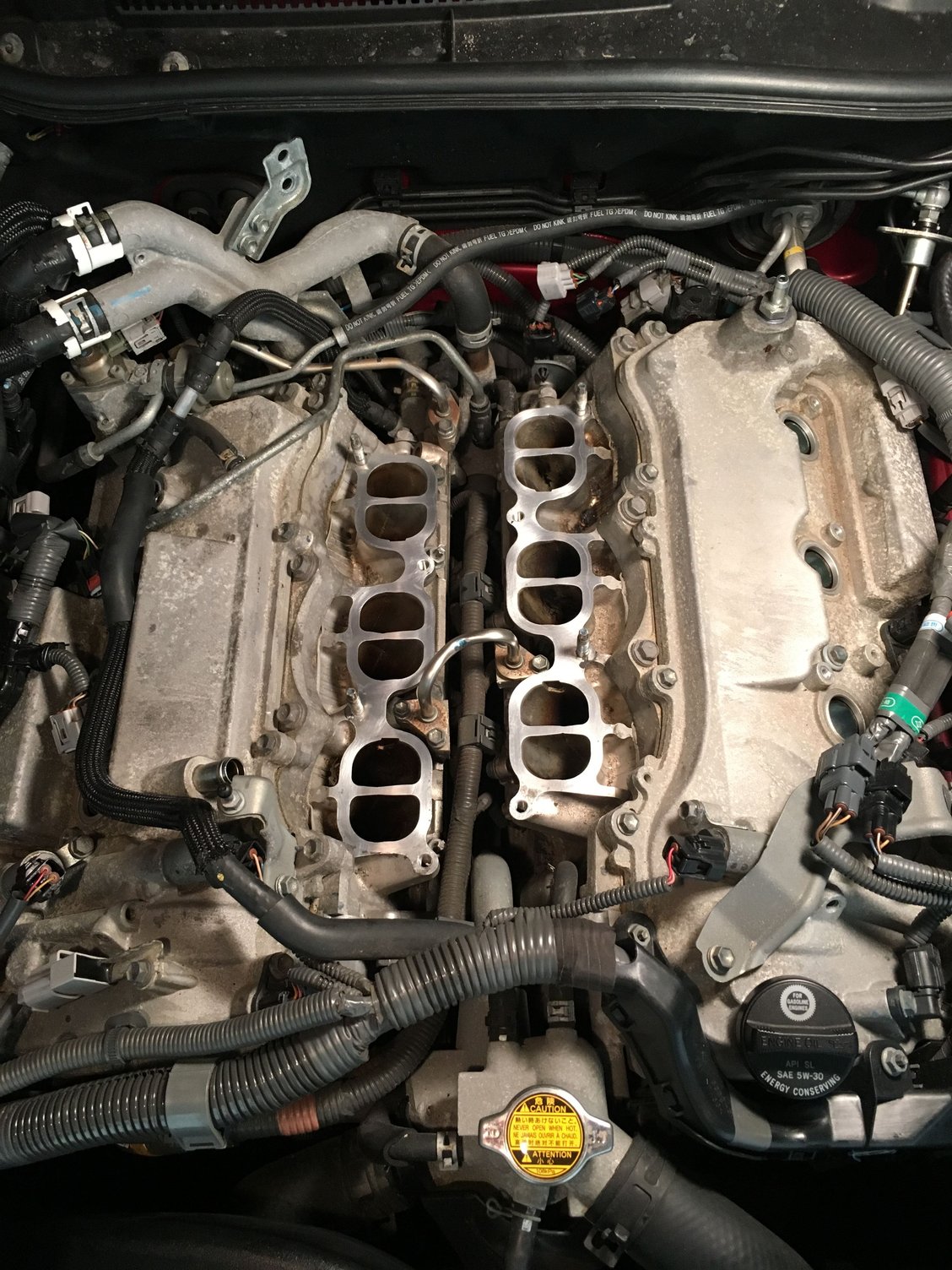

Here are a couple shots of the actual ports and valves before and after plus the engine opened up:
Took about 30 minutes per port to move plastic and blast. A couple valves needed some carb cleaner and small stiff brush to get it clean. The fire order is 123456 and a wrench on the crank and the plugs out, you can find TDC easy enough to be sure they are closed.

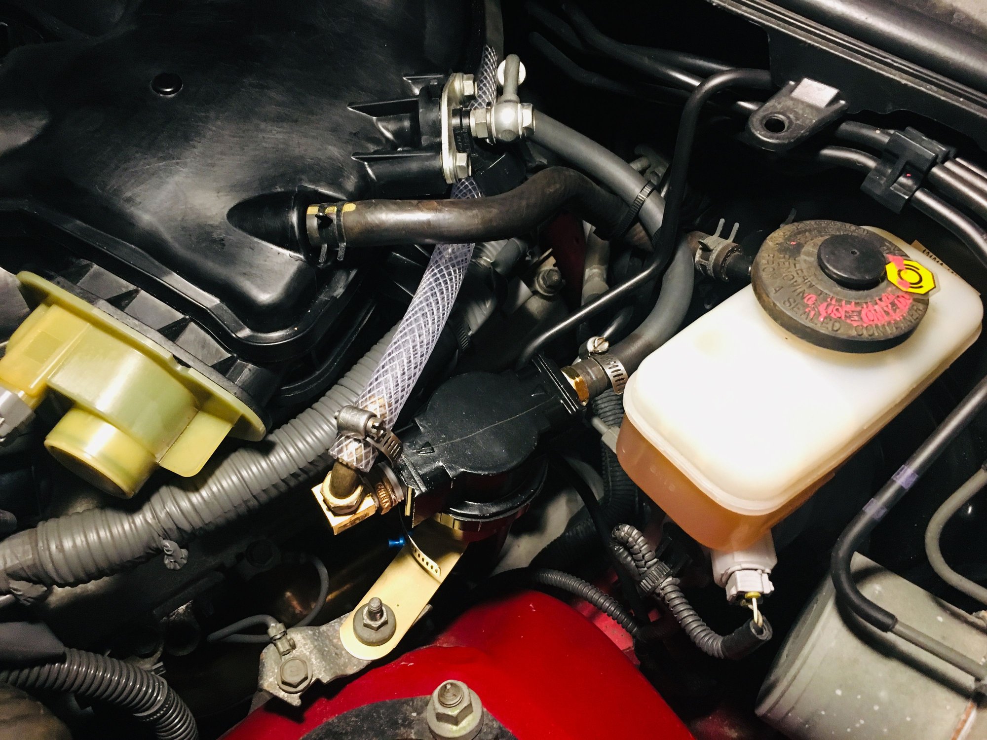

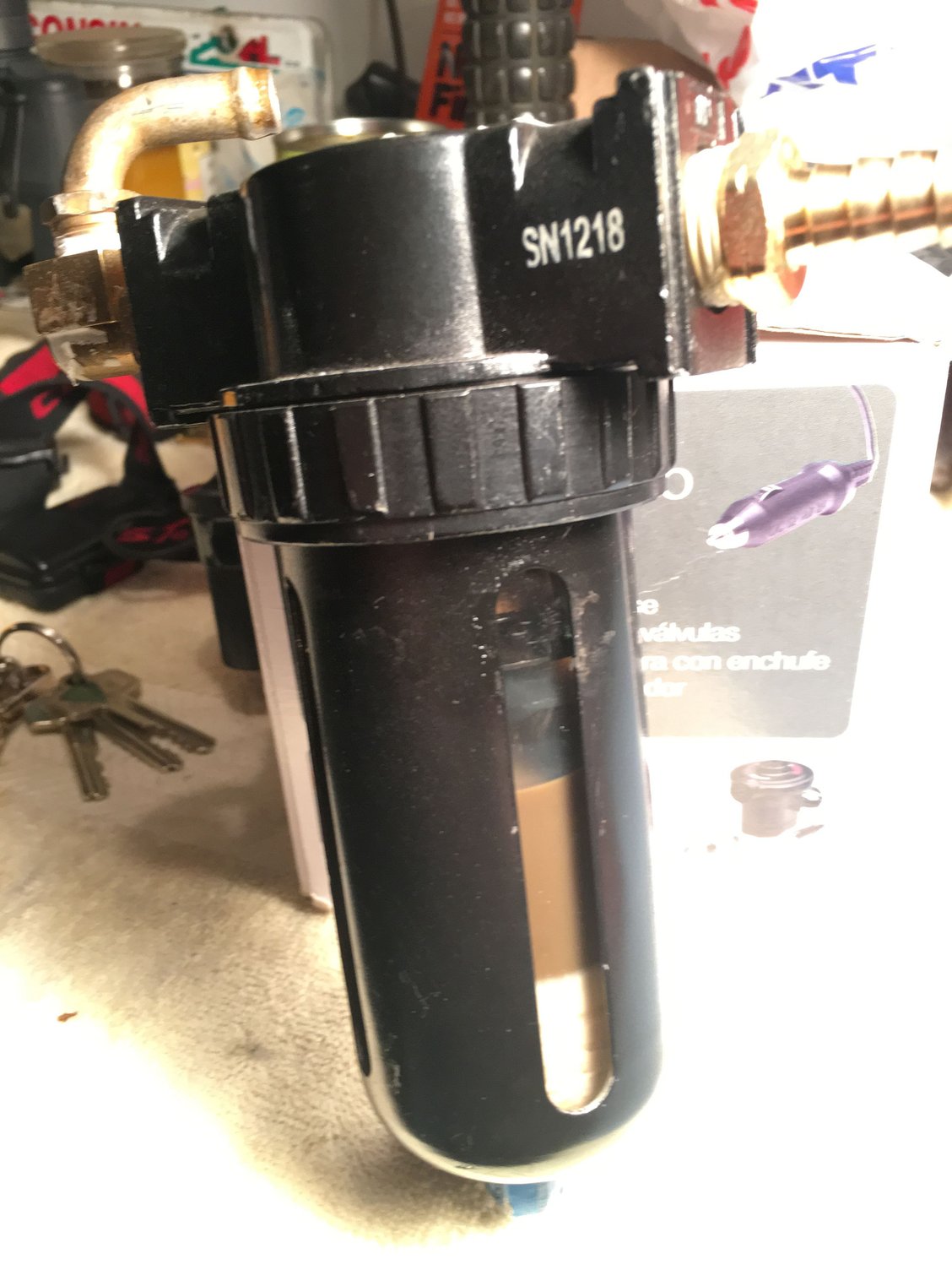

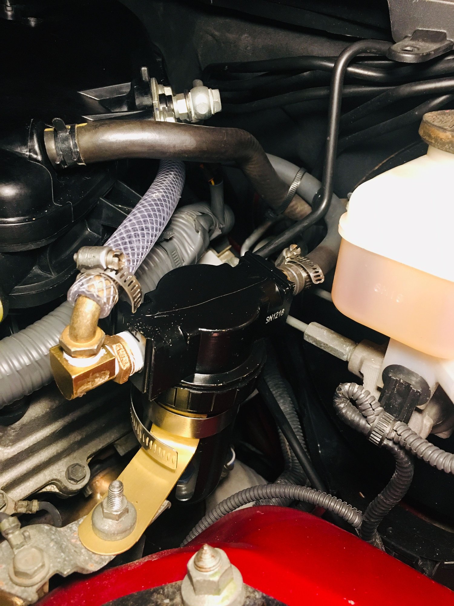

Put the low budget oil catch can on today.
used the Home Depot Air compressor water separator to start.
https://www.homedepot.com/p/Husky-3-...03AV/100040942

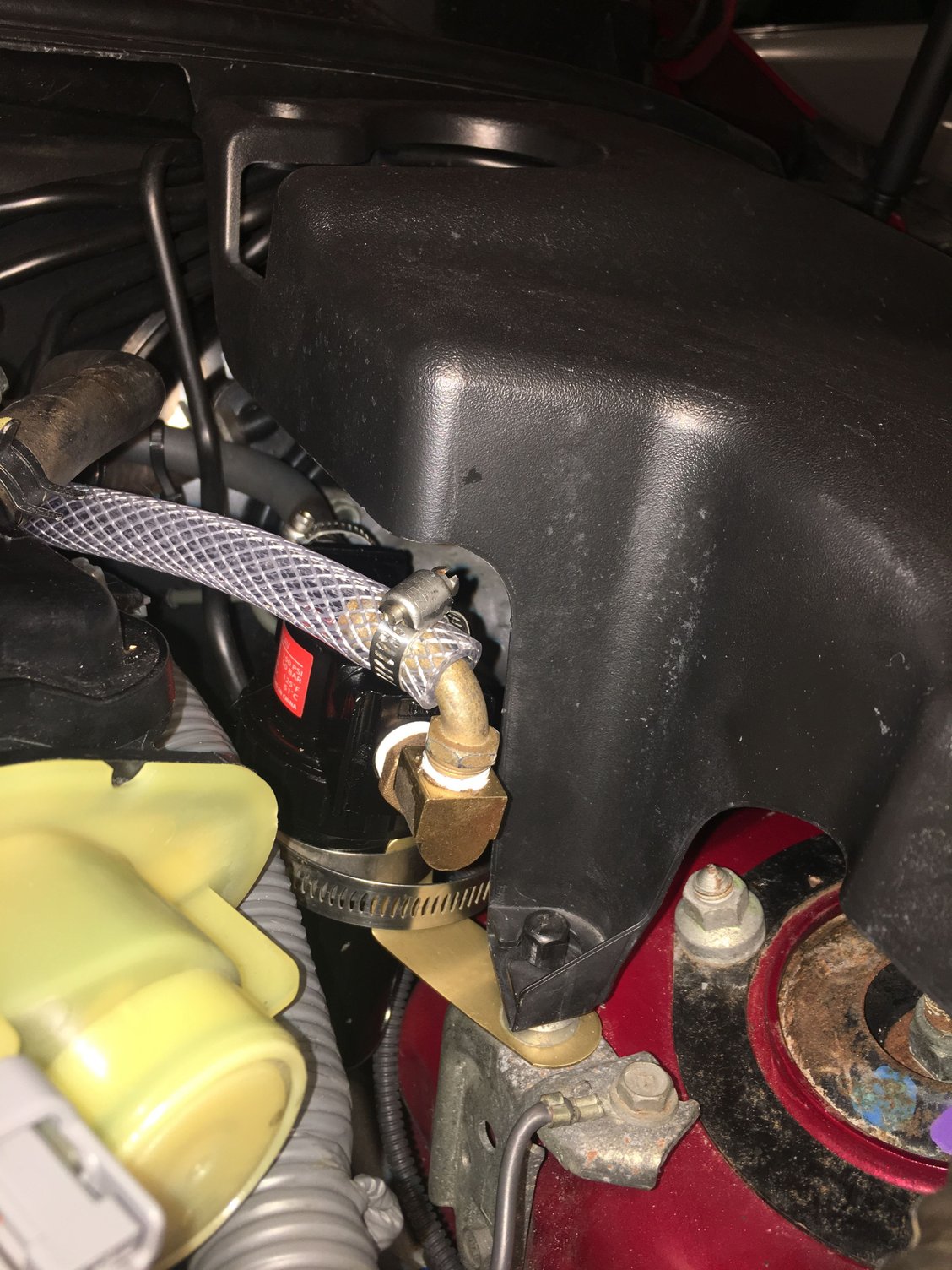

Changed out the drain with aircraft fittings and cap.

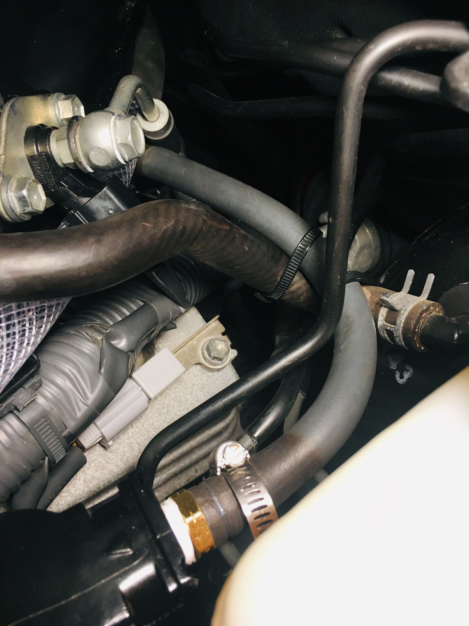

I was able to use the original hose from the PCV valve to the inlet and used some stiff vinyl to the intake manifold so I can see if any oil is going past.
my location fits good with the sight shield too.
The separator has fins to sling the incoming air/water to the outside and then it has to pass a baffle and finally a sintered bronze filter before exiting.
I'm not sure how well it will work but if it catches 50% of what normally goes into the manifold, I can go 125K or more before the next cleaning.
Here are a couple pics, I’ll update how it works at the next oil change.

My only fear is that the moisture created from combustion and blow by will freeze on the sintered brass filter and block the PCV and vacuum to the intake manifold. Gets real cold here sometimes.
I did leave the line from the right valve cover that goes to the intake snorkel prior to the Throttle Body so if the trap does plug up, it shouldn’t blow any seals or valve cover gaskets cuz it’s still vented on the low vacuum side.

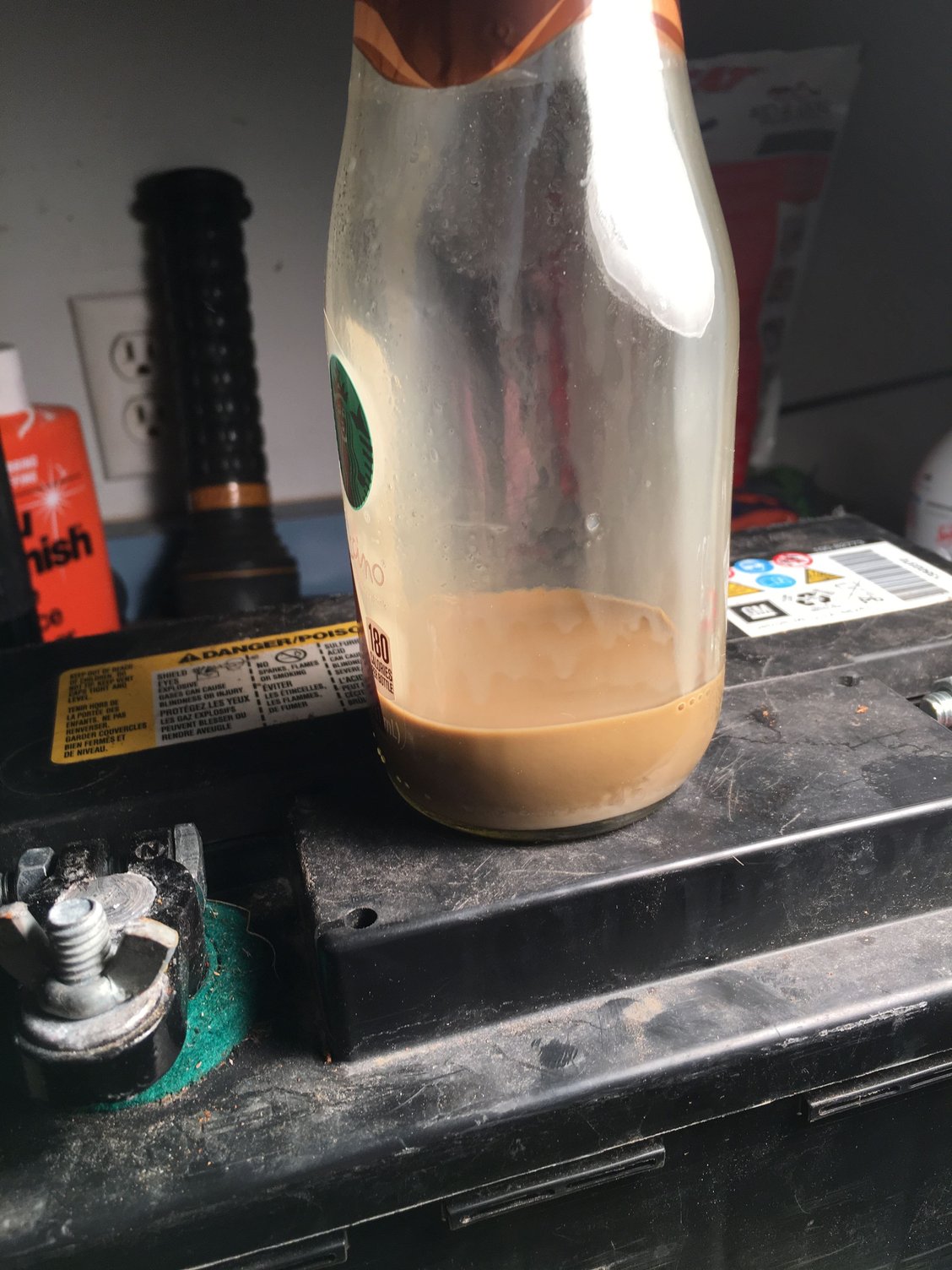

Update on the catch can after 4000 miles:
i emptied at 1500 miles and got half a cup of crap out.
most was thin and watery but would not freeze. The rest was oily slime that looked more like what I expected.
Went another 2500 and it was over half full.
it has become obvious that I cannot go the full 5K miles between oil changes without emptying half way.
Unfortunately I’m going to remove the catch can because this is my daughters car and she lives far enough away that I will not be able to keep up with it. I put the PCV hose back the way it was after removing the can.

I thought it was mostly water too but after a week in the deep freeze it didn’t even get slushy.
I’m guessing it’s fuel and additives although it doesn’t readily ignite.
