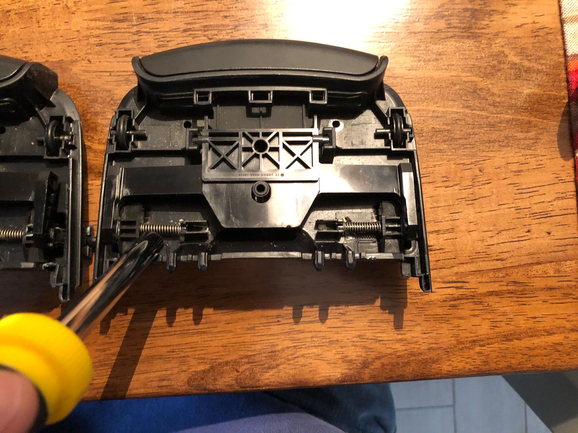

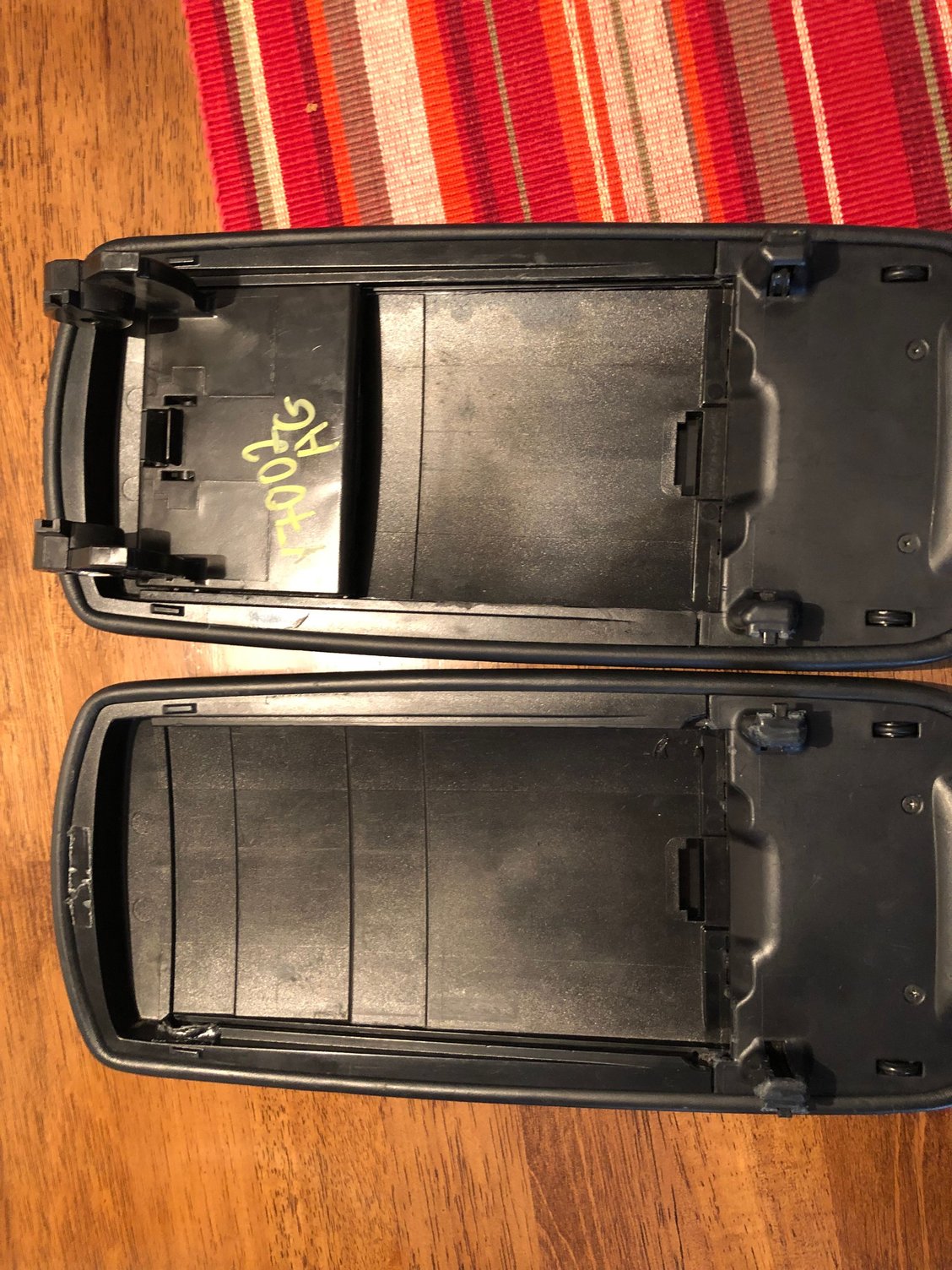

So if you just wanted to change the top of the arm rest you can remove the two screws in the underside that attaches the latch mechanism. Then slide the top rear wards and off.

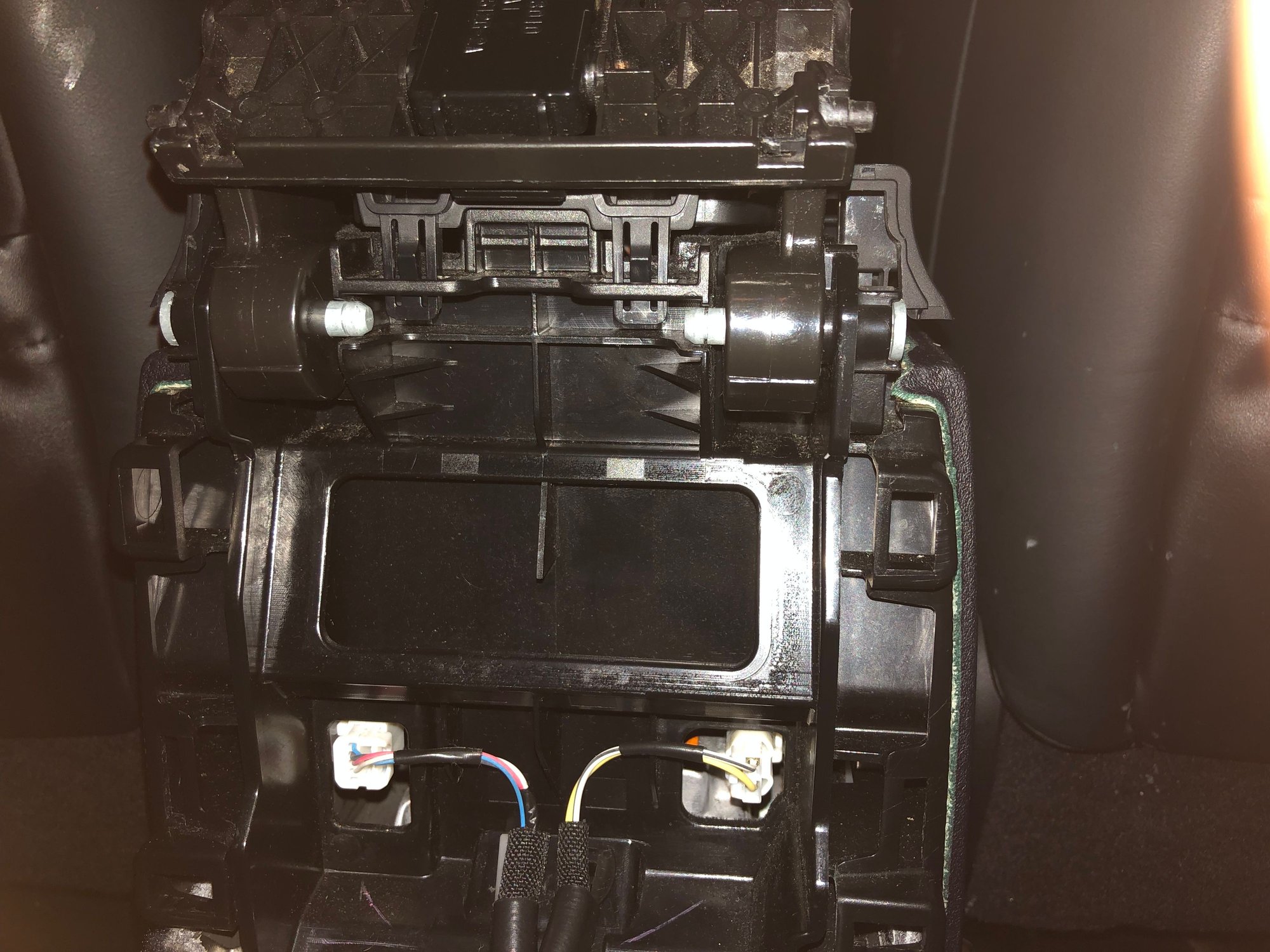

In my case the pivot part was missing the spring loaded bushings that ride in the track. So I also needed to replace the piviot.

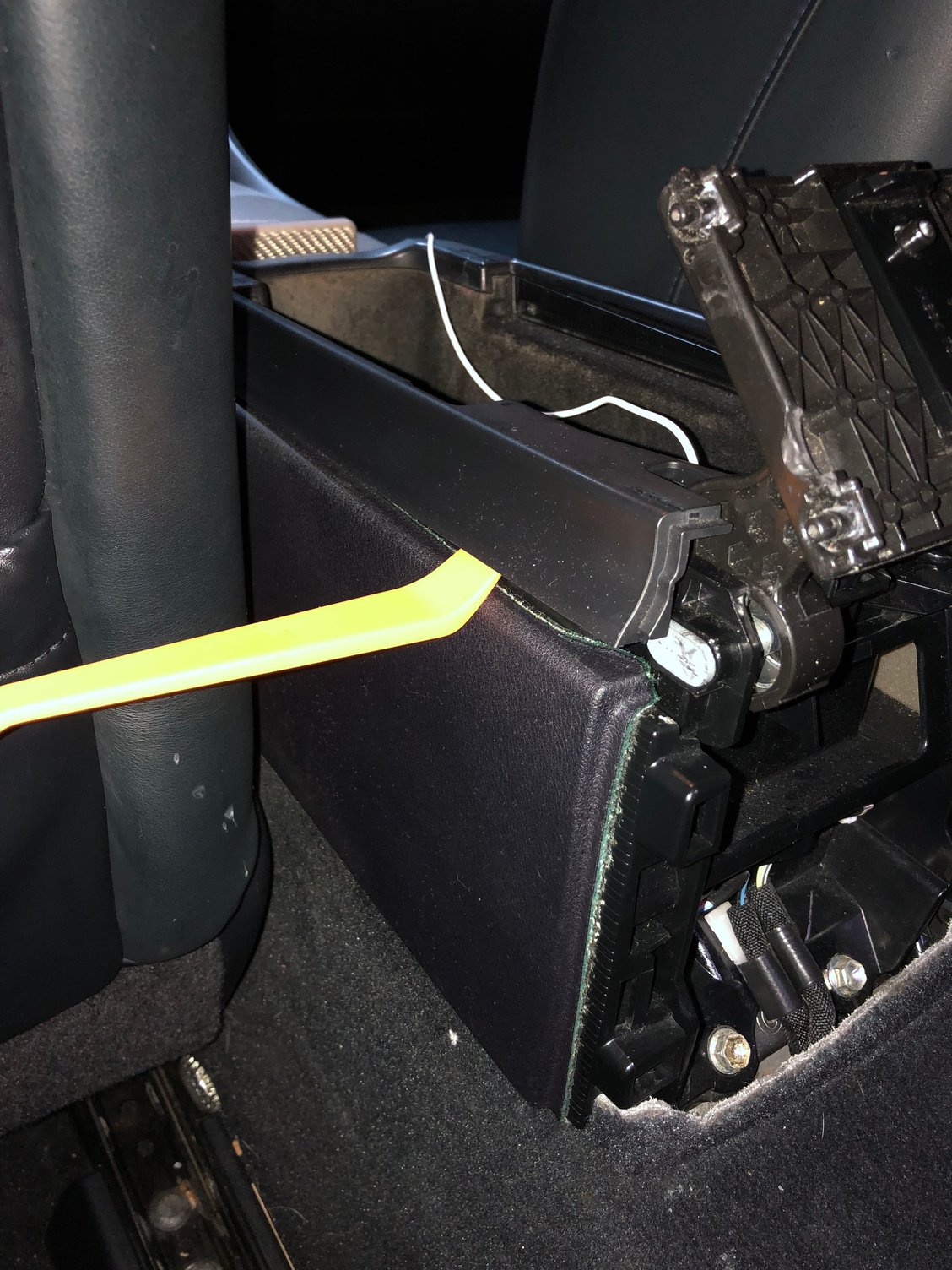

To to do that you need to remove the rear vent and pry up the trim.
Next pull out the metal piviots. They are being squeezed by a metal clip so significant force is needed.
