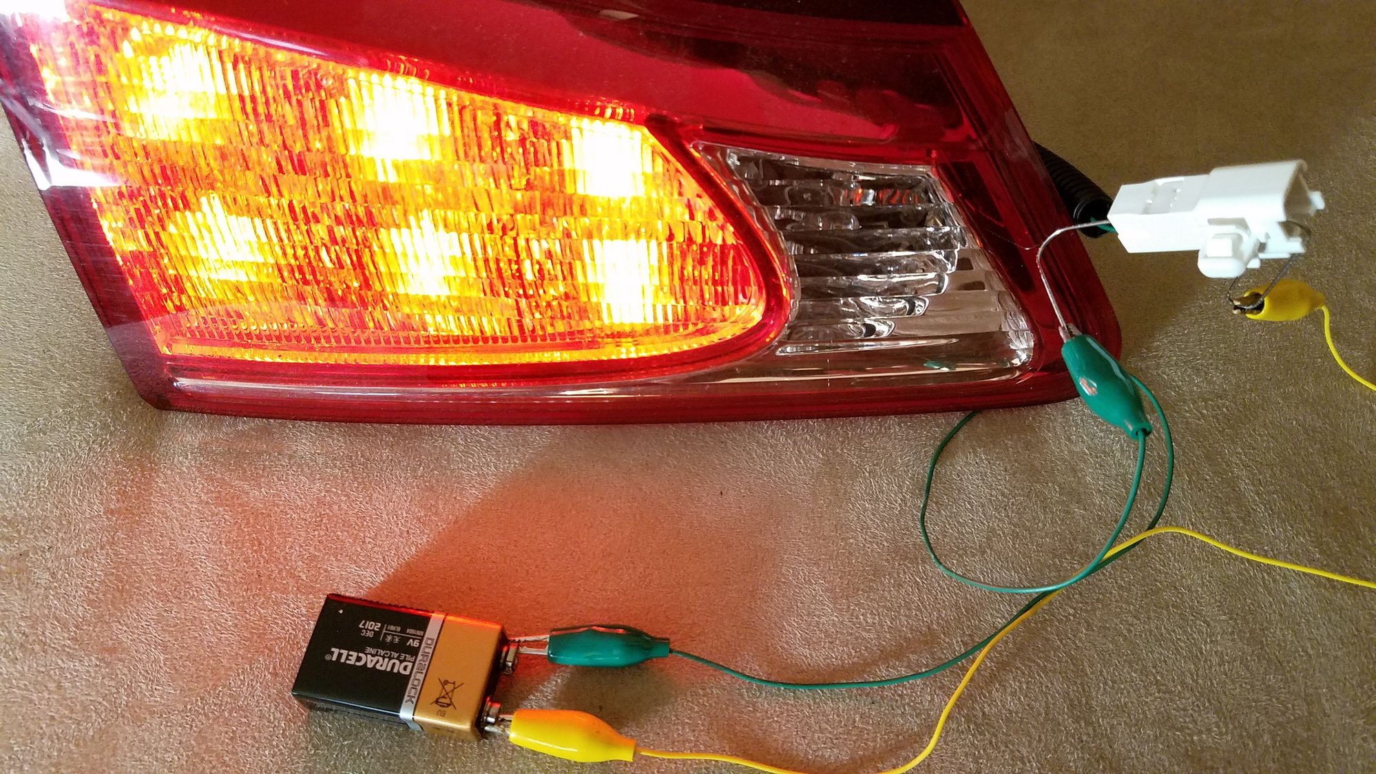

They make a special tool to pop the inner liner fasteners out, in a pinch a 90° pick tool pops them too.
Once you find the plug to those lights a fresh 9v battery will light the LEDs in that little housing and IIRC yoda uses a black wire as ground. Just tape some small wires to the battery terminals and test away.
Like so!
