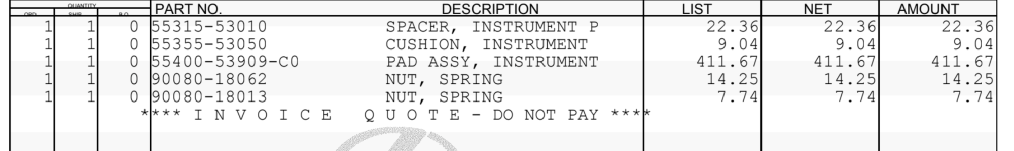

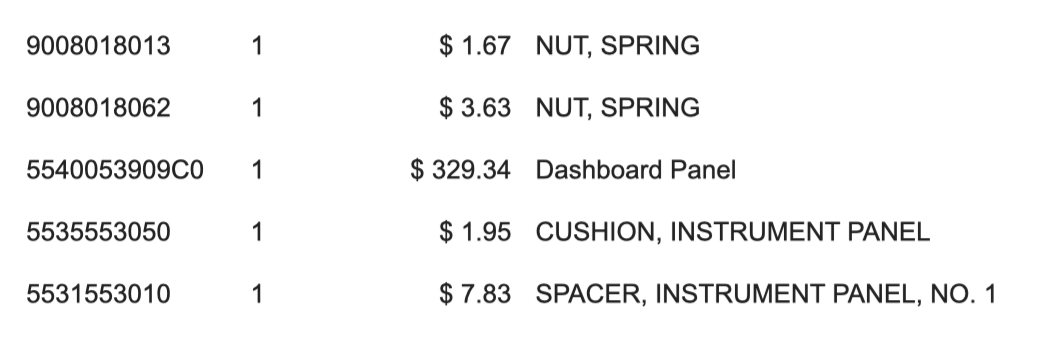

Just ordered a dash panel from my local Lexus dealer. They told me to use part number 55400-53909-C0. Will hopefully be replacing this weekend if the parts come in. Will update after the swap. Do note that placing the order online was cheaper than what they said on the invoice. All together it should cost about $344.42.
