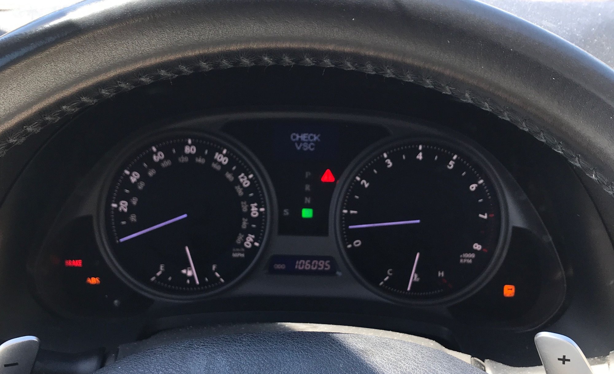

Hello,
All the indicators on my dash recently came on (stays on), so I brought my 2007 Lexus IS250 into Lexus for diagnosing (they charged me $180).
They found the problem to be:
# G BE92 Switch, Stop Light - Replace 193.90 *CHECK ENGINE LIGHT CAUSE*
And says it will be about $200.
Does this sound reasonable? What do you recommend?
The brake/stop lights (two side and middle lights) all currently still work fine.
Thank you so much for your input!
Dashlights On

Are your tailights staying on once the car is turned off?
Stop Light Switch is $13.15 on Rock Auto.com Beck/Arnley
It's an easy fix.
​​​​​​You brake pedal arm should make contact with the plunger. You'll have to look up under the dashboard.

The autozone link you posted is correct. It would be considered aftermarket. I assume denso should be OEM. As to why it would disable the cruise control using after market. Is beyond me maybe on that part. A wild assumption would be if it's not it the correct possition. The plunger would activate the brakes when cruise control is engaged.
The lights staying on after shut down is normal. My question was that if just the tail lights stay on by themselves. That's a clear sign of a failing stop switch. They would just stay on while the car it shut off.

In that case no, the lights work perfectly fine, turns on and off at the correct times! So, would you recommend that I buy the part and just replace it myself? Is there a chance that the dash still will not clear? Thanks!

It's up to you if you feel confident to change it. Just try to get a measurement of the plunger position before you remove it. Of how far it sticks out of it's housing. Then once installing the new one try to set it at that same distance.
Probably on YouTube you can find many tutorials. Honda's are notorious for this failure brake swich always going bad.

I had the same thing. All sorts of warning lights for no apparent reason. My shop read the codes and it required a new brake light switch.
The brake lights were working fine to my knowledge, so...

The switch looks to be the culprit.

They ordered me a new switch and the lights went away. I still have no idea what caused those codes to appear <br /><br />Whatever. Problem gone!
