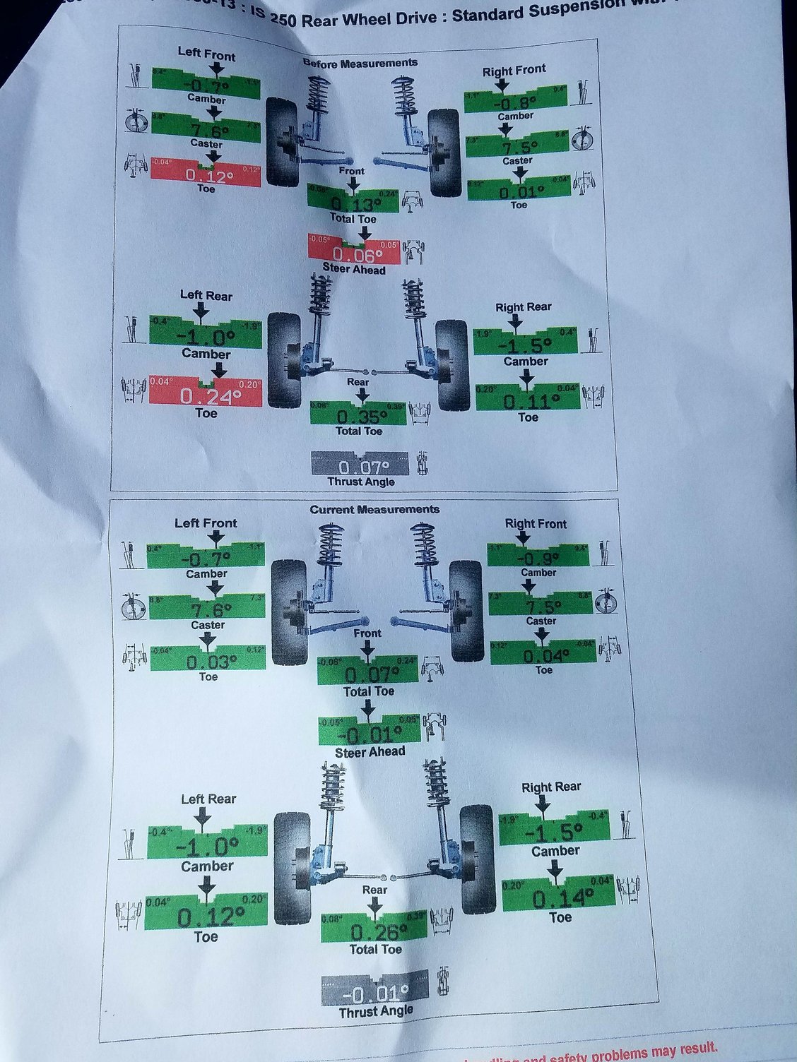

Here is my alignment adjustments from today and I had Michelin super sports on the fronts today as well
