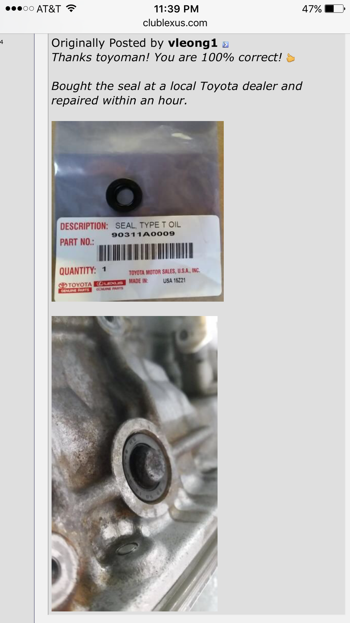

Sometime these seal above transmission also leak.
Ok i look into that also, Thanks

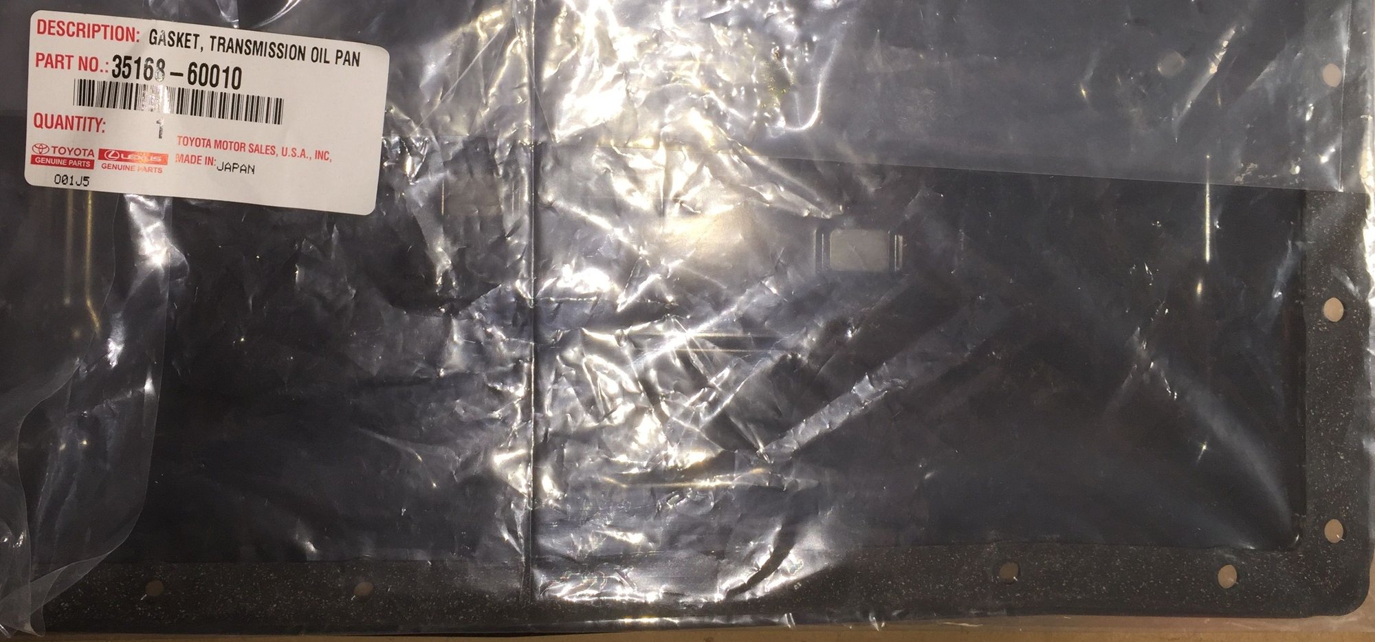

Torque for the transmission pan bolts is 39 in-lbs.
Here is a pic of the transmission gasket:
Cork-rubber?
Cork-rubber?
Yes look like Cork/rubber gasket on mine.
