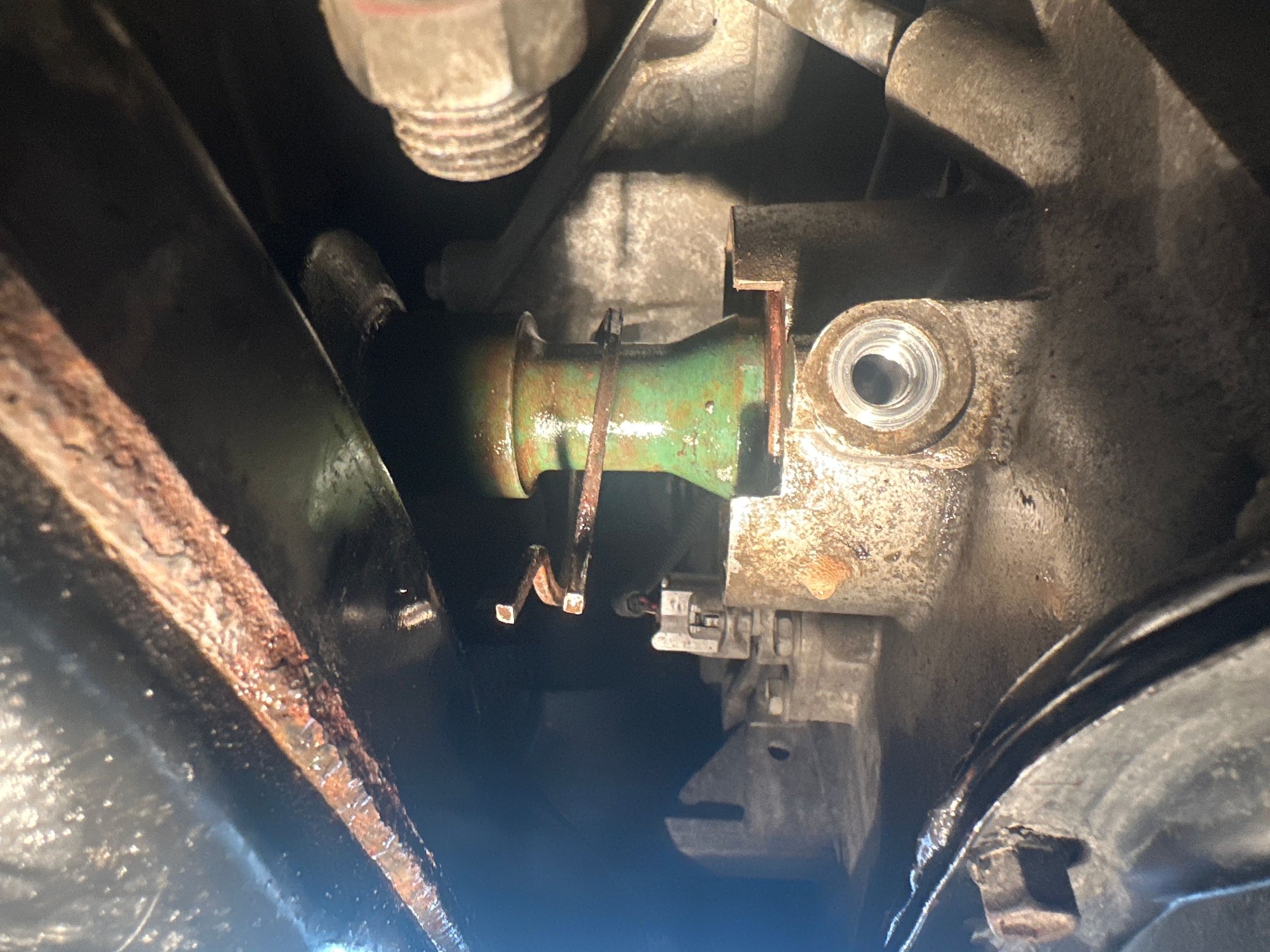

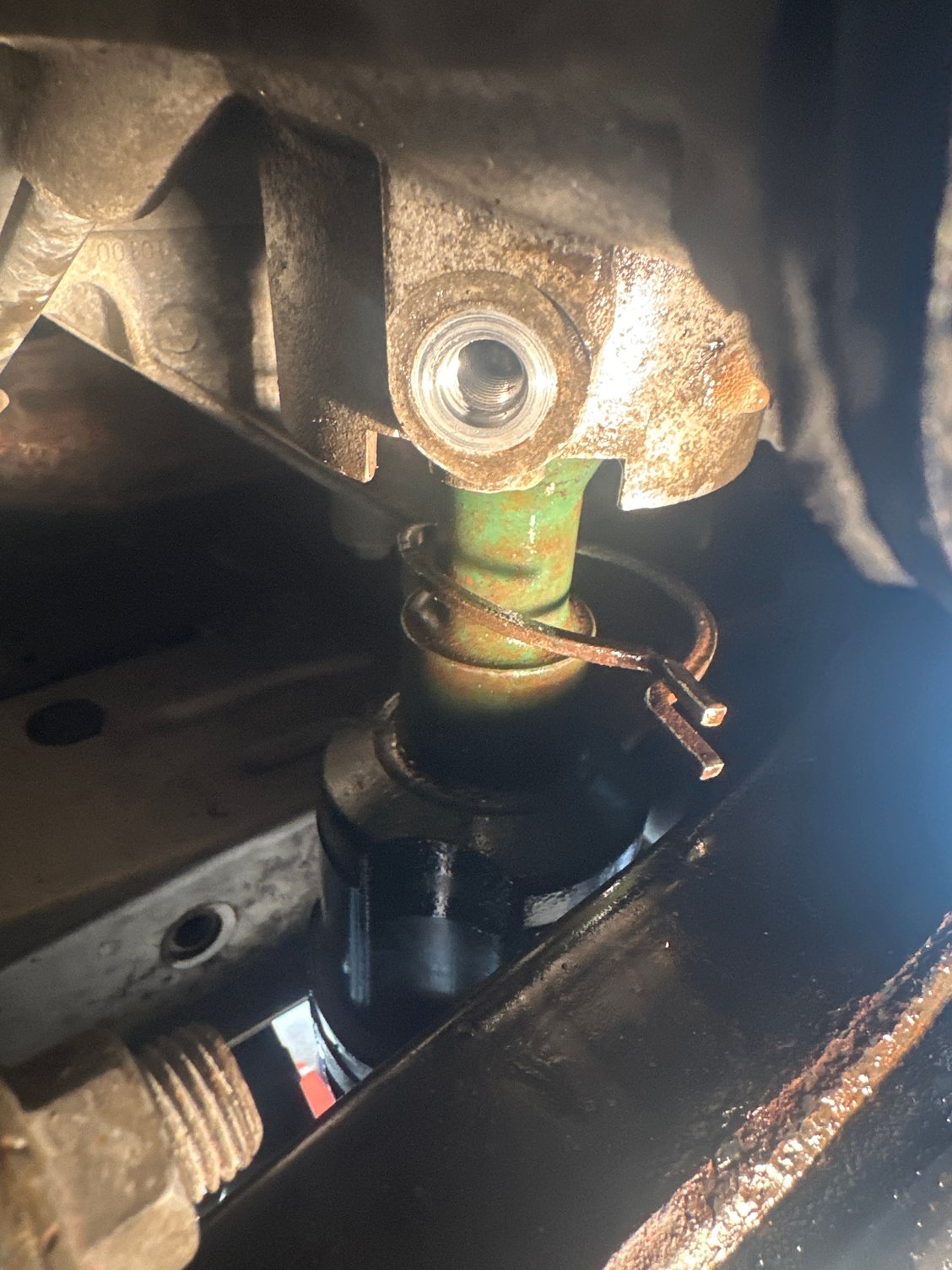

Originally Posted by 2013FSport
Also, there is a small bolt that holds a sleeve in place. The bearing is stuck in that sleeve. The sleeve will come out of the bracket easier than the bearing from the sleeve. Perhaps a propane torch will help? Be careful.
This is where i’m at right now. Where would i torch?
I forgot the bracket is the F'g oil pan! Bummer.
Clean all the grease off everything, wrap that sensor in several layers of foil and evenly heat the whole thing.

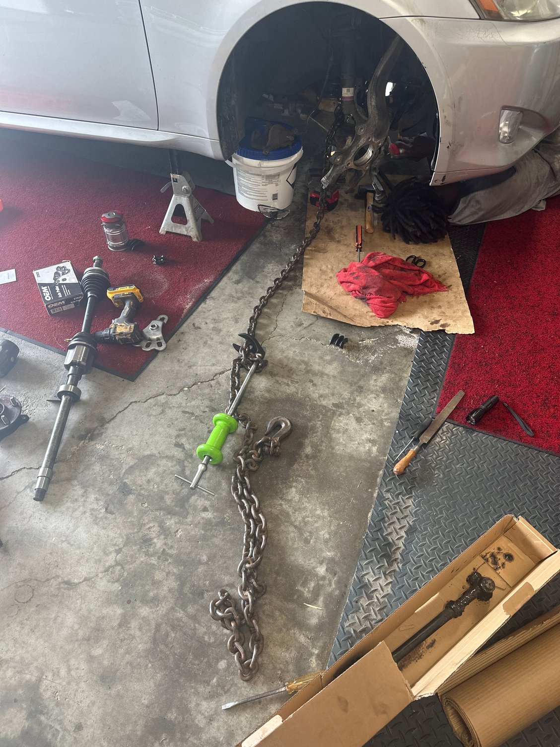

How solid is your slide hammer connection? Is it direct to that shaft or is there rubber, vise grips or something reducing its impact?
Did you just start spraying chemicals on it today?
I think some have heated the shaft, burning out the seal and grease but now you have fire which is not desirable.
I’ve
sprayed a lot fo WD40 on it yesterday and today. I’ve been heating it aswell. We just heated it and my buddy tried prying while i was slide hammer and not a single ****ing budge. I’m loosing my sanity
In the above photos, if you can put a bearing puller against that ridge on the shaft, then place a block of wood up by the bottom of the oil pan, you could possible apply some decent leverage directly to the shaft. And with direct pressure, either slide hammer or direct hammer to bearing puller.
The clamps shown here. Clamp it by that step on the axle.
Just thinking outloud about options if slide hammer doesn't have a direct connection to shaft with step on it.
