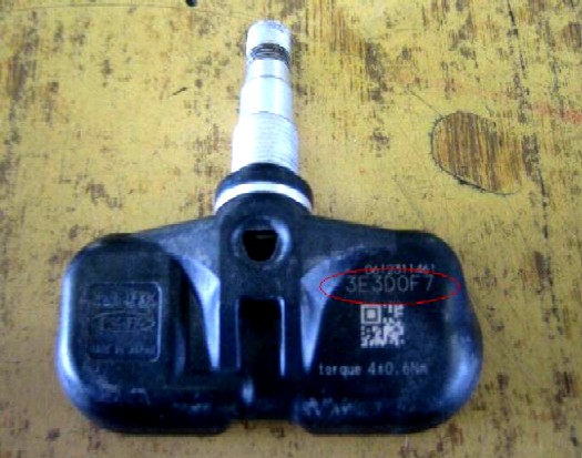

Hi,
I just picked up a set of the tire pressure sensor and would like to share a picture with everyone.
To confirm, right quadrant of the sensor, is this the sensor number that is needed to be programmed into the vehicle?
Thank you!
Thank you!
Yes, before you install them, write down the serial# and location for each sensors on the wheels. And then have them program them at the dealership for a 100 bucks. GL
Hello,
Is the full serial number the 1st and 2nd row?
Also, does it matter if the sensor is mounted front or rear? I am running a non-staggered set.. and would be tough to keep track if i rotate.
TIA!~
TIA!~
^^ what he said.. lol.. Just tell the dealership their non stagger and I think it shouldnt matter as long as they are able to program them.
ok cool thank you!
I have noticed that for the first row of numbers, I have 3 sensors with the same number. The 4th sensor, (upper left) is off by 1 digit...
Should i be concerned?
Thanks again!
Thanks again!
2IS OG
No, it's completely irrelevant. The only numbers that are important are the part numbers (so you know you have the right sensors), and the serial numbers for programming. You also don't need to know which sensor is in which tire.

On the other side, I got:
FCC ID: PAXPMV107J
IC: 3729A-PMV107J
I hope i got the correct part #'s........
It is for a 2007 IS250...

My post from an older thread....
Quote:
But nothing you would want to go out and buy yourself. You would spend lots of money for a one time use.
But as far as the dealerships they use their Lexus / Toyota TIS Techstream Laptop interface..
Which plugs into the OBDII port under the dash..
Maybe try a Toyota dealership.. Just let them know you need to register 4 new sensors as your 2nd set.
or
Try another Lexus Dealership.. Should not take more than 1/2 hour, but they usually like to bill for an hour when it comes to TPMS programming
Usually, they will not register them unless they are installed in a set of wheels with air.
You don't really need other numbers or locations written down..
(but if a sensor is fails, it is good to know what exact wheel location its in)
The system will only take the 7 digit Transmitter ID of the sensor..
See below photo for example.
(Large Font size set of numbers in white, on the right)

There is some other newer expensive technology out there that some wheel shops are buying these days..But nothing you would want to go out and buy yourself. You would spend lots of money for a one time use.
or
Good Luck
Joe Z
