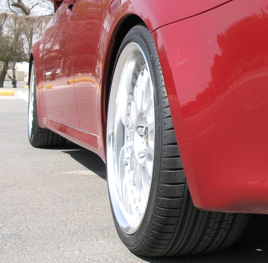

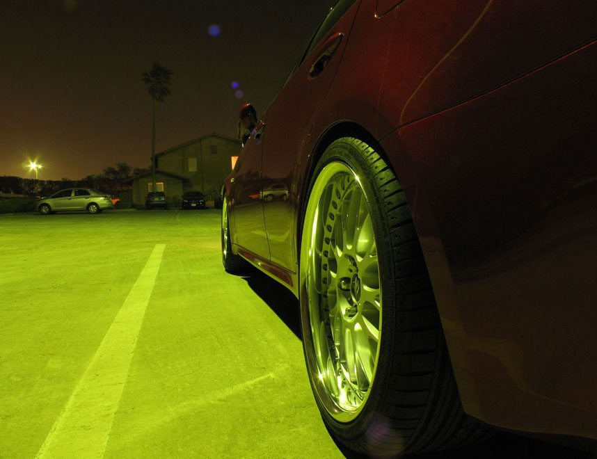

In terms of being flush, they will be very close to mine, same at the front and only 2mm dif at the rear.
Before Spacers:
Your front 9 is tucked in, it will rub... how bad? I can't be sure but it wont be too bad, nothing a heat gun can't fix. I had about a 2mm rub at the driver side only.
If you got a really good offer on them buy them and you can always get spacers, if you are ordering them then get more aggressive ones. I was being conservative because Chicago got nothing on the Saudi ghettos I'll fit my old spacers soon just to see how they'll look like. I'll post pix
After Spacers:
I installed hub-centric spacers on the driver side only (front/rear: 5/15mm). The front is not 100% flush yet but i am still not rubbing. The rear are now effectively +33 rather than +48, I will roll the fender soon.
All what you'll need to make those wheels flush is 10mm (hub-centric) spacers for all 4 wheels and use the heat gun.

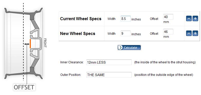

Originally Posted by kattanh3
That calculator doesn't look quite right - the rim is 12.7mm wider and the offset is only 6mm more. So the rim should be centered similar to stock with 6mm less clearance inside and 6.7mm less clearance on the outside (?)
Nope the calc is correct. By increasing the size 0.5" apx 12mm, you added 6mm to both ends, then the 6mm difference in offset shifted the outer 6mm to become another inner 6mm = 12mm on the inners only
