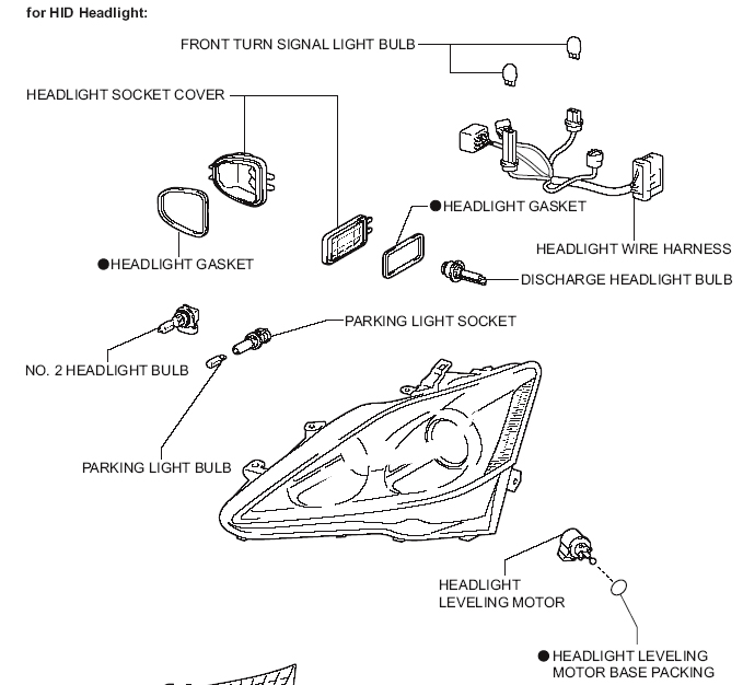

Don't use that diagram - it's wrong.
Originally Posted by javyLSU
I've seen this homemade pic several times, and some of the information on it is wrong. To remedy some of this confusion, here's the diagram from the factory service manual with all the correct nomenclature and functions:

As you can see above, they're 'parking lights,' not 'city lights.'

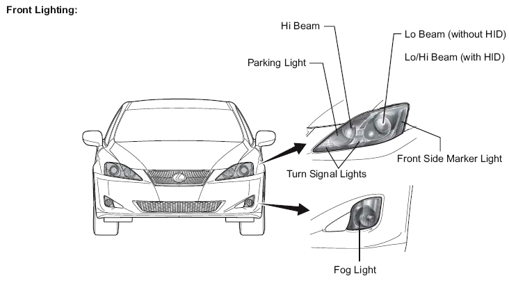

Okay, and since there has been several negative comments about my lighting diagram in a couple of different threads, I have decided to redo it and include the "correct" information on it so here it is (throw away the old one guys):
