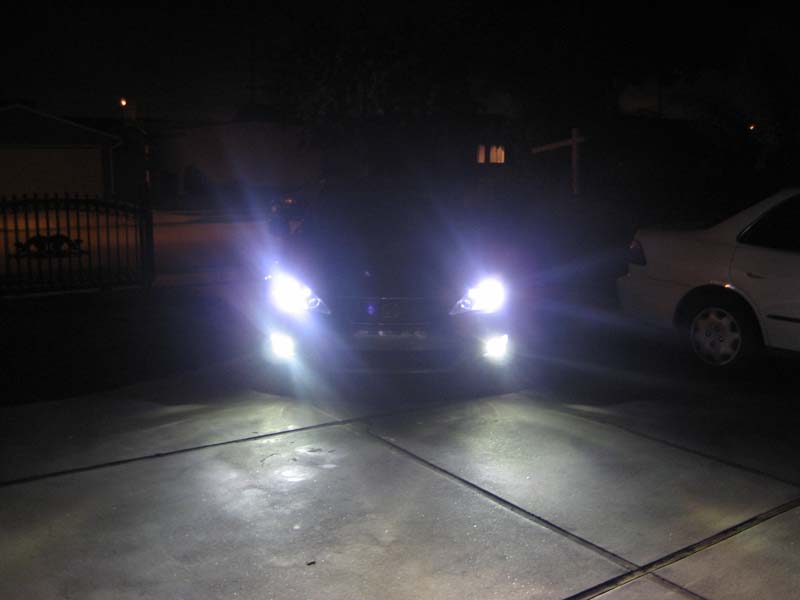

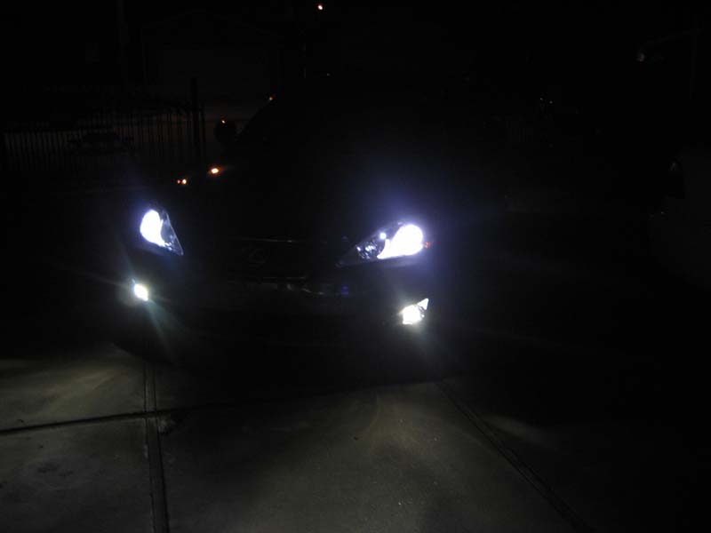

it was hard to get good pictures of it at night but this is the best i could get...
headlights and drls on
headlights, fogs and drls on
headlights are 6000k bulbs.

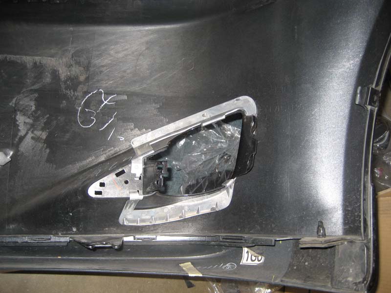

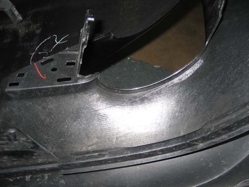

you just need to cut the holes bigger... there is a line on the inside of the bumper that shows what needs to be cut. it comes with a metal template that shows you what needs to be cut as well.
template... the plastic inside the template needs to be cut away.
the line showing you where to cut.
i used a box cutter to slice away the plastic. it wasn't pretty but u can't see it once you put the garnish on the outside.
