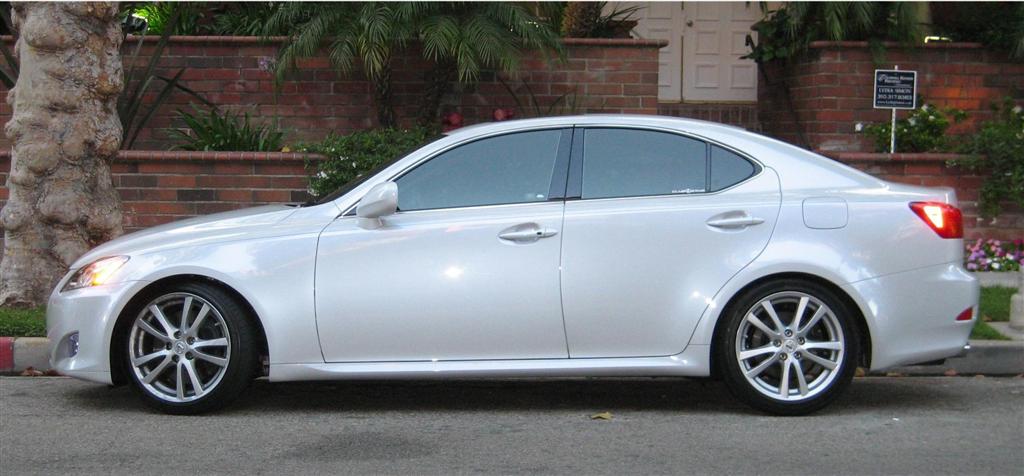

So wait, you're worried about the Eibachs dropping the rear too far, but you're considering slamming your car down on S-Techs? Make up your mind, man!!! j/k... Here's a pic of the Eibach drop if you haven't seen one before - make sure to post pics whichever way you decide to go!
Javier
