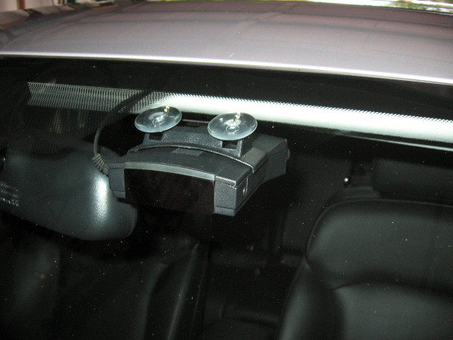

Hardwired through rearview mirror:

Just remove the rear view mirror and tap in the wires, nice and clean. Someone here has the DYI with pics!
Tap the Rear View Mirror Lead? Is it Switched or Constant?
If it is switched, I would say YES.
If it is constant, then your device will be on ALL THE TIME.
So please... Tap a switched (+) signal properly... Do not use those Fuse Box Tap ghetto rigged half *** job technique.
