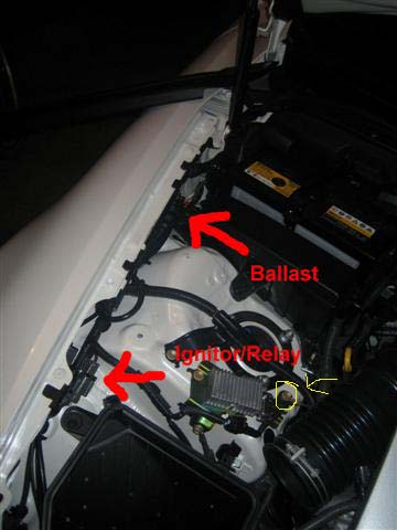

grounding points: passenger side I grounded to a point next to a silver box directly to the right of the strut (which also served as a grounding point with a wire coming from that silver box) driver side I used an identical point that also served as a ground for something else, the point is right directly to the left of the strut
in the pic (thanks for letting me borrow it rdrunner), I highlighted the point on the pass side that I used in yellow...any hypothesis?
